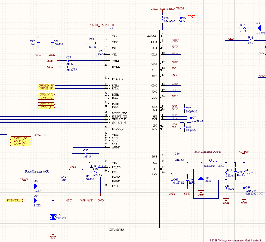

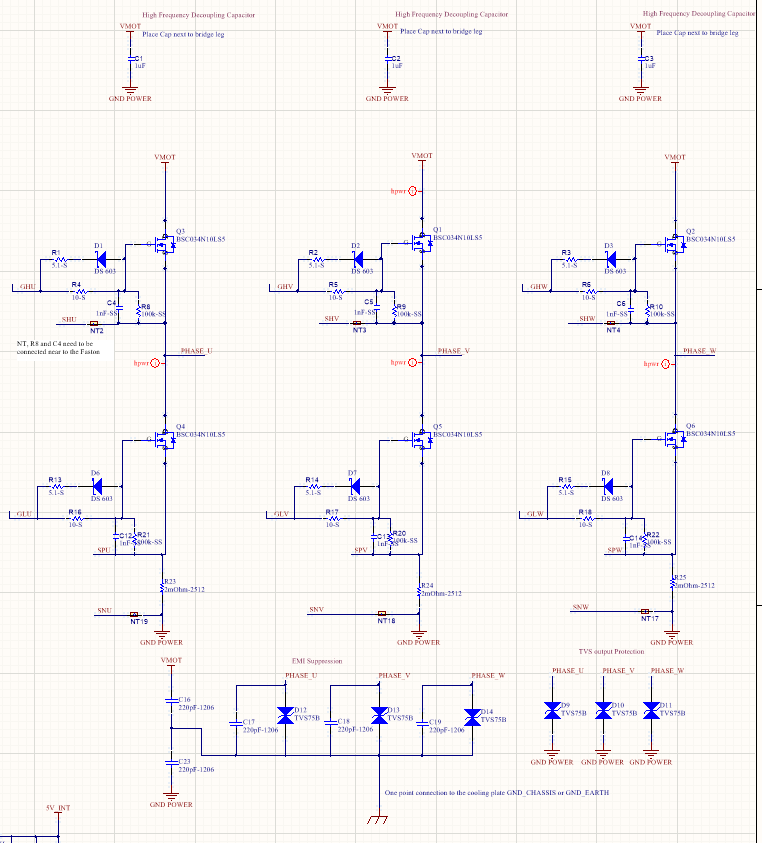

Hi all,
The datasheet of the DRV8353 does not refer to external minimun MCU deadtime.
The IC itself has a sophisticated way to insert the deadtime via tdrive added to the SPI_Config_DeadTime.
My understanding is the the tdrive is adjustable even if you can set its maximum value via SPI.
My question is if you insert an external deadtime to the device, what is going to happen? How the times will be added?
For better performance do we have to avoid the use of external deadtime and let the device decide it ?
