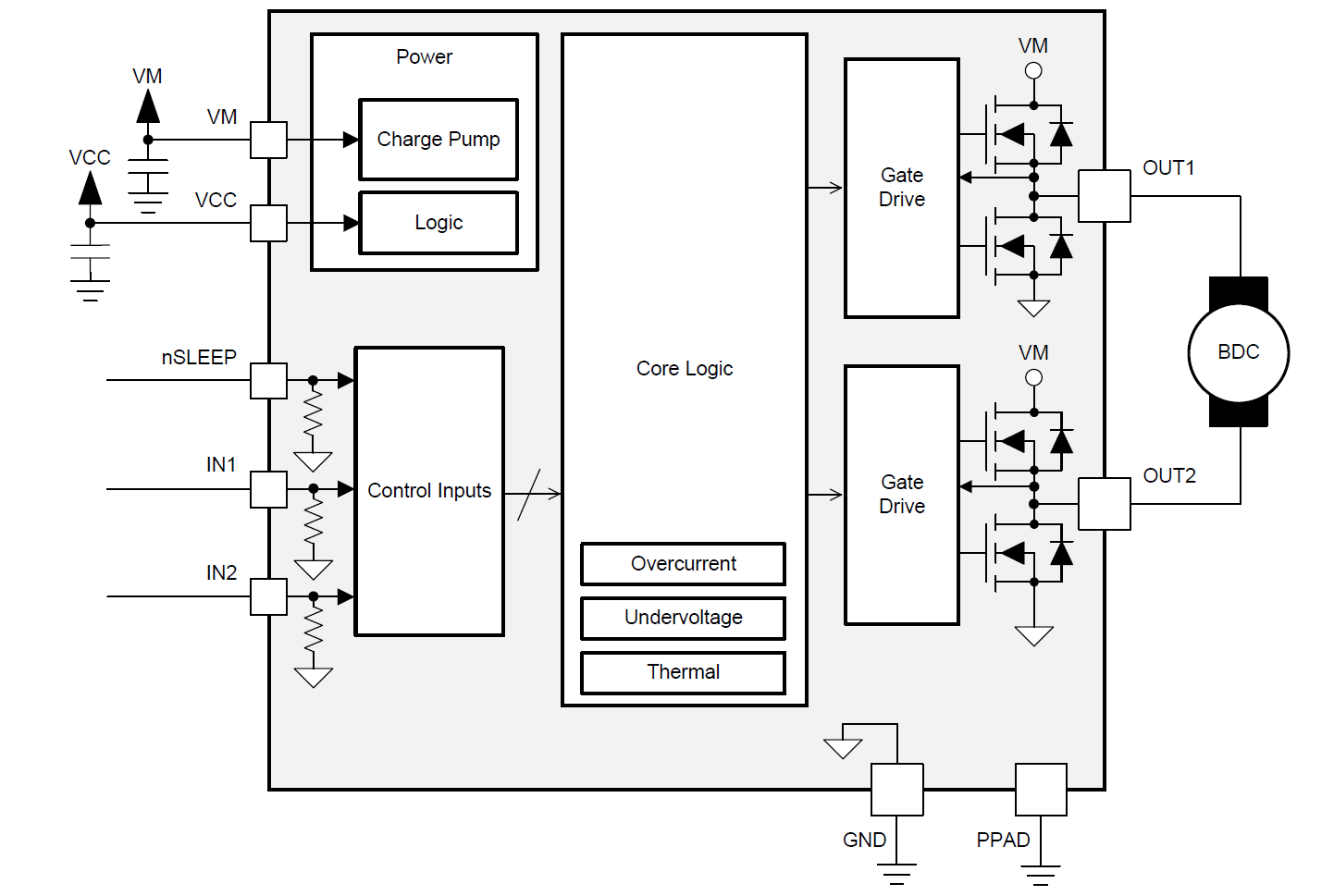

How much is the negative absolute voltage of out pin?
It is not written on the datasheet.
Kuramochi
Kuramochi
Wang-san,
Thank you for your reply.
For our reference, what voltage is FET body diode drop when Iocp ?
Is it about 0.5V,1V or 1.5V?
Kuramochi
Kuramochi,
Use some other datasheet as reference, -0.7V is put in the spec to represent one FET body diode drop. But, if we test the voltage, that body diode drop could be 1V.
