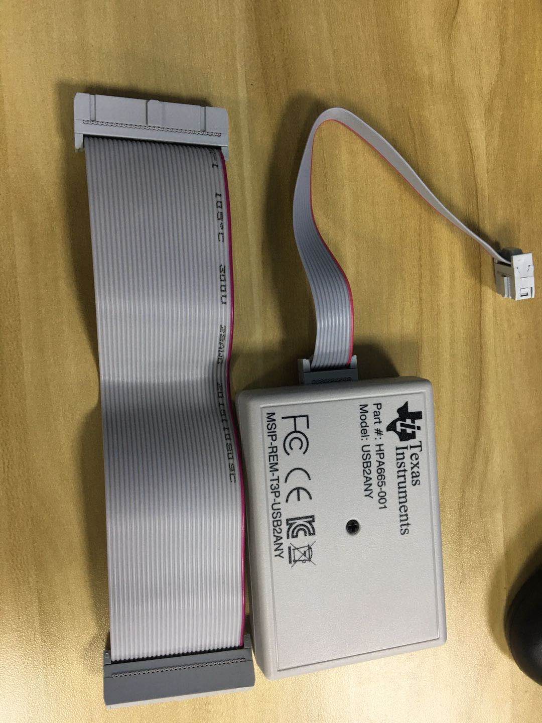

hi sir:
I want to control DRV2605EVM-CT with Haptics Control Console Software.And I have got a USB2ANY,but I do not know which port on DRV2605EVM-CT can be connected.

The USB2ANY tool must be connected to the three I2C pins on the DRV2605EVM-CT. The three pins located above U4.
For details about the USB2ANY I2C pins, you may take a look at page 7 of Haptics Control Console GUI User's Guide:
https://www.ti.com/lit/ug/slou502a/slou502a.pdf#page=7
