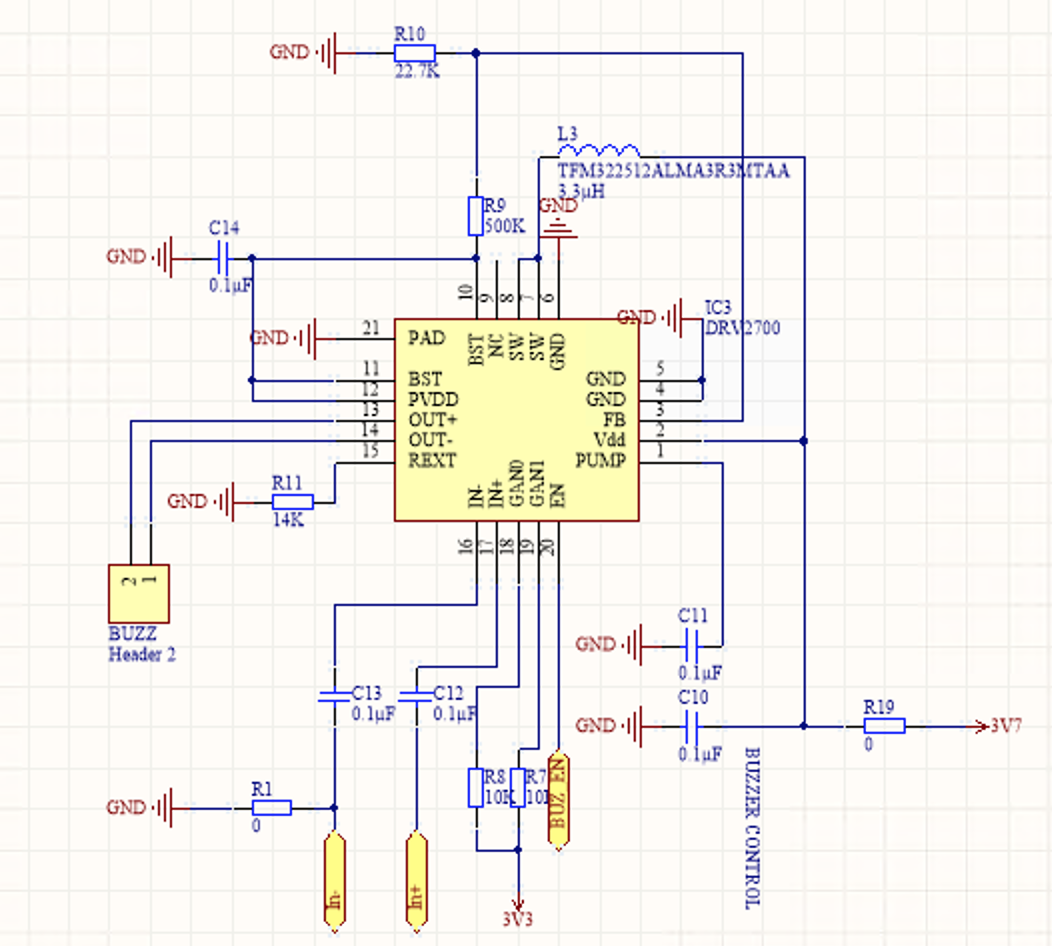

DRV2700: DRV2700 shuts down when input voltage is less than 4.7V
Part Number: DRV2700
Dear TI support team,
I use the DRV2700 to drive the piezo buzzer. I use an inductance of 3.3 uH. GAIN, Enable pins, and IN+ are driven by MCU.
I'm varying VDD and in case it is lower than 4.7, the output seems corrupted (stable level of 1.5|V). Once the voltage on the input exceeds 4.7 there is a correct signal on OUT+ and OUT-. Could you please suggest me anything to decrease this voltage? I need an input voltage of 3.3
