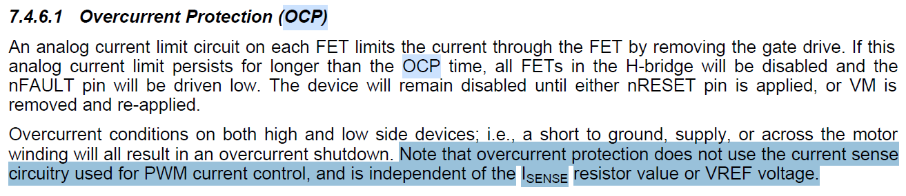

Could you please answer the following questions about nFAULT and OCP of DRV8812?
Question:
Q1. Is it possible to enable the nFAULT pin other than OCP and TSD?
Q2. Why are overcurrents detected at two locations, VM pin side and ISEN pin side?
