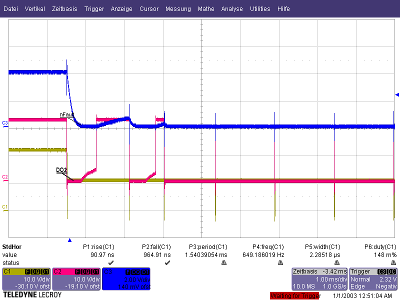

I tried to extend the 1,6 ms tOCP Time by connecting the nFault pin to the enable2 pin.
These both pins are connected directly. To realice the default High level I made a resistor divider with 15K against 24V and 3K3 to GND.
To realice the timing I added two 1µF capacitors parallel to the 3K3.
If i scope the two 24V outputs and the nFault/enable2 pin I´ve get this sketch.
Output 2 drives against an 2*470 Ohm resistor divider at 24V. It looks like that the Output is active as soon as there is any Voltage at the enable2 pin. This differs from the datasheet.
Can somebody explain that?
Kind regards
Thomas

    nFault is directly connected with EN2, so the blue signal represents both.
    DO1 and DO2 arte the both Outputs of the of the DRV8816. DO1 (Output1) is externaly shortet to generate a fault.
    Kind Regards,
    Thomas

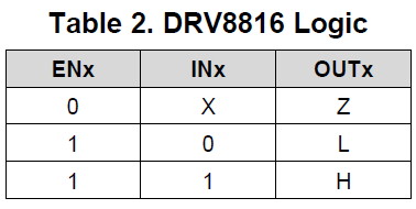

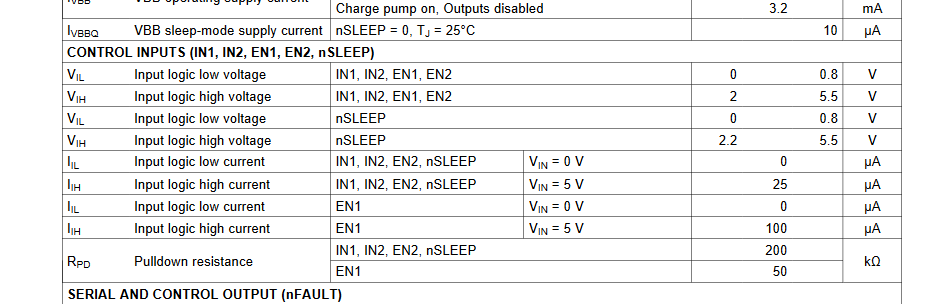

    The logic low level is described for the enables like following:
    In my opinion the outputs must be deactivated (minimum) as long as the voltage at the enable pin is below 0,8V.
    But the Output becomes aktiv as soon as the Fault/Enable 2 leaves the 0V line.
    Kind regards
    Thomas

    I made a little mistake, for a better layout I switched the both Signales IN1&OUT1 with IN2 & OUT2.
    But at customer side of view OUT2 is DO1 and OUT1 is DO2 (osci picture above).
    So nFault I disable DO1 through the shortcut.
    Now my picture make more sense for me.

  • Thomas,
    Great! You found the root cause.
    I would think tocp timer should be same for all the channels. But, the each input channel's logic high threshold could be have some tolerance.

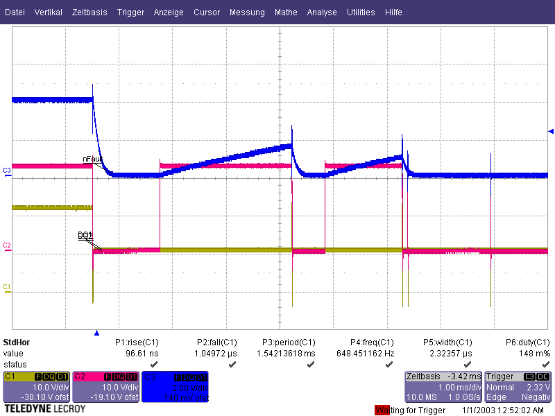

  • Hi
    The high threshold couldn´t be the reason for the phases between the enable time for both channels.
    I made several pictures. In all cases I shortcut the DO2 to GND.
     You You can see that the reactivation of DO1 is always at different levels of nFault(= EN2).
    This let me asume there a two internel free running counters inside the DRV8816 to manage the tOCP Time for each Output.
    So I think the Enable should be at high Level AND the timer counted down the 1,6 ms to reactivate the Output. Is this right?
    Kind regards
    Thomas

  • Hi
    Do1 is driving against an resitor devider (2*470 Ohm).
    But additionaly to the protection the DRV8816 has we also has an PTC in the supply voltage.
    I think the curves in picture 1 came from this PTC.
    DO2 is directly enabled if nFault isn´t pulled down any longer.
    Kind regards
