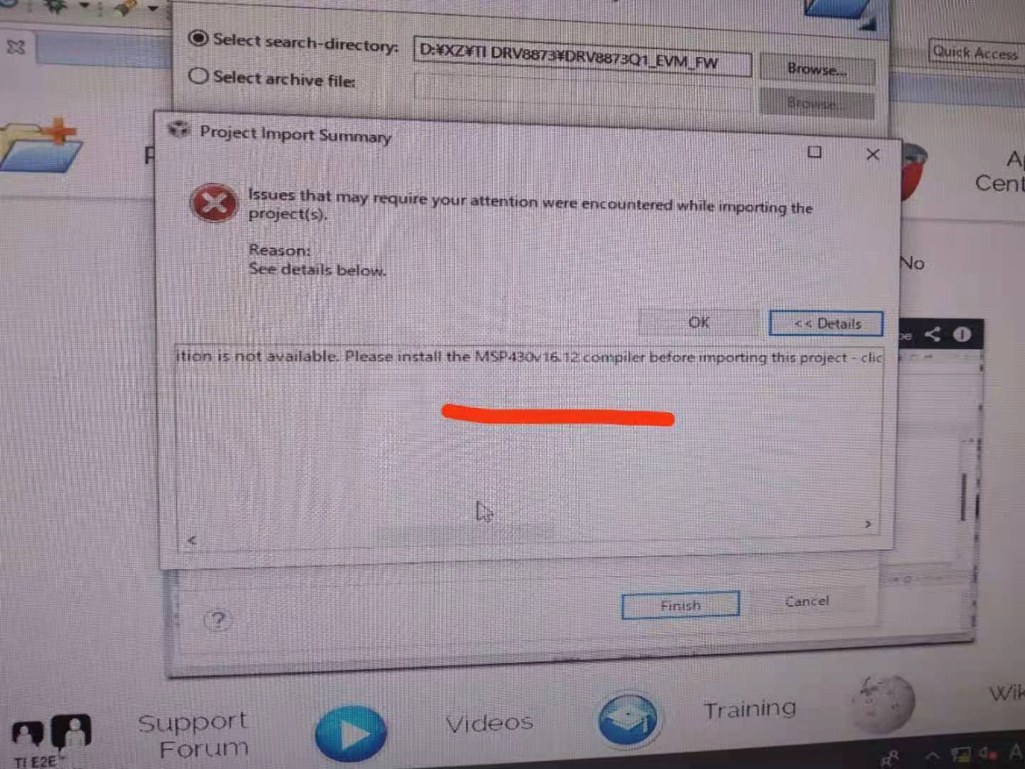

My customer wants to use DRV8873EVM to modify the code. We have downloaded the EVM software package on the official website, but did not find the compiler. Can you provide me with the MPS430 compiler download address?

Hi Jensen,
To get the MSP430 compiler, re-run the CCS installer and select the MSP430 MCUs option. Let us know if you have any trouble with this.
