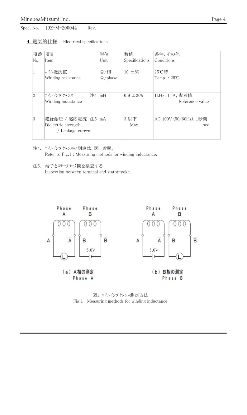

Hi Team,
The customer is going to use our DRV8899. Please kindly help to review the motor spec which they are going to pair with DRV8899. Thank you.
Mike
