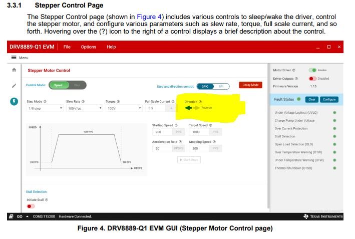

HI Ryan,
We tried the GUI again to make the motor move, but the motor can only rotate in a single direction.
We choose another direction and it cannot be locked. How can I set the GUI to make it rotate forward and backward, thanks
For GUI 1.1.1 or later version, please try changing the baud rate to 115200. I believe it will connect then. This is mentioned in the user guide I linked above.
