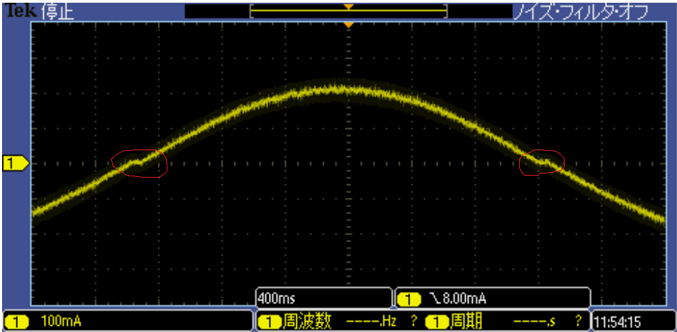

My customer evaluates DRV8428 EVM. Unfortunately, the motor current wave form doesn't be pure sin wave as below:
It looks like the flat is shown at zero cross point.

  • Shunsuke,
    With 1/256 uStep setting and 0.6V VREF (0.2A full scale current), each step current resolution is less than 1mA.
    1. Please check zero crossing region, does the output have the PWM signal? Does the internal FETs switch?
    2. Right now, Decay/TOFF is low. Can we change the Decay mode setting to Dynamic decay or Mixed decay?
