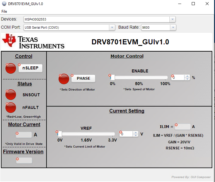

Hallo TI support,
i can not get your DRV7801EVM running.
GUI & USB Drivers are installed. But I can not get further than 2.3 Step 3 where the GUI should connenct. (DRV8701 Evaluation Module User's Guide)
What can I do?

Hi Micha,
I think you are experience the same issue as the person who posted this thread (https://e2e.ti.com/support/motor-drivers/f/38/t/972425). Please follow the instructions listed in that post.
The problem you are having is related to the GUI composer runtime. Once the appropriate runtime version is installed, you should be able to connect to the GUI.
Micha,
Yes. Please try it on a different computer. Make sure the GUI and composer runtime are not installed in that computer.
Hi Micha,
I'm sorry to hear that it did not work. I will continue to investigate this issue and how to resolve. Please give me a day or two to investigate and I'll respond by 2/2 or earlier.
Hi Micha,
Unfortunately, I was not able to finish investigating this issue on my end. Please allow me another day to find a solution to your issue.
By the way, you mention that you injected the EN/PH signals from an external controller. Is this solution working for you?
Hi Micha,
Understood.
Can you try uninstalling the GUI and the composer runtime you have installed on your computer and try the following steps:
Let me know if this works.
