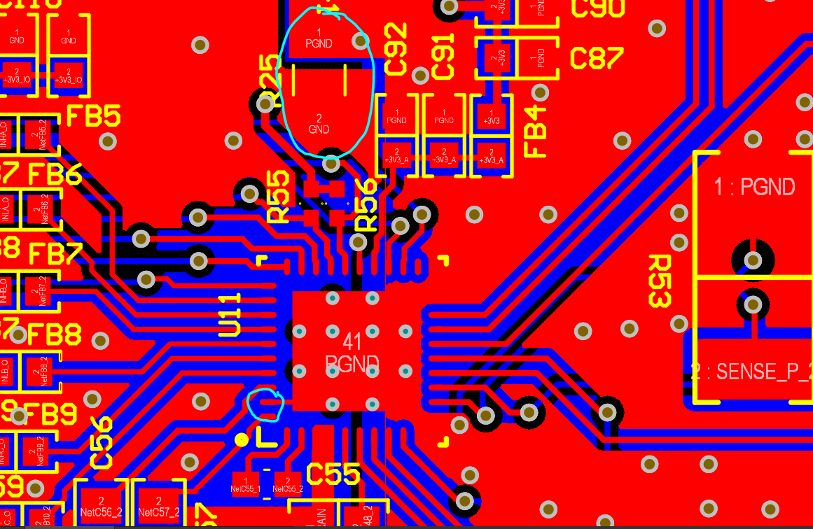

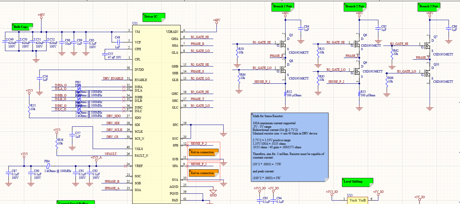

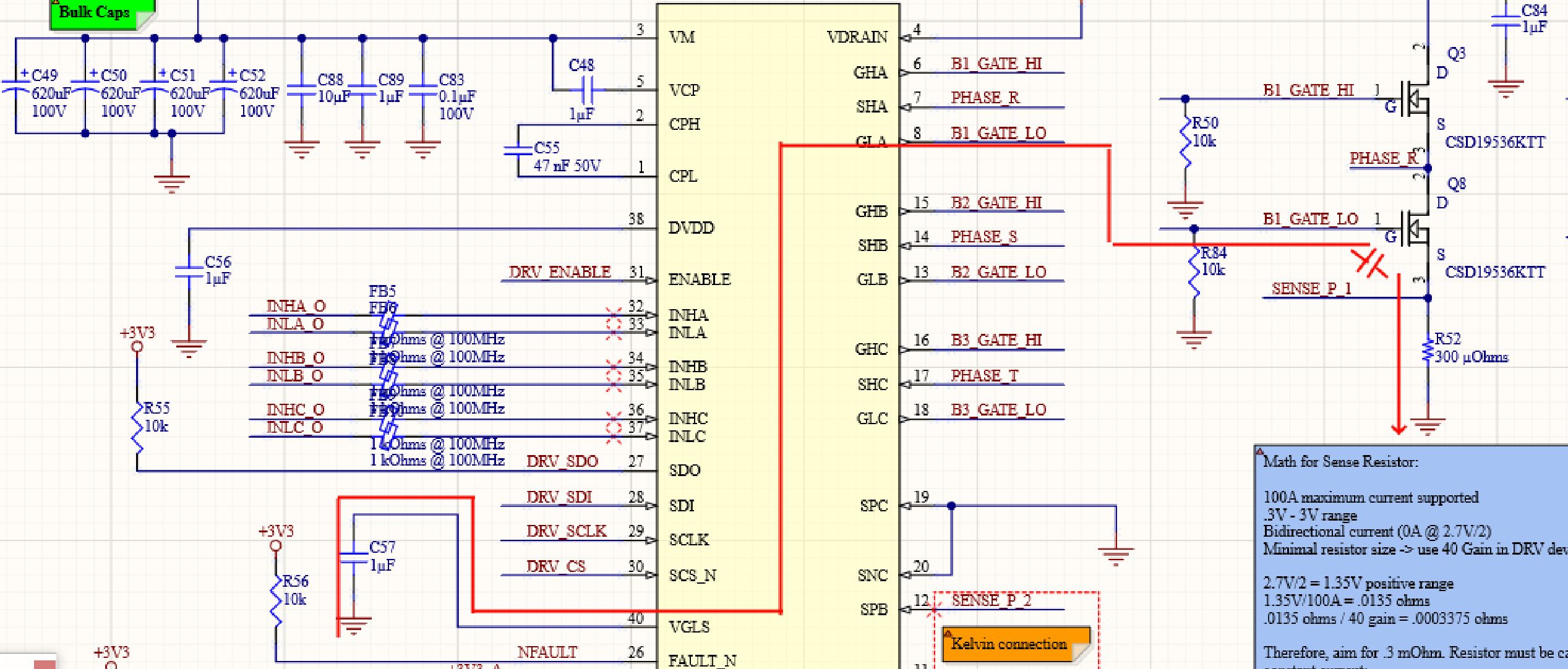

I'm attempting to drive a BLDC with CSD19536KTT FETs. We've got the system driving, technically, but the waveform looks strange, and it's having current spikes that trip overcurrent when we get to about 15A motor current. They're quick, though -- we screened out some of them with deglitch, but with our deglitch set to its highest setting in the DRV part, we're still having the issue. (Before, at default, it was around 6-8A that we'd see these. Now, it's at about 12-15A.)

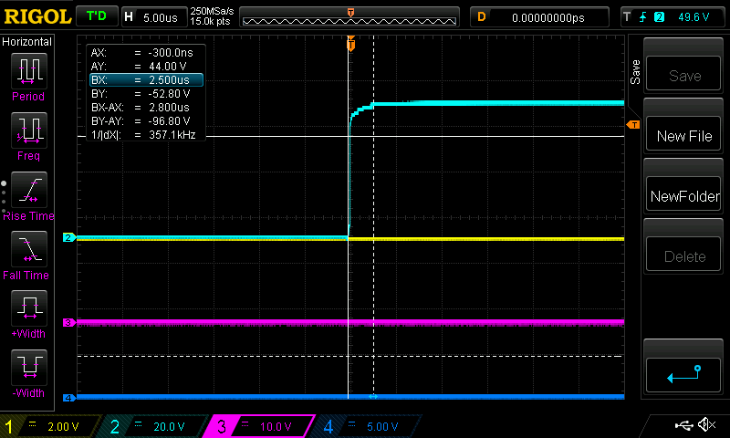

The waveform looks like this:
The pink is the low side gate on one of the phases. All of them look like this. Note the angular shape. It jumps up, then coasts upward slowly, but only on the turnon. Turnoff is nice and smooth. We're at 300mA gate drive current; given that the Qdg of the FETs is 17nC, that should be enough, right? We don't have any gate resistors.
