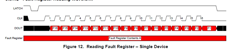

1. The timing of reading fault register:
1)The timing diagram of the data manual is: at the beginning, LATCH is high -> CLK is pulled low -> LATCH is pulled low -> LATCH is high -> CLK is high, then at CLK falling edge exchange data, then read data, and finally CLK is low -> LATCH is low. The fault register data we read according to this sequence is incorrect, similar to a left shift.

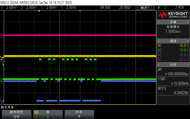

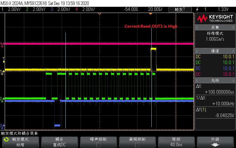

2. Assuming that the evaluation board example is correct, we continue to test and find that the fault register is cleared after resetting, and then the fault register data read for the first time also has a left shift phenomenon, and the second time and later data read is correct.
The following is the detailed test process:
1). Test conditions: OUT2 remains open.
2). Test method: first reset the fault register, delay 10ms, and then read the fault register twice continuously, and repeat the operation in this way.
3). Test phenomenon: After each reset of the fault register, the data of the fault register read for the first time is shifted, and the data read for the second time is correct.

The following is the first reading of the wrong data waveform:
Yellow color: DOUT
Green color: CLK
Blue color: LATCH
Red color: DIN
The following is the correct data waveform read for the second time:
