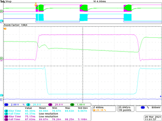

  • Actually, to me, the waveforms look pretty stinking great.  Attached are some scope shots: Ch1 = SHA, Ch2 = GHA, Ch3 = VDRAIN, Ch4 = VCP.  Idrive set to 100 mA.  Vdrain = 50V.  I have captured the 4 signals at various places during the PWM ramp up and ramp down intervals.  In the last set of shots, I turned off the zoom mode and tried to get maximum time resolution on my scope.  I don't see any issues.  Even the ground leads on my scope probes don't seem to impact things.

  • These waveforms do look good, but I am still analyzing them. Is there any way to increase the resolution (samples per second), especially on a capture like 01012 & 01009? Alternatively, It would be good to zoom way in on one rising edge and one falling edge. At your current configuration, you are only getting 40ns per point (I think).

  • Well, based on our call this morning I did some more tests and damaged another IC.  I discovered that with Vdrain at about 55V, and with the circuit under load, the boost converter was tripping.  I placed a 2nd 0.01 ohm resistor on top of the current sense resistor to achieve an effective value of 5 milliohms.  After doing this, I turned on the circuit and slowly increased the Vdrain.  I heard a pop at Vdrain = 65V, the DRV was damaged, so I shut things down.  I was able to capture the signals requested by Matt: ch1 = nFAULT, ch2 = GHA, ch3 = SHA, ch4 = VCP.  I measured the following resistances on the damaged board:

    The scope shot is attached.  It was triggered on nFAULT, but the nFAULT signal looks pretty crazy, going much higher in voltage than usual.

  • It looks like things went south at the end of a narrow negative pulse that occurred towards the end of the PWM ramp interval.  This is when the current in the H-bridge is the highest as the load capacitor is reversing polarity.  The pulse gets about 50% back up and then, POOF.  nFAULT goes low about 4us later.

    First impressions look like the damage might have actually occurred on the rising edge of the new PWM pulse. I'm going to give a play by play:
    • So the gate and phase drop down with the falling edge of the PWM and we see that negative spike.
      • It doesn't look particularly bigger than the rest of the ones that come before (unless the resolution didn't pick it up), so I'm not sure it was damaged there.
    • Then, we have the dead time,
      • Which does look like it gets smaller in comparison to the other PWMs. The previous one looks just as long so I don't think there's problems there or first glance but I'll let it open to the possibility that it was damaged here
    • Only during that rising gate edge do we see the spike on VCP and VCP starts to descend.
    • Looks like the second hump of the rising edge lines up with nFAULT glitching a bit, so we're probably seeing the fallout of the damage here.
    • The nFAULT goes low around 4us after rising edge, which is what we expect from on the GDF (which should trigger) and OCP deglitch.
    • Fault releases later.
      • Note, that CBC or cycle by cycle operation means the device will be cleared by another input PWM (which, correct me if I'm wrong) will not stop after nFAULT flips, and the PWMs will continue to go. So this behavior probably "expected"
    • Crazy stuff happens after this and it looks like the rails are all collapsed by then so we don't have much of a clue what's happening there.
    Still boils down to "Why does VCP start to pull so much current that it starts to dip?". The shorts agree with this speculation but still, I can't answer why the shorts happen in the first place!
    So, now what? Well, I think we start trying to correct the things that look suspicious, like you said, the SHA thickness and adding gate resistors, at see if we can prevent the damage.
