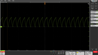

Using DRV8876 motor driver to drive my Brushed DC motor either in PWM mode at 20 KHz or 40 KHz or in PH/EN mode with slow decay. The coil current falls to zero for every PWM OFF cycle immediately in PWM mode, Current oscillates between negative peak and positive peak in PH/EN mode with slow decay.
This causes huge current ripple and eventually thermal rise due to eddy current loses in my core less brushed DC motor. Is this the expected behaviour of the driver, If not suggest me some changes to get rid of this.
