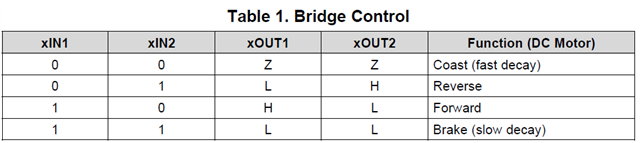

          We are using DRV8848 and wants to operate 4 relays individually from each channel, So my question is can we operate 4 relays using independent 4 inputs of DRV8848.
        For reference please find the attached image.
