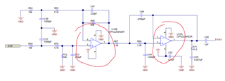

Dear all,
I ordered two BOOSTXL-POSMGR boards for a project my students.
We found the resolver channel does not function as expected. The 15 V power supply is shorted immediately after power on.
After some debugging it turns out the U12 chip is not wired correctly (see page 3 of the schematics BOOSTXL-POSMGR_Sch.pdf).
Pin 4 should be the GND while Pin 8 should be the 15 V power supply. It's wired the other way around in board.
Have any of you encountered the same issue?
