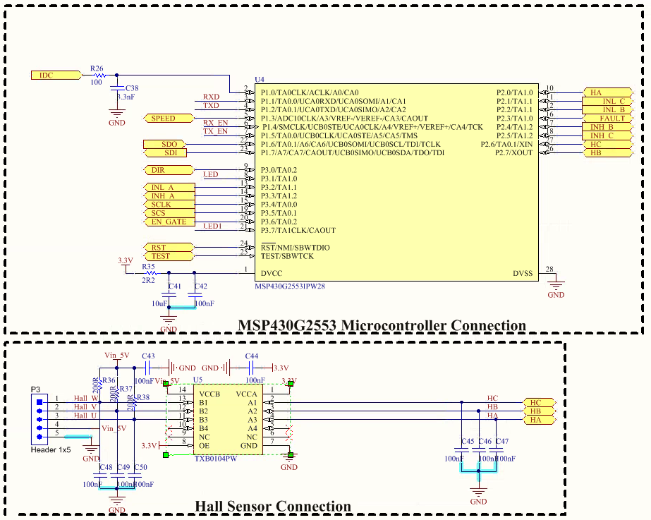

Hello sir,
I have used DRV8305 and an MSP430G2553 controller to drive BLDC.
It runs almost perfectly but at some point of time BLDC motor internally make a sound for a second and that time waveform of Phase of U, V and W also get disturbed. This process is repeated but that is not at regular interval.
In my circuit, I have convert BLDC's hall sensor's 5V signal to 3.3V by using TXB0104PW. This is the image of that hall sensor circuit.
Below is code which I have taken from reference code for the one of TI reference design.

So please help me for this. You can point out a error in code also.
Thank you.
