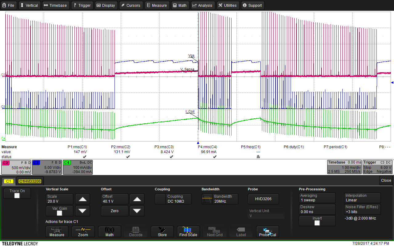

  • Hi James,
    I get back to work on the DRV110 circuits now.
    With our own designed PCB, I get the following waveform:
    Zoomed-in:
    During in the time that I_Coil is decreasing, I observed multiple spikes on the waveform. Is this normal?
    Also, it seems like the lower side of the hysteresis comparative is triggered at different level every time I_Coil decreased to its lowest value. Can you explain why is this happening?
    Thanks for your help!
    Ji
  • Hello Ji,
    I believe the voltage spikes on the sense pin are causing this behavior. The datasheet recommends putting a filter between the SENSE pin and sense resistor. I believe the DRV110EVM implements this filter too, if you want an example. Do you have a filter on your SENSE pin?

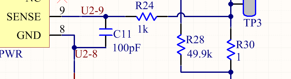

  • Hi James,
    I have a RC filter on the sense Pin as datasheet suggested:
    I used a 1k Ohm and 100pF RC initially, and then changed to 10k and 100pF. The waveform I posted earlier is captured under the second setting.
    Do you recommand to use a larger RC filter? The PWM frequency is set at 20kHz for now.

  • Hello Ji,
    I think you should try a larger filter. I think I saw a problem similar to this a year ago. I believe we recommended 1 kOhm resistor and a 2.2 nF or 220 nF capacitor.

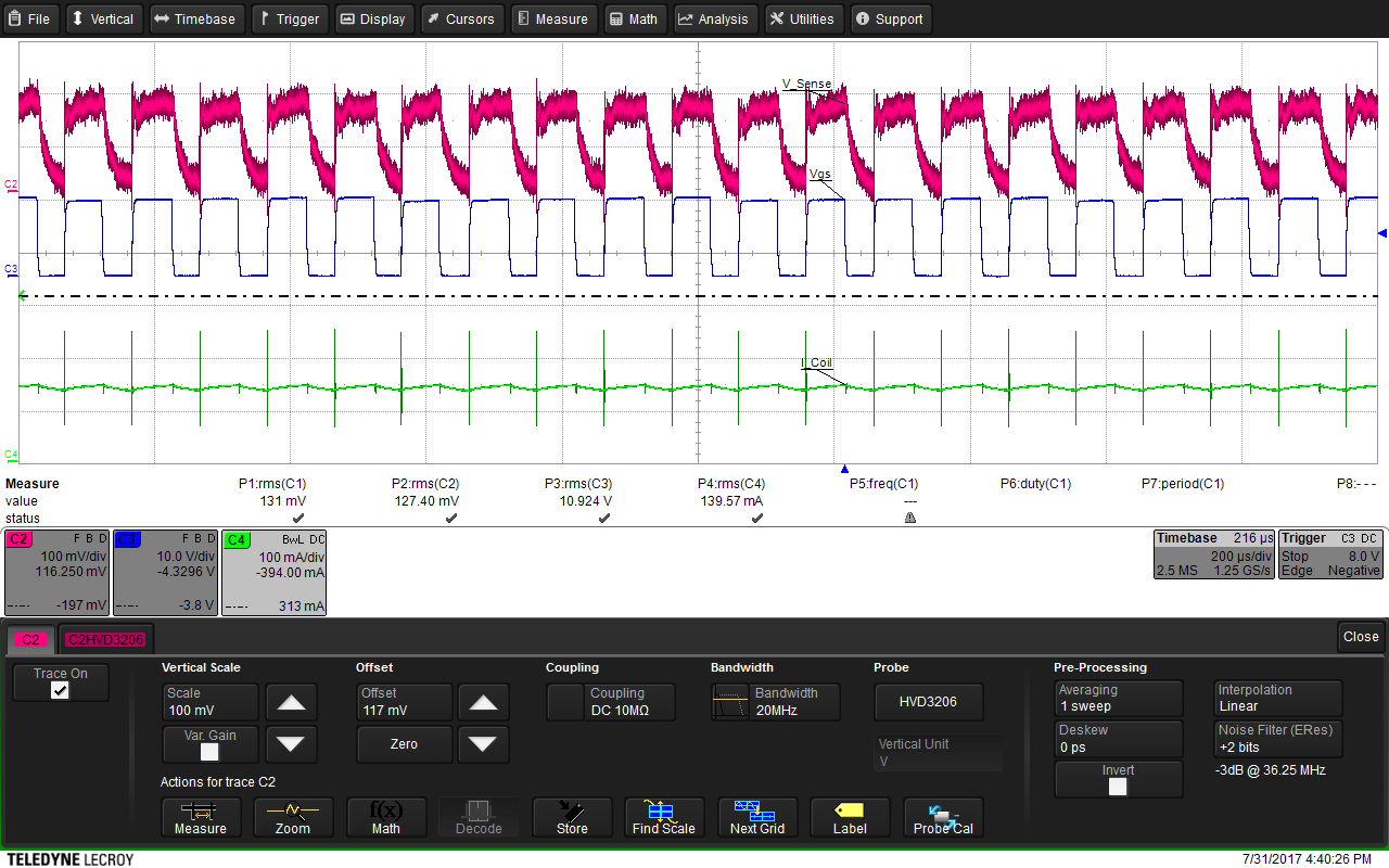

    In the waveform you sent me last week, is the SENSE voltage trace measuring the SENSE pin or the sense resistor?
  • Hi James,
    Thanks for your advice, I'll try the new filter setting in a moment.
    The V_Sense is measuring the voltage on the sense resistor, I will try to get a measurement at the SENSE pin this time.
    Ji
  • Hi James,
    By changing the RC filter and measure voltage on the SENSE pin, I get much cleaner V_sense now.
    The ripple current on the inductor is still much larger than what I measured using the DRV110EVM with the exactly same relay. It looks like the internal comparator's threshold is keeping changing within some boundary. Is this expected?
    Ji

  • Hi James,
    I increased the RC filter value again to R = 1k, C = 10nF. And now the waveform looks normal now.
    Thanks very much for your help!
