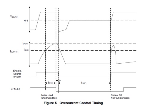

    The device is designed to protect itself by limiting the current in the event of a short circuit, and allow the heat inside the device to dissipate from the short circuit event before retrying. nFAULT is asserted to notify the system of a fault.

    (2) If there was no Microcontroller that checks the nFAULT pin and there was short circuit at the motor, I know the driver will switch OFF the outputs if the current if more than I(PEAK) and wait for a time t(OCP) and then retry again. If this cycle continues indefinitely, what will happen to the driver's lifetime?
    • The driver’s lifetime will be impacted.
