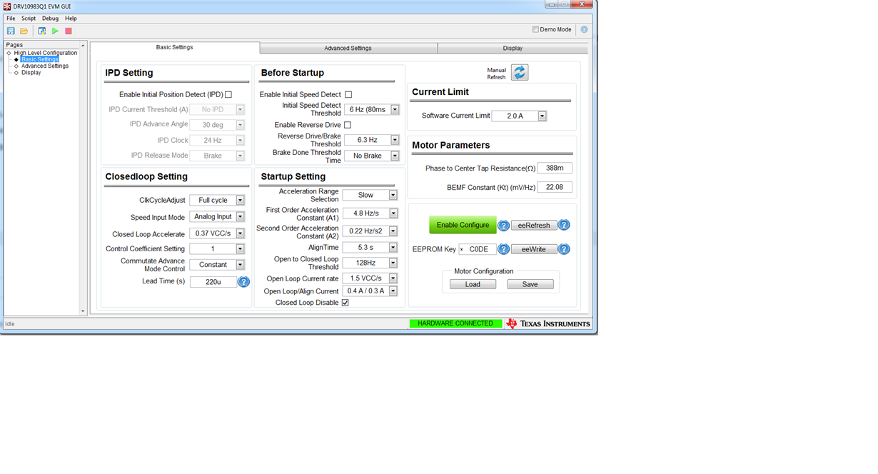

Follow by the turning guide "SLVUAV9–June 2017". I filled out the parameters: Resistance = 0.388 Ohm and Kt = 22.08 mV/Hz. FG cycle = FG/4 (8 poles); slew rate = 120V/us; driver dead time = 440 ns; double the output PWM frequency is checked; open to close loop threadhold = 128 Hz

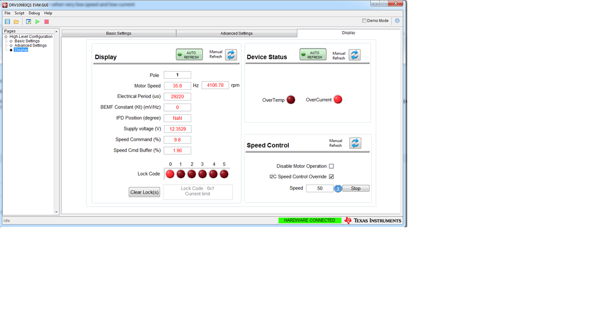

When I set the motor speed to 50Hz, the motor spinning and slowly speed up. But when reach to 35.8 Hz, the motor suddenly stop and start ramp again. Always the same phenomenon.
The lock code show 0x1 : current limit. The over current light is turned on.
When motor stop, the current measured from power supply is 180 mA, so small with the limit current 2A of the Driver.

  • Hey Bui,
    1) I am assuming your current limit is happening in open loop because the fault happens at 35.8Hz, while your open to closed loop threshold speed is 128Hz. It might happen because the motor can't spin as fast as 35.8Hz at open loop. Lower the open to closed loop threshold to something like 25Hz.

  • Seeing the shape of the current on the oscilloscope often tells you how well you are spinning the motor. However, if you want to improve performance of the motor without the current, there are a few things you can do:
    1) Increase Vcc. Vcc should be limited by the motor rating and the DRV10983-q1 absolute max Vcc of 28V. I see from your GUI scope you are only using 12V Vcc.
    2) In the "speed" input box in the display tab, set the max speed value of 511 to go max speed. In the device, the speed cmd set is out of 511, so if you set it to 511, you will get 100% duty cycle.
    3) Make sure your current isn;t being limited by "software current limit" in the GUI. If the "Speed Cmd Buffer %" in the GUI display tab doesn't match "Speed Cmd %", then there is something wrong.

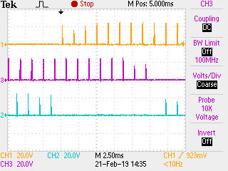

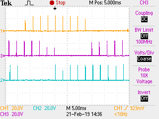

    The following picture is voltage of phase U, V, W compare with GND
  • 1) • Dead time should be at least 440 ns. Putting it lower to 1ns may cause fet shorting and thus cause the overcurrent fault to happen.
    2) • Ringing is coming from spinning the motor in open loop. Once you go to closed loop, it shouldn’t ring.
    3) Lets first focus on getting to closed loop without any issues. Lets set all the accelerations to conservative parameters.
    I have attached a config file to load through the gui "Load" button". The settings are below.Please try this to see if you are able to reach closed loop. Also make sure your phase to cetner tap resistance and bemf constant are entered correctly.
