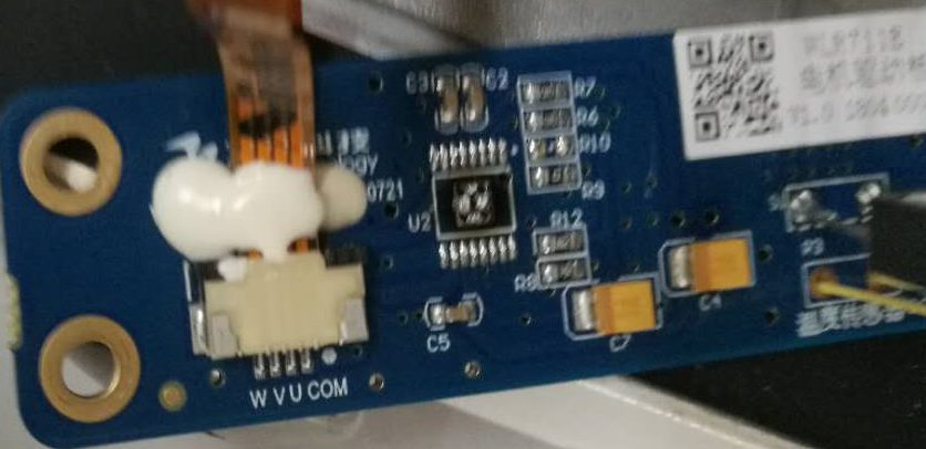

When we use the DRV11873, there are about 5 or so, and the chip is damaged. The specific situation is:

    In the original design, the current limiting resistor was 3.3k, but at the time there was a chip damage, thinking that the current was too large, so the current limiting resistor was replaced by 3.9k. After replacing the resistor, it is easier to reverse. However, it is not the external force or the control reversal, but the motor automatically rotates in the opposite direction, and at this time, the maximum motor speed can only reach 200 rpm!
    At present, I think it should be some kind of error when starting up, such as starting current is too large, but not sure, now it will reverse for up to 10 seconds in normal use, the program will shut down the motor;
    When the reversal occurs, the chip is a little hot, but it runs for several hours at 80 high temperatures, and it is not damaged (not to rule out individual differences, after all, I only tested a few, and the site only damaged a few)!
    A total of one or two hundred units, two damages occurred, and the inside of the sealed case is the case that the pad is burnt out.
    U2 is 11873, the heat sink pads on the pcb are burned out, and the above several vias are broken.

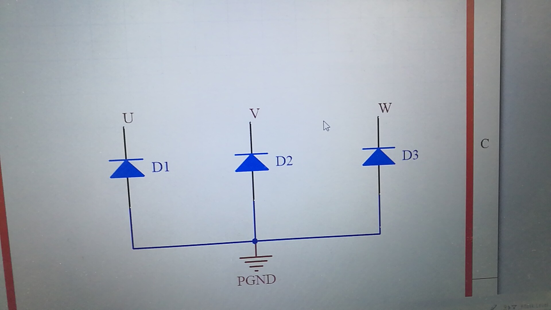

  • I measured the power supply, we are 12V power supply, is surge and burr, etc., not more than 14v.
    In addition, last Friday, I paralleled the Schottky tubes on the UVW and tested them for about 10 hours. So far, they have not been damaged.
  • Hey elsa,
    1) shottkey diodes on the motor phases fixing the issue might indicate the damage is coming from voltage surge from the motor through the motor phase pins. You can learn more about this from this datasheet ( www.ti.com/.../drv10987.pdf ) 8.4.9 Anti-Voltage Surge Function
    2) When you did your on/off test, was a motor connected or disconnected? If it was disconnected, then that means that the problem is independent of the algorithm spinning the motor as well as independent of the motor.
    Hopefully the schottkey diodes fix your issue.
