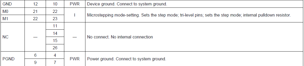

I can see in the DRV8886 datasheet two grounds (GND and PGND). As far as I can see PGND is the lower voltage of the H-Bridge but I still have the following doubts:
- Could I connect GND and PGND to separate grounds in my board? (grounds in my board are connected in only one point) I mean, Are GND and PGND isolated inside the driver?
-Which signals are referenced to each ground? (AVDD, DVDD, step, etc...)
Measuring the resistance between GND and PGND I can measure a DC resistance of 628 Ohms aprox., and that lead me to think that a kind of isolation exists between those pins.
Thanks in advance.
J.R.
    From the pin function table, you can see GND is the device ground. So, all AVDD, DVDD, Srep, etc... are reference to it.
    PGND is the power ground. A high current path can go through it.
    Both GND and PGND are connected to system ground. We don't want to make the system ground too far away from motor drive circuit to avoid a big voltage difference between GND and PGND.

    Thus my question is about the construction of the DRV8886 and to know is the two device gounds are internally connected or isolated in order to avoid the previous problems.
    Thanks again
    J.R.
  • J.R,
    As your measurement result, the two DRV8886 ground are not short together directly. It could have a diode between them. So, please don't have two ground voltage difference higher than a diode.
