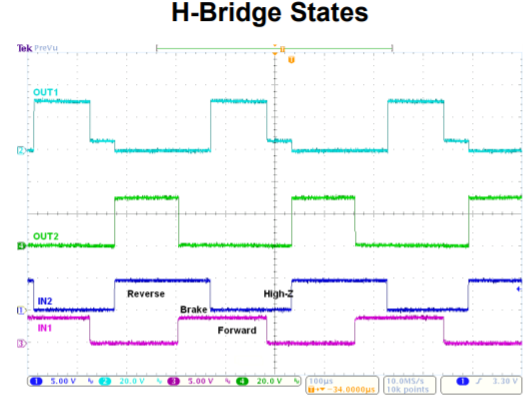

In the datasheet of DRV8872, there is a picture in first page, shown below. Can you help to explain why the OUT1 and OUT2 peform like this in HIGH-Z period?

    The picture on the first page shows OUT1 switching from high to high-z while the outputs are unloaded. During this time, the output can have some small leakage causing the voltage to be at ~5V. This can be confirmed by placing a 10kOhm to GND on the outputs.
    OUT2 was at 0V when switching to high-z and did not experience the same leakage.
