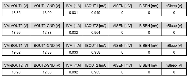

Hi all
Would you mind if we ask DRV8881E?
Please refer to the attachment file.
20190423_DRV8881E_question.pdf

    During the sleep mode, DRV8881 has to hold the high side FET off. DRV8881 internal high FET gate drive circuit may have a leakage path to ground to hold high FET off. When the VM voltage is higher than a certain high FET gate voltage threshold, the leakage path is active.
    I am going to confirm it with a designer. On customer side, they can reduce the VM voltage to 20V or 15V to see the leakage current change.

    And then, we measured using DRV8881E EVM with the customer's condition.
    We got the same result as our customer.

  • Matsumoto-san,
    The measurement result should be correct. The higher leakage current is coming from DRV8881 internal high FET gate drive circuit which may have a leakage path to ground to hold high FET off. When the VM voltage is higher than a certain high FET gate voltage threshold, the leakage path is active.
