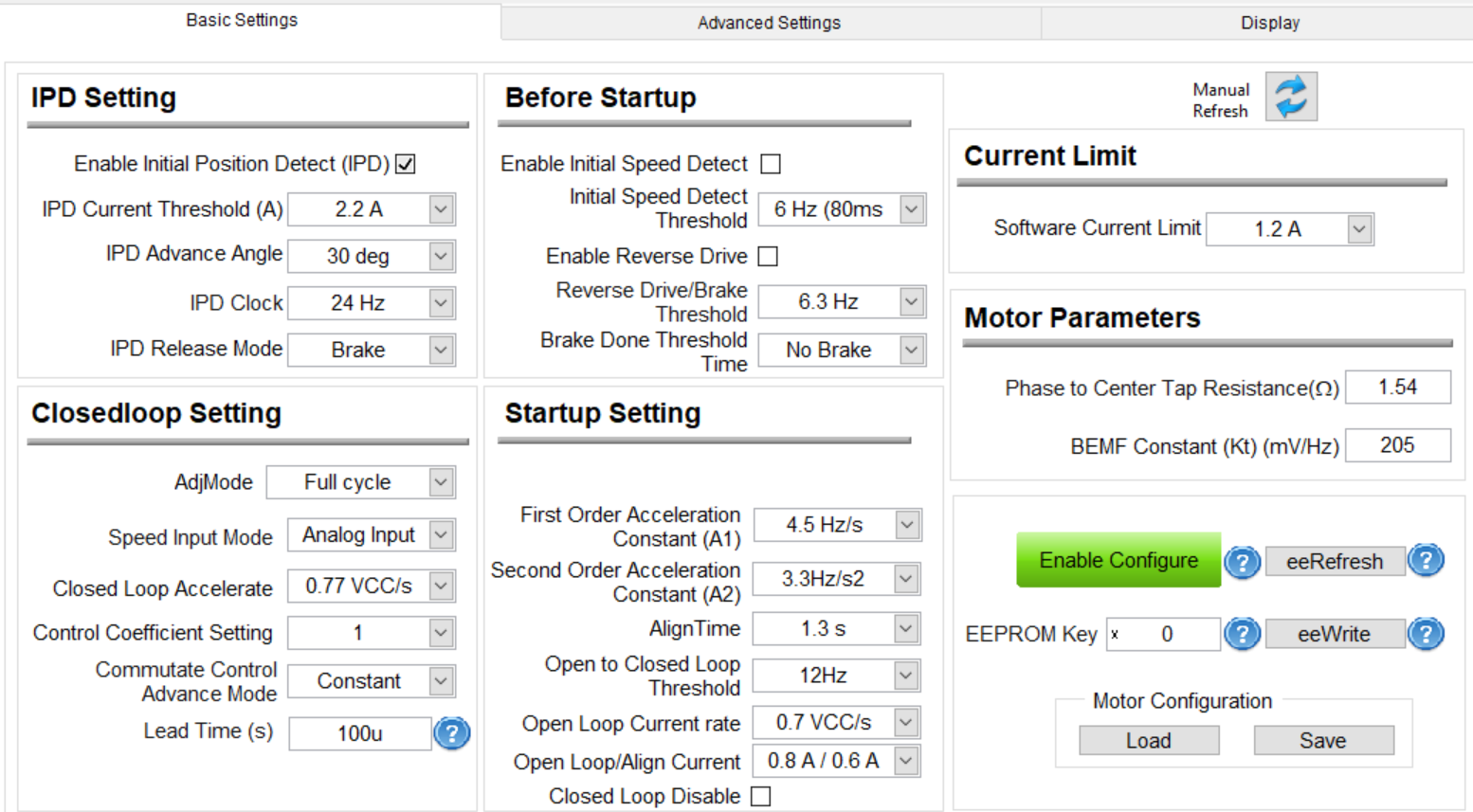

  • Hey Victor, just to make sure, your saying that the DRV10983 is able to spin the motor, but you are not with the DRV10983-q1 with the same settings? Can you share the settings you used for the DRV10983 and DRV10983-q1? If using the GUI, Use the save button on the GUI "Basic Settings" Tab. Otherwise send me the address of the registers and their values.
  • Thank you for your help.
    Yes Eval (nonQ1) part does spin the motor, with following settings:

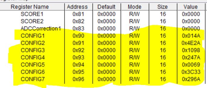

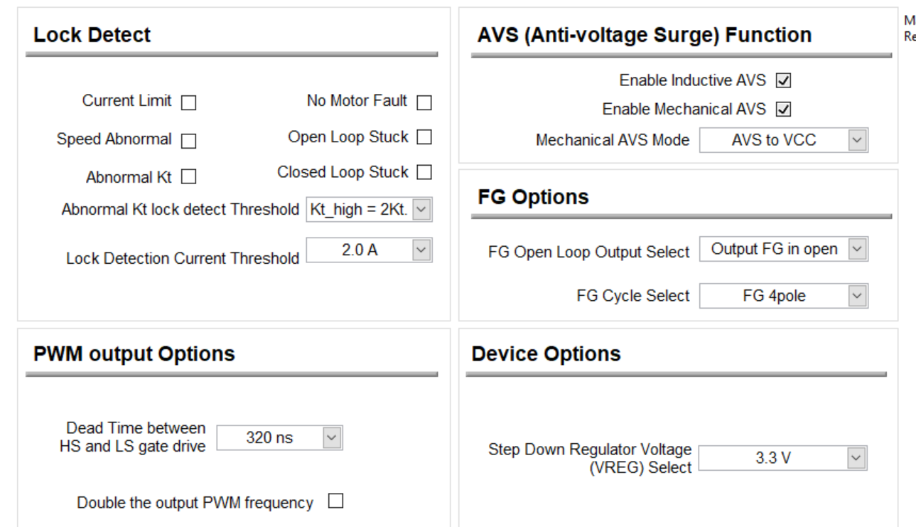

  • 1) I copied your config settings from DRV10983 to the matching values in dRV10983-q1 below.
    I just increased the dead time because the minimum dead time we recommend is 440ns at 120V/us slew rate.
    The corresponding setting is below.
    2) You need I2C to be able to write to EEPROM registers in DRV10983-q1 device and DRV10983.
