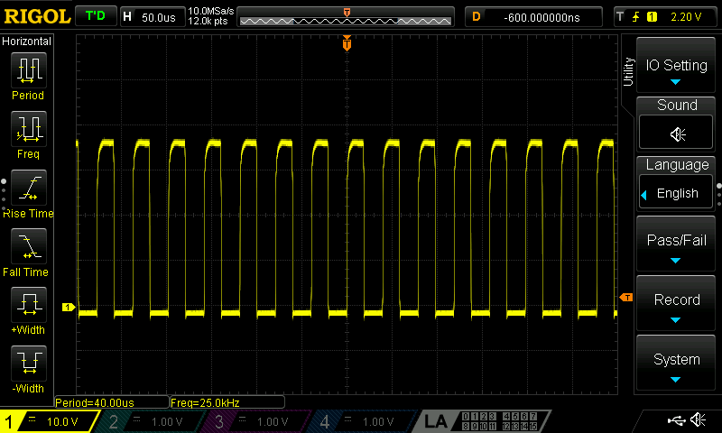

  • Hi Adam,
    Today we tried with same configuration. And motor started rotating.
    But the problem was when ever we were starting the motor we needed to slide rotate the motor by hand and then it use to start rotating.
    And we monitored one more thing, HAL sensor A and B was giving HIGH and LOW signal but, C was continuously LOW.
    For Testing our motor we removed the connections and we found All sensor were working normally. But when we again made the connection, then again motor is not rotating. And nFault pin is LOW. And GLx are low and GHx are high (aprox 5v). And also all Phase A, B, C are high (aprox 5v).
    Imran
  • And both Fault status registers are showing no Fault.

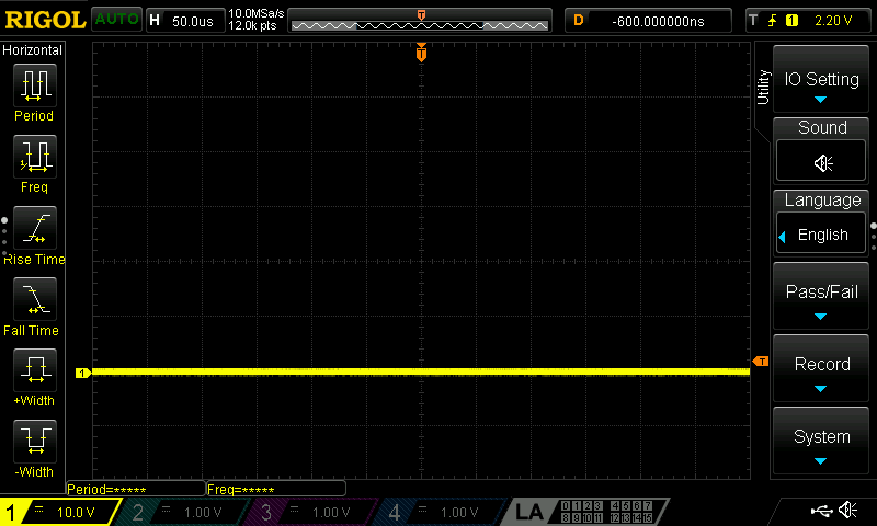

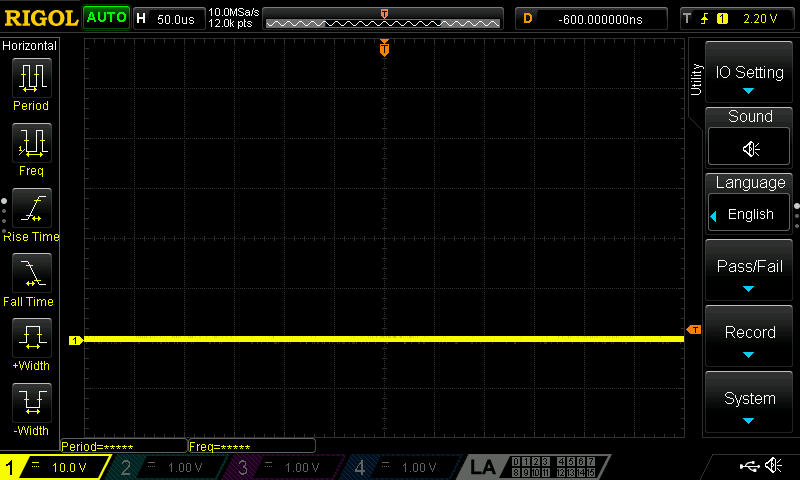

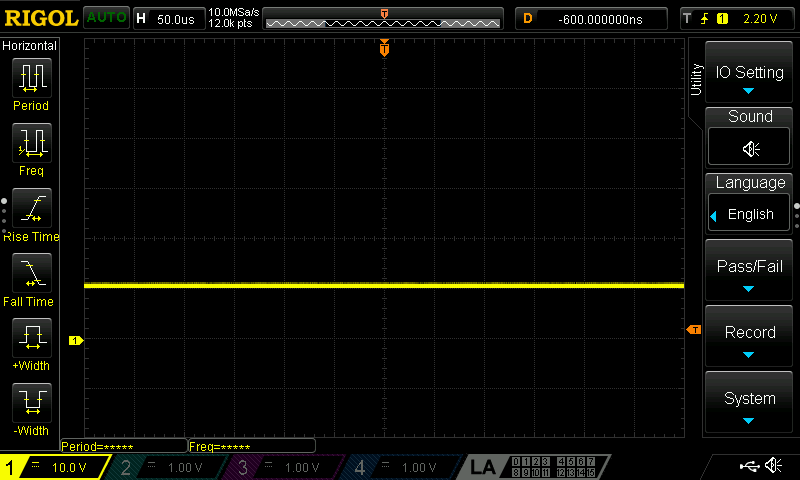

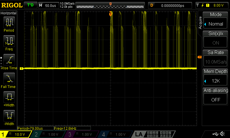

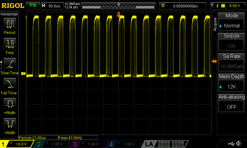

  • Hi Adam,
    At the end of the day we found there is issue with brake pin. But even after correcting that issue motor is not rotating.
    and this time we are getting these signals from scope:-
    Phase A output-
    Phase B and C output-
    GHA-
    GLA-
    GHB and GHC-
    GLB and GLC-
    And Motor is getting locked and getting heat up and Phase A wire is also getting heated. A nFault Pin is LOW but Fault status registers are showing no fault.
    Imran
  • Imran,
    Unfortunately it is difficult to resolve this issue remotely. It seems to me that your system is working intermittently. Have you double checked that all phase wires match the phase of the hall inputs? This could explain why sometimes the system is able to work.
    -Adam
  • To explain more, you need to check that the correlated phase is connected with the same hall sensor. If the hall sensor does not match the phase then you will get intermittent operation.
