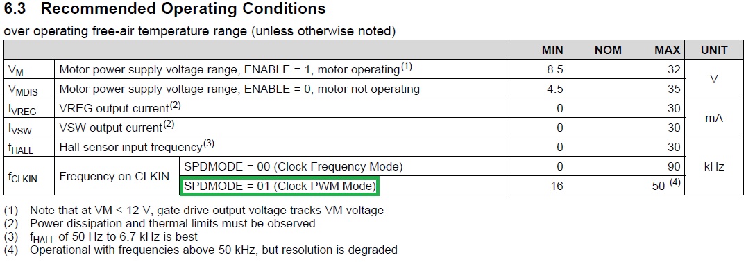

The VM pin have 9 V (the minimum in data sheet is 8.5V ) this is because i need to communicate with them over SPI to read and write the register.

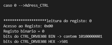

  • i pretend use a input pwm on pin CLKIN of DRV8308
    my PWM come from a microcontroler STM32F103xx  at this moment with 19 KHz .
    in the register 0x00 on SPDMODE i pwrite 00bynary
    the response from adress 0x00 is  this 16 bit 0000010100000001 or in hexadecimal 0x0501

    i write this configuration to DRV 8308
           Write in thisRegister HEX = 0x00
           escreveu thisValue hex = 511
           escreveu thisValue bin = 10100010001
           Write in thisRegister HEX = 0x01
           escreveu thisValue hex = 0
           escreveu thisValue bin = 0
           Write in thisRegister HEX = 0x02
           escreveu thisValue hex = 4FF
           escreveu thisValue bin = 10011111111
           Write in thisRegister HEX = 0x03
           escreveu thisValue hex = F82
           escreveu thisValue bin = 111110000010
           Write in thisRegister HEX = 0x04
           escreveu thisValue hex = 40D2
           escreveu thisValue bin = 100000011010010
           Write in thisRegister HEX = 0x05
           Write in thisRegister HEX = 0x06
           Write in thisRegister HEX = 0x07
           Write in thisRegister HEX = 0x08
           Write in thisRegister HEX = 0x09
           Write in thisRegister HEX = 0x0A
           escreveu thisValue hex = F000
           escreveu thisValue bin = 1111000000000000
           Write in thisRegister HEX = 0x0B
           Write in thisRegister HEX = 0x2A
    AND READ THIS VALUES
    Read Register: 0x00
    bits do CTRL_DRV8308 BIN -> contem 10100010001
    bits do CTRL_DRV8308 HEX ->511
    Read Register: 0x01
    bits do Adress_ADVANCE BIN ->0
    bits do Adress_ADVANCE HEX ->0
    Read Register: 0x02
    bits do Adress_COMCTRL BIN ->10011111111
    bits do Adress_COMCTRL HEX ->4FF
    Read Register: 0x03
    bits do Adress_MOD120 BIN ->111110000010
    bits do Adress_MOD120 HEX ->F82
    Read Register: 0x04
    bits do Adress_DRIVE BIN ->100000011010010
    bits do Adress_DRIVE HEX ->40D2
    Read Register: 0x05
    bits do Adress_SPDGAIN BIN ->0
    bits do Adress_SPDGAIN HEX ->0
    Read Register: 0x06
    bits do Adress_FILK1 BIN ->0
    bits do Adress_FILK1 HEX ->0
    Read Register: 0x07
    bits do Adress_FILK2 BIN ->0
    bits do Adress_FILK2 HEX ->0
    Read Register: 0x08
    bits do Adress_COMPK1 BIN ->0
    bits do Adress_COMPK1 HEX ->0
    Read Register: 0x09
    bits do Adress_COMPK2 BIN ->0
    bits do Adress_COMPK2 HEX ->0
    Read Register: 0x0A
    bits do Adress_LOOPGAIN BIN ->1111000000000000
    bits do Adress_LOOPGAIN HEX ->F000
    Read Register: 0x0B
    bits do Adress_SPEED BIN ->0
    bits do Adress_SPEED HEX ->0
    Read Register: 0x2A
    bits do Adress_FAULT BIN ->10000
    bits do Adress_FAULT HEX ->10

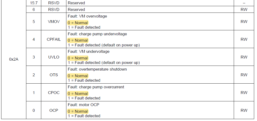

    escrita no registo RSVD VMOV CPFAIL UVLO OTS CPOC OCP
    0X0018 0 0 0 0 0 0 0 0 0 0 0 1 1 0 0 0
    0X0010 0 0 0 0 0 0 0 0 0 0 0 1 0 0 0 0
    CPFAIL IS ? [->Fault: charge pump undervoltage<-]  information from data sheet pag 40.
    when i measure i have:
    VCP = 24.03 V
    VM=24.76 V
    I have the same capacitor like the EVMboard and datasheet say.
    when i try to run the motor they don't run  BEACAUSE the erro 0x0010 i think.
    i try run put the PWM  19KHz signal in CLKIN  and ENABLE =3.3 V  and DIR pin=3.3 V
    so how i fix the error? how bits i need to change??

  • Hello ADAM,
    my motor RUN finally but i don't understand WY i have a Fault...
    read Acess Register: 0x2A
    bits  Adress_FAULT BIN ->10000
    bits  Adress_FAULT HEX ->10
    0x2A register RSVD VMOV CPFAIL UVLO OTS CPOC OCP
      0X0000 to reset 0 0 0 0 0 0 0 0 0 0 0 0 0 0 0 0
      0X0018 (normal fine) 0 0 0 0 0 0 0 0 0 0 0 1 1 0 0 0
       0x0010  motor RUNNIG  0 0 0 0 0 0 0 0 0 0 1 0 0 0 0
    ERROR CPFAIL =>1 = Fault detected (default on power up)
    HOW  i remove the error ? when the motor running i write in register 0x2A all zeros 0x0000. don't solve the problem.
    when i write zeros when the motor is STOP do not solve the problem.
    what i need to do ADAM ??  to solve this problems???
    The motor start RUNNING when i change the register 0x04.
    best regards Adam
  • Esmith,
    The system is indicating that you have a VM and/or CP voltage issue. Have you monitored the VM and CP supplies throughout the whole startup/motor spinning process?
    What did you change in register 0x04 to make the motor spin?

    yes i have the VM=24V and VCP=24V when enable is HIGH my VCP change to 34V

    Acess Registor: 0x2A
    that say i have a fault detected (default on power up) what this mean??
    We have two moment to say power up...

    I read the records all with 0x0000 and 0x2A with 0x0018.
    I try to run the engine and it does not work.
    I write my records
    and I certify that he writes when he reads and he is writing.
    I turn on the engine it spins type one second and then stops,
    I still can not get the CPFAIL error.
  • Esmith,
    After the engine spins for 1 second and stops, is the fault pin low? What do you see on register 0x2A after the engine spins and stops?
    It is normal to see 0x2A as 0x18 at startup (once the VM rises above the VM reset threshold). Register 0x2A must be reset by writing 0x0000 after VM rises above the VM reset threshold.
    -Adam
  • hello Adam,
    " once the VM rises above the VM reset threshold "
    where i can find the value on data sheet for VM reset?
    I need change my power FET because they have more than 20V on Vgs .... this value is if i use a power suply with 24V
    (so it burned the Fets and the DRV with reverse voltage, burned the DRV, also put a resistance of 33ohms in the gate of the fets.)
