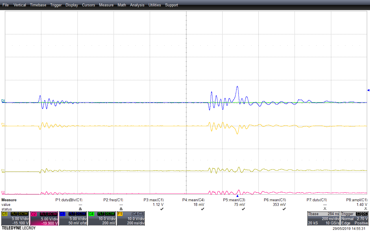

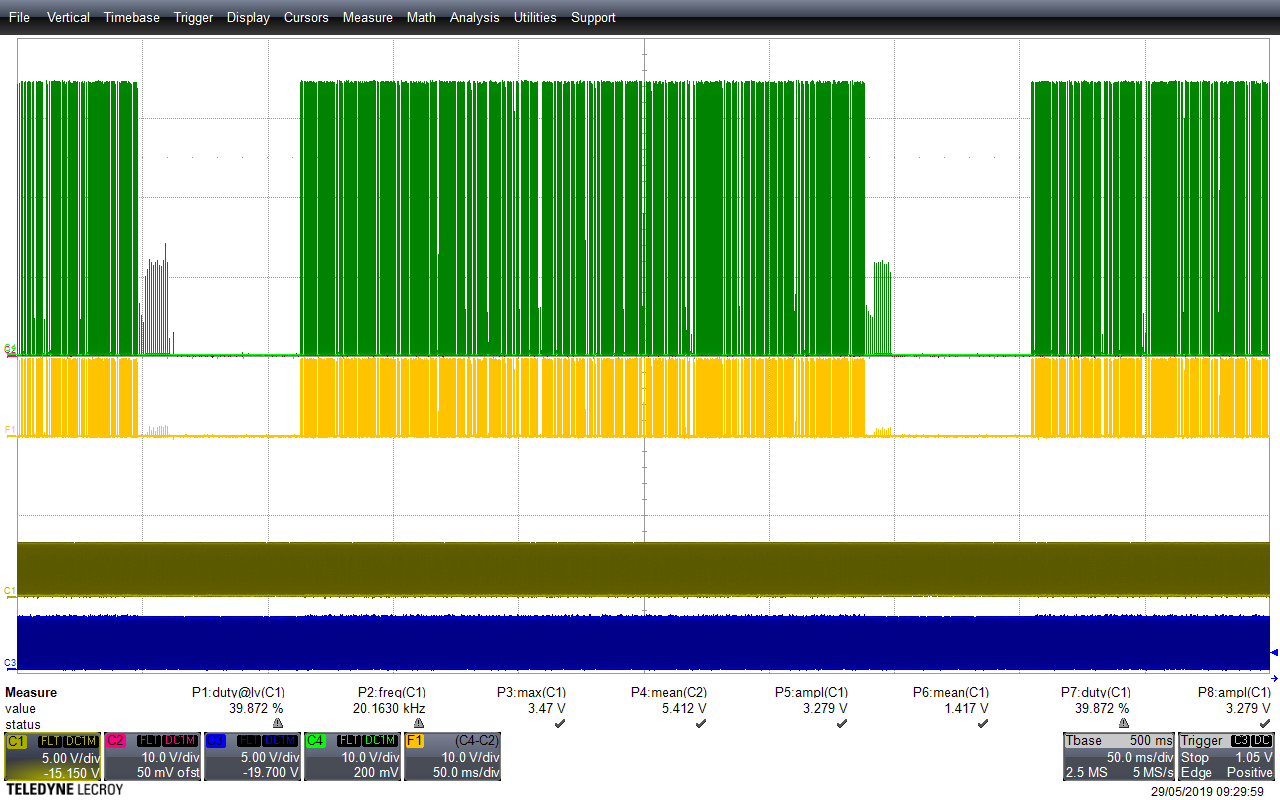

I wish to use the DRV8302 to drive a brushless motor. During my unitary test of said driver I saw that the output is not as expected when using the 6-PWM mode. On the image hereunder I have nFAULT and nOCTW on C1 and C2. C4 is my input onto INH_A which is coming from a function generator. C3 is the ouput I get on GH_A.
The signal is measured in regard to the common ground.
This problem is not observed on the low side nor when using a 3-PWM mode (high and low side).
Do you have any explanation ?
Thank you.
  • Thibaut,
    The high side FET is not referenced to GND, it is floating on the motor switch node. Please check the same measurement using a differential probe between the high side gate and high side source connection.

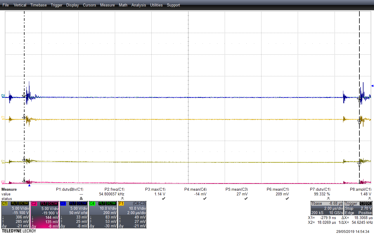

    To put a bit more of context on the test I am doing the test without the FET connected and deactivated the protections to avoid output cut-offs. As you asked I did the same measurements using a differential probe. The probe used is a Lecroy ZD1500.
    Regarding your second question, I generated the 6x PWMs using a microcontroller (STM32F4) to make both original and complementary signals but since the results were not as expected I went back to use only one input (using function generator) in 6xPWMs mode and monitoring only one output.

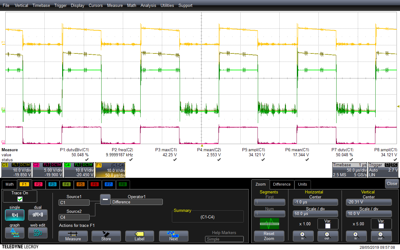

    UPDATE :

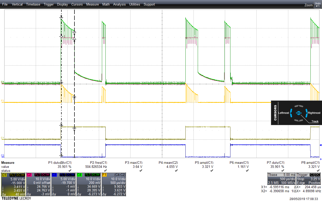

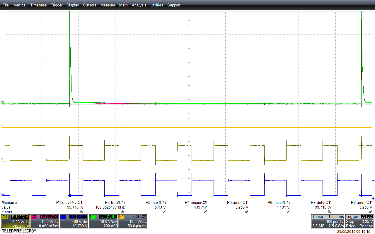

    With the FETs connected I did a new check of my voltages on SH_X, GH_X. When in 6-PWMs mode I see as follows (C1 is GL_X, C2 is INH_X, C4 is Sh_X and F1 is C1-C4) :
    Then I did the same measurement in 3-PWMs mode. The results are as follows :
    As you can see in 6-PWMs I dont have the ~11V needed to turn on the FET. The problem should thus be regarding the GVDD but checking it did not show anything.
  • Thibaut,
    What are you seeing on GVDD? The Vgs in 6x mode shows no voltage!

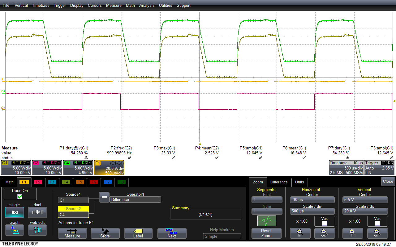

    Here is something interesting :
    In pink (C2)  I have SH_1, in green (C4) GL_1 , C1 and C3 are respectively INH_1 and INL_1 in 6-PWM mode however this time I also applied 5V onto INL_3. The FET stage is completely wired and the motor is "simulated" using 500ohm resistors. Any ideas ?
    Cheers.

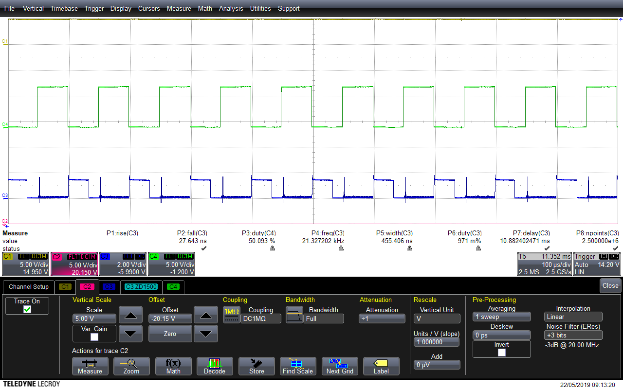

    I changed the PWM frequency from the 500Hz to 10kHz and 20kHz and it works better (same as in 3-PWM mode). However I often get as follows :
    Observing nFault at the same time shows that it goes to 0V from time to time. I think it may come from the noise that is everywhere, power supply included. Any other ideas ?

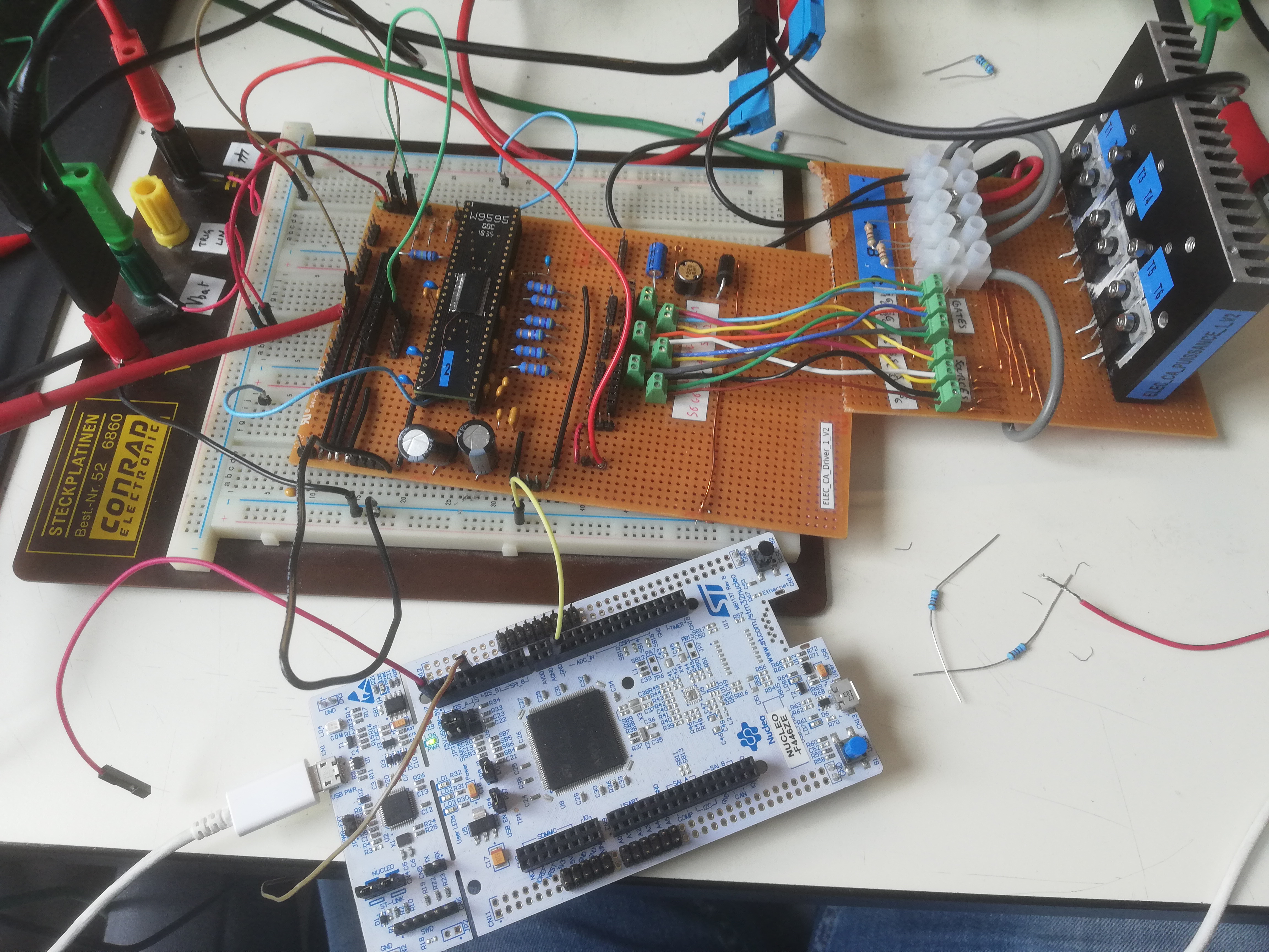

  • Adam,
    Here is the image of the setup, it is quite rudimentary. Usually the stm32 board  connects to the INH_A and INL_A and a 5V cable goes to INL_C . There is a 5V line on top of the stripboard and GND at the bottom. The GND from the power pad is connected to the other ground and the stm32 ground is also connected to the rest.
    The resistor charge between phase a/b and b/c is 500ohms which leaves a 1kohm between phase a/c.
    Cheers,
    EDIT :
    Reconnected everything, the GVDD seems to hold now even though no changing were made however nFAuLt latches regularly when the power stage is powered. when only connected (fets connected tout drv) there is no problem but when current is going through it latches even though I connected OCADJ to 3.3V
