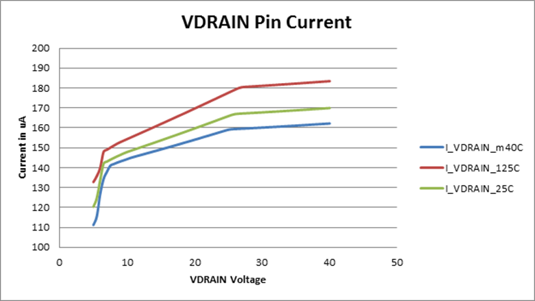

Q2.  What are "VM" pin and "VDRAIN" pin internal impedance during the following conditions?
  "nSLEEP" pin=H level, "MODE" pin = Hi-Z(open), "IN1/PH" pin =L level, "IN2/EN" pin =L level .
