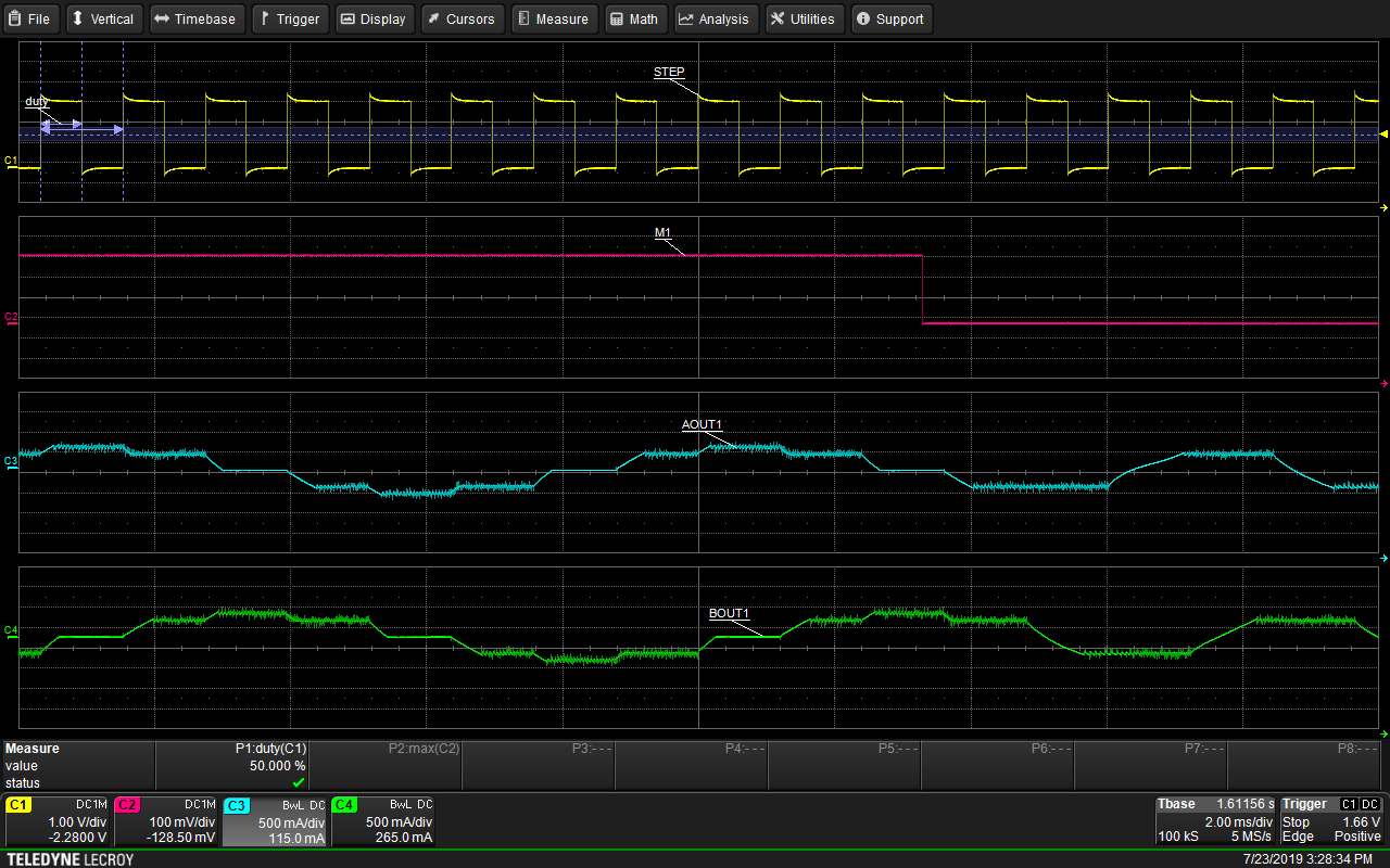

    I looked at your waveforms and ran my own test, using the TI EVM, to see If I got similar results as you. My data (seen below) suggests that the device is stepping correctly when the direction is set to reverse (DIR=0).
    It could be possible that this problem is only occurring on your device. To figure out if that is the case, I need to know the following information.
    • Are you using TI EVM or your own board
      • If using TI EVM, what is the lot trace code?

    If I am not mistaken, I believe the waveform I sent you matches the waveform you attached in the fist post. Both of them are at the same position (Aout:0% and Bout: 100%) right when step mode is changed.
    I will go to the lab and try to recreate the waveforms you have attached. I want to see whether I get different results than the customer.
    I will give you an update soon.

    I was able to recreate your customer's waveforms with starting electrical angle position of 45, 135, 225, and 315 degrees for DIR=0 (reverse). We have noted this particular issue and will be updating the datasheet accordingly.
    Thank you for bringing this up to us and for your patience.
