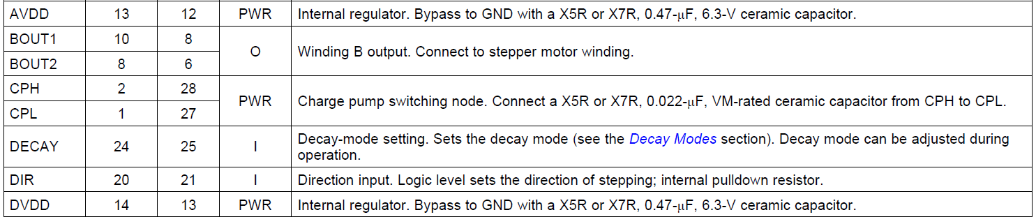

Our customer have a plan to use the DRV8886, have a question.
Could you tell me the minimum and the maximum value of the capacitor Cvcp and Csw that can be used?
The supply of the ceramic capacitor is still poor.
It is too difficult to get the recommended value capacitor.
