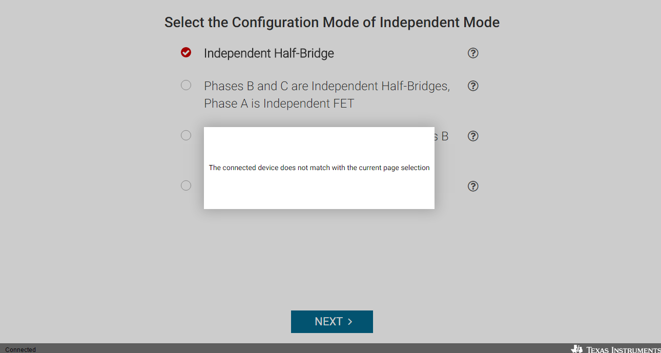

Now our customer has been evaluating the DRV8343H-Q1 EVM and they are facing some issue.
[Situation]
Firstly they were driving the DRV8343H-Q1 by "sensorless motor" control mode. At that time there was no problem.
After that, they connected the Phase A node with GND in order to check about the protection feature. Then the DRV8343-Q1 stopped working and output Fault (I think it is due to overcurrent protection.). Customer re-enabled the device and the cleared fault.
After this, they launched the GUI again. They want to select "Sensored motor" or "Independently Drive upto 6 loads" control mode but they can't select it.
The GUI seems choosing the "sensorless motor" mode automatically.
Q. Can you let me know how to choose other control mode?
