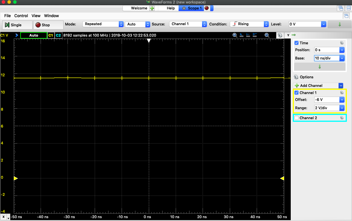

  • Adam,
    I hooked up my oscilloscope to the board as close to the pin as I was able and have attached a picture of the resulting waveform. I sampled the data at 100 MHz (as fast as my scope will allow) if that provides additional information.
    Stuart

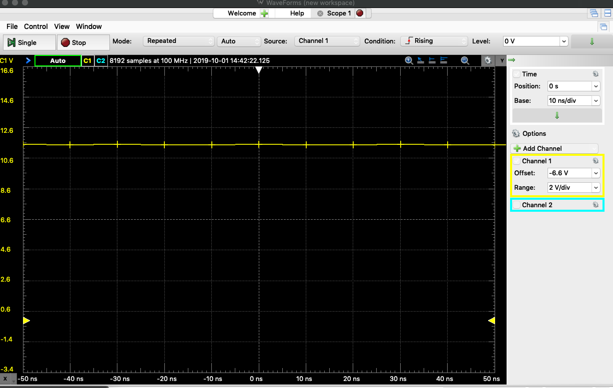

  • Stuart,
    Was this check done with the board switching? I want to make sure the charge pump works under normal operating conditions and load.
    Can you explain how you arrived at the assumption that the fault you are seeing is caused by chargepump undervoltage?
    -Adam
  • Adam,
    The new waveform of the charge pump voltage (attached) was taken with the board switching (or trying to) the N-channel FETs.
    I arrived at the fault being the chargepump undervoltage based on the fault condition table in the DRV8304 datasheet. There are only two fault conditions that cannot be cleared by performing a power on reset, i.e. pulling the enable pin low for a short period. One of which is a VM undervoltage condition where the VM is below a certain threshold ~6V. My VM voltage remains constant at 12V and I have added a bypass capacitor to help filter out power supply voltage drops/spikes. Additionally, the Vcp voltage is reading under 12V. The datasheet says that the voltage reading should be 10V higher than VM.
