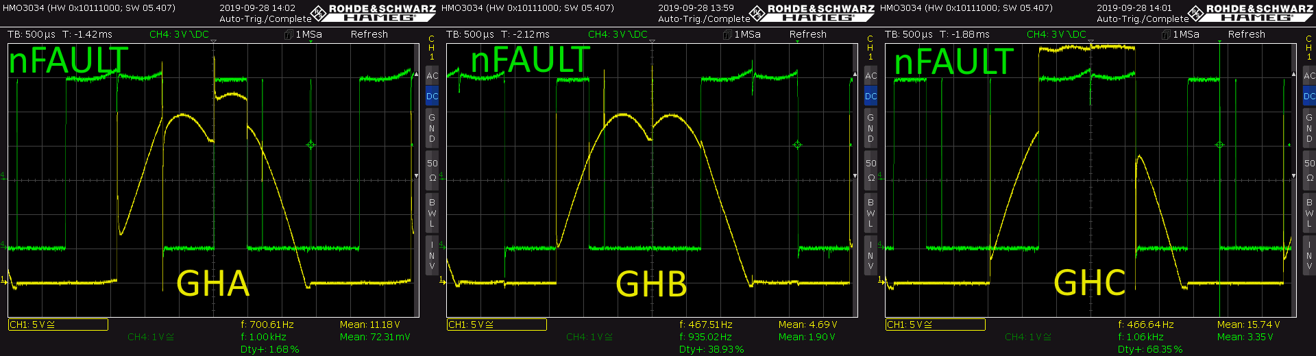

Below are the gate voltages of the high-side MOSFETs and the drivers nFAULT output when driving the motor at 100% PWM duty (there is no switching of MOSFETs except at hall transitions).
We expected GHA and GHB voltages to be similar to GHC.
There are some narrow peaks at which the nFAULT goes high and the gate voltage rises (but not to the value that it is supposed rise). But this peaks last only 4us, which corresponds to TDRIVE value.

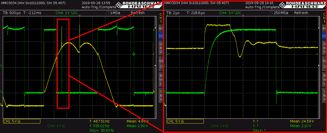

Below is the zoomed view of one of these peaks.
Note that gate voltage reaches only to around 32V (VDRAIN + 8V) where it should have reached 34.5V (VDRAIN + 10.5V).

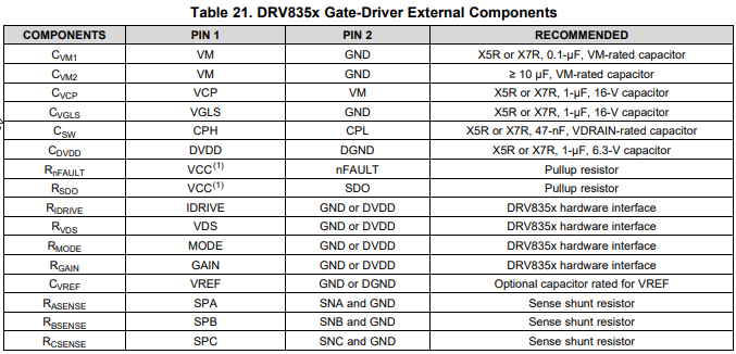

    Only other big difference I found was that Csw capacitor value is too big compared to the recommended value (1uF vs. 47nF). Is this a problem?

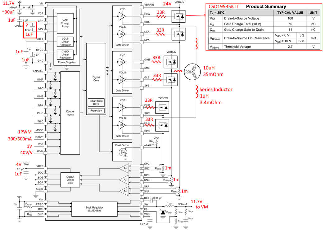

    Unfortunately I can't include the actual schematics. But the design is almost same as the typical application in the datasheet. Final working values and additional components are shown in the picture below.
    Kursad

    If you use a DMM to compare this unit to a known good unit, do you see any pins which are shorted or open where they shouldn't be? This may help us identify which block of the chip is getting damaged.
    Please use a scope to check the Gate to Source voltage of all FETs as close to the DRV as possible while it is running, make sure it's between the 33R and the DRV as this is the true voltage the DRV will see. We want to check for overshoot and undershoot at either the gate or source lines.
    What is the purpose of the added inductors in the motor lines?
    The CPH/CPL cap being bigger than recommended will likely cause issue as the charge pump is designed for the value in the datasheet and using a different value has not been validated. Likely this is damaging the charge pump.
