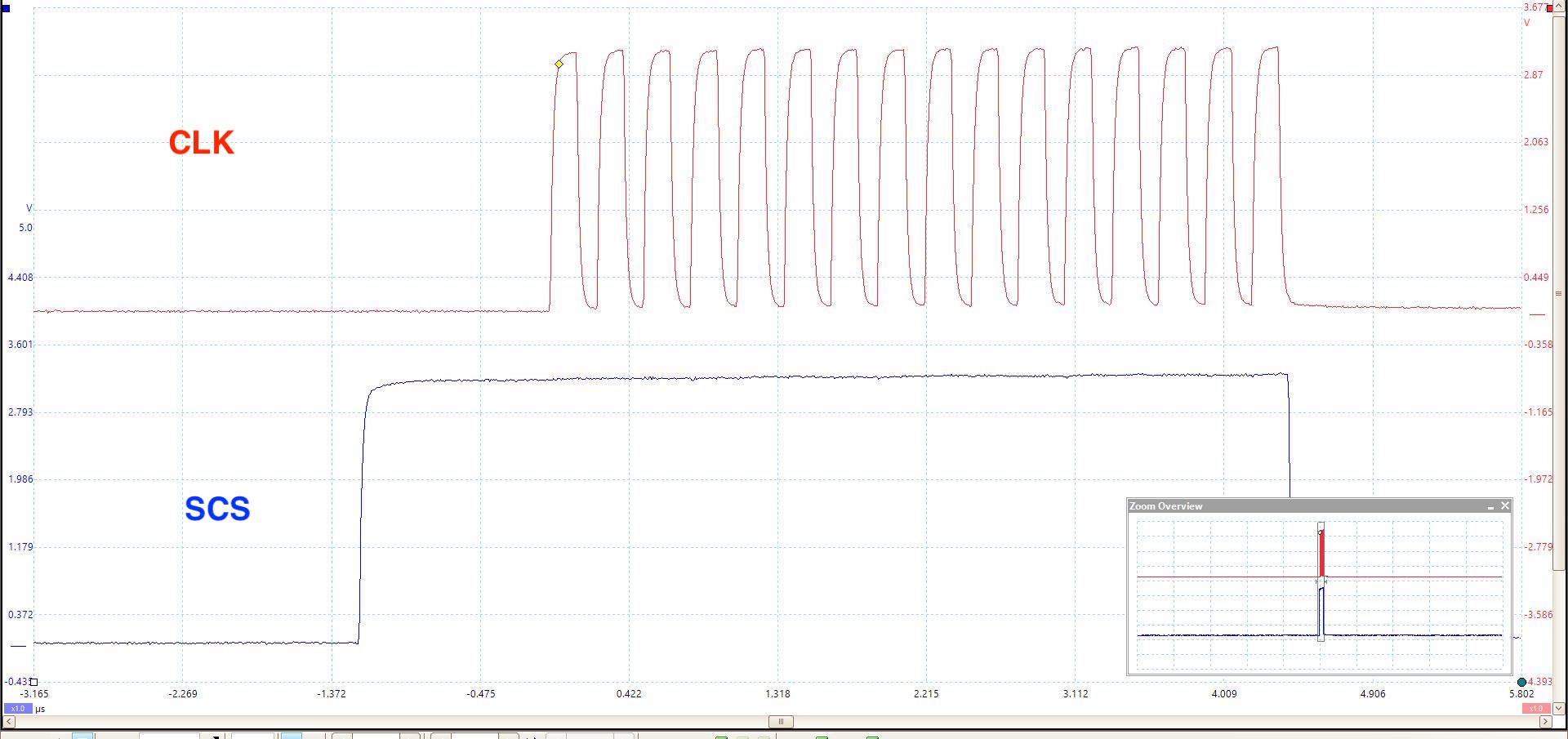

I'm trying to communicate with the DRV8704EVM via SPI with a MSP430 Launchpad.  However, the response from my SPI transfer is 0xFFFF no matter to what register I try to read from.

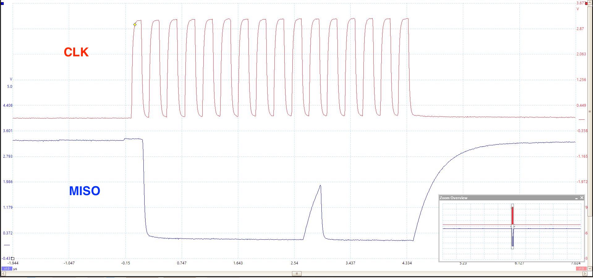

    I've looked at Energia SPI sample code and was not able to read from the register properly. This are my singnal captures (sorry that they are split into multiple images only have a 2 channel oscilloscope). I'm trying to read from the TORQUE Register.
  • Hi Roberto,
    No need to be sorry about multiple images. You provided the information needed to move forward.
    There are two issues to address from the images:
    1) The MOSI signal does not appear to correct for a read of the TORQUE register (Address 0x01h). This appears to be a read of Address 0x07h since the first 4 bits are high.
    2) The SCLK timing may be too fast for the SDATO pullup resistor. Notice the SDATO signal is approximately 50% of the high value.
    Please try the following:
    1) Reduce the SCLK frequency to 1/2 the current frequency to allow the pullup to rise to a valid logic high.
    2) Try reading the DRIVE (0x06h) register instead of the TORQUE register. The pattern is easier to determine if it is correct. The data read back on MISO should be 0xFA5h
  • Hi Rick,
    Setting the serial clock to 4 MHz solved the SPI communication issue.  I can now read/write from/to the DRV8704 using code in ENERGIA.
    Attached is the code I'm using for reference for others.
