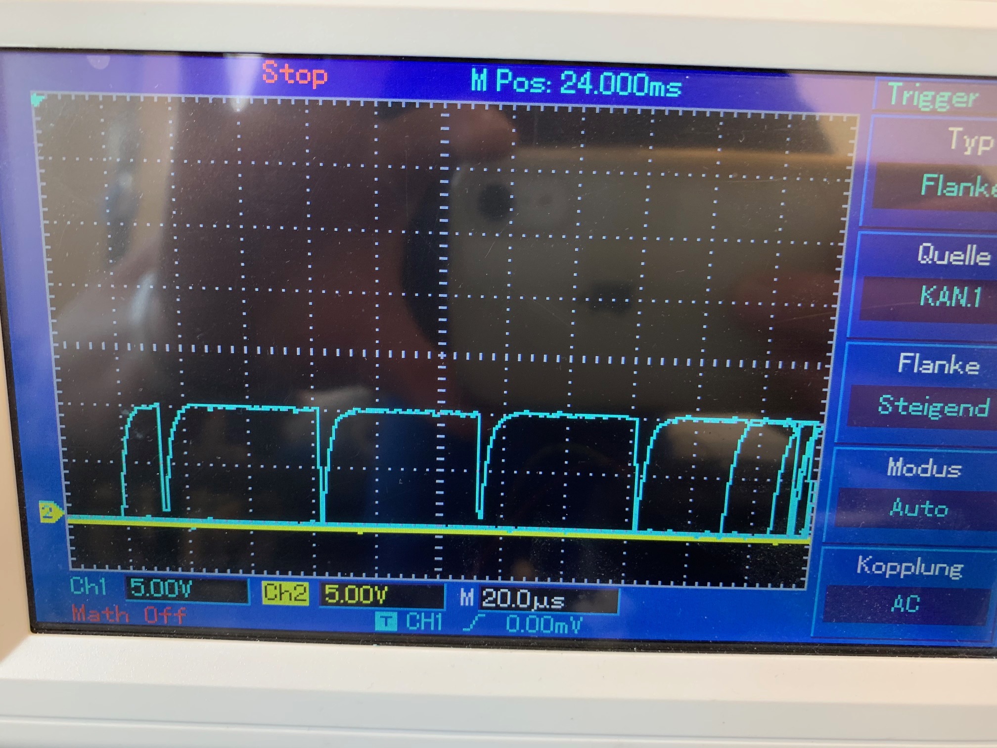

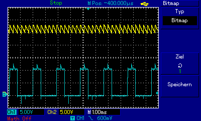

    I have did one more test and you can find two scope pictures. I have compared the switching of motor voltage from DRV8350 (first picture) and a drill from a shop (second picture). I can see, that at my controller the voltage goes very low in a ramp, at the controller from the shop the voltage is more stabel. The voltage don't go down so much. I have tried 20 kHz and 40 kHz but the result ist the same. DRV8350 switch the voltage very low? Can this be a problem for MOSFET or is this a problem / behavior of the DRV8350? When yes, can i change anything?
    Attached you can find the schematic of the power part. Seems like the MOSFET don't switch complete On? We have approx. 160 Ampere.
    Thank you!

    the plots show in first picture the voltage at the windings U and V driven with DRV8350. Second picture is voltage at windings from power tool I have bought in a worker shop. DRV was connected to the same motor, so I only replace the controller unit! So I directly can see and hear, that at upper torque DRV don't control like original controller. Plots show the same!

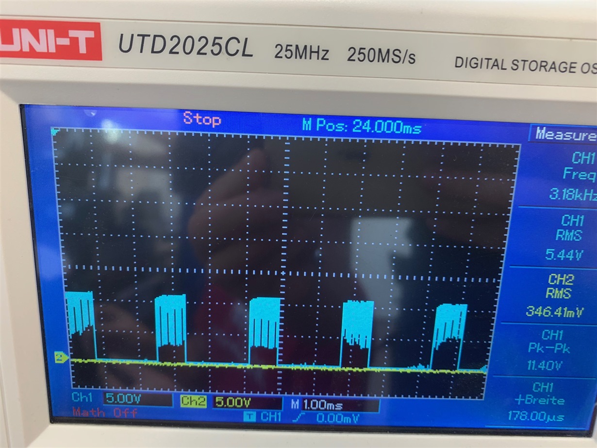

  • Hi Adam,
    attached are the plots of VGS from one Highside MOSFET from Gate to source (picture one and two) and Lowside Mosfet from gate to source (picture 3)
    Picture 4 is a plot from power supply input. I think here is the problem. If I compare this with the bought tool, the power supply only have some spikes but 95% is a line.

    It looks like your low-side VGS is very noisy, it's possible that you are getting partial turn on of the LS FET when there is lots of current through the bridge. Can you share the layout so we can comment?
    Since your FETs have a very low turn on this may make the problem worse. I would try the FETs you mentioned above.
