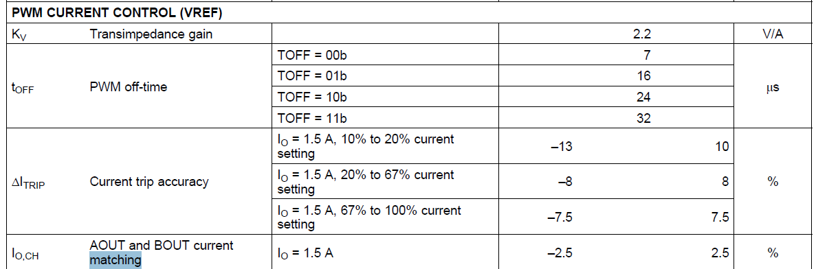

    DRV8889 has integrated switch FETs. I have two concern with 20mA coil current regulation:
    a. The winding current mismatch. At 1.5A, the mismatch current is about +/-37.5mA which is higher than 20mA coil current value.
    b. The winding ripple current and variation could be much higher than the 20mA regulation current. In this case, it is hard to control the winding current at 20mA.
    I would select external current sense resistor stepper motor solution, such as: DRV8846...
    FYI. DRV8889 spec.

    BTW, DRV8889 2.5% mismatch current is at 1.5A. When the current goes down, the percentage goes up. But, the mismatch current should be lower than 37.5mA.
