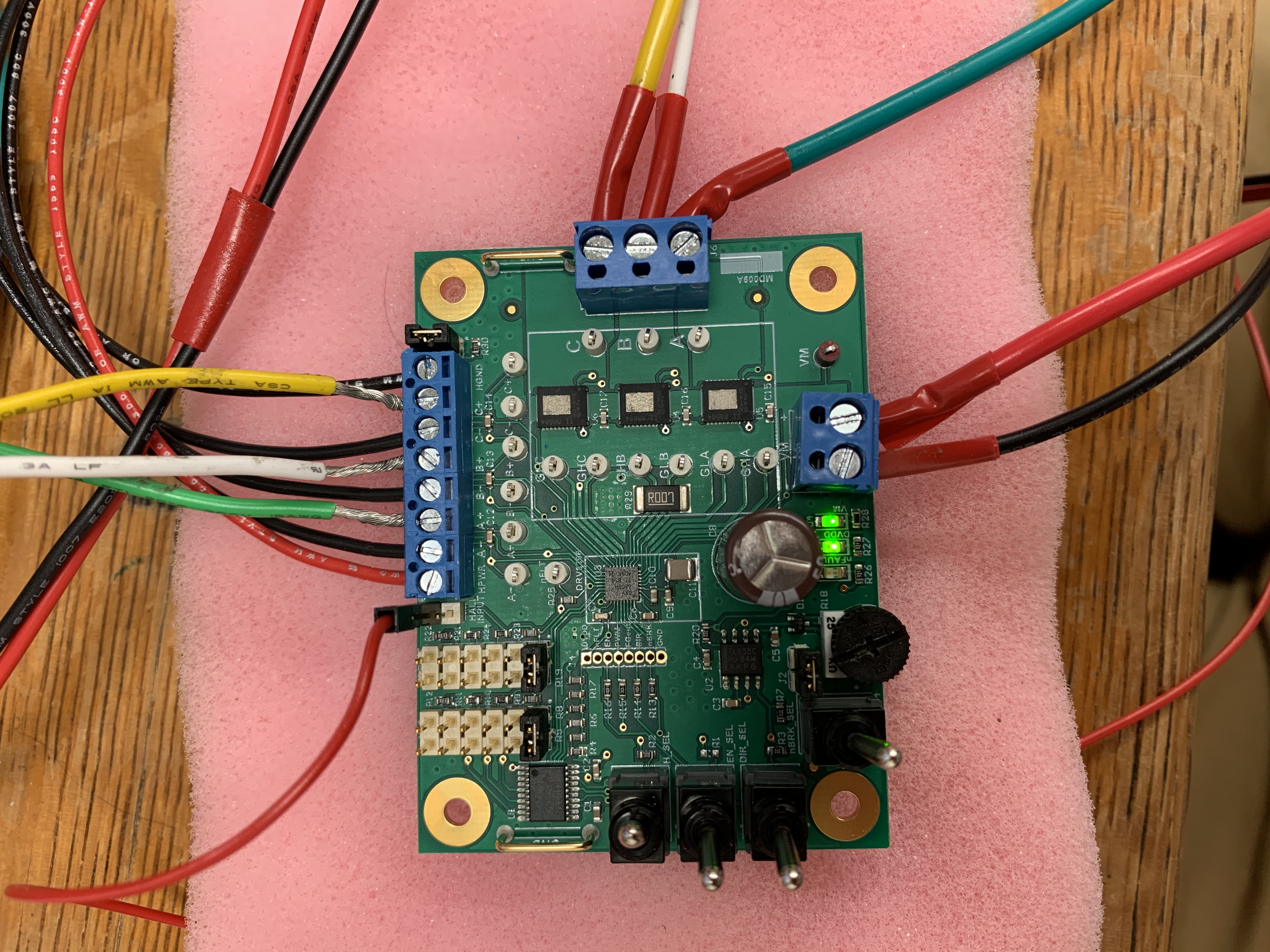

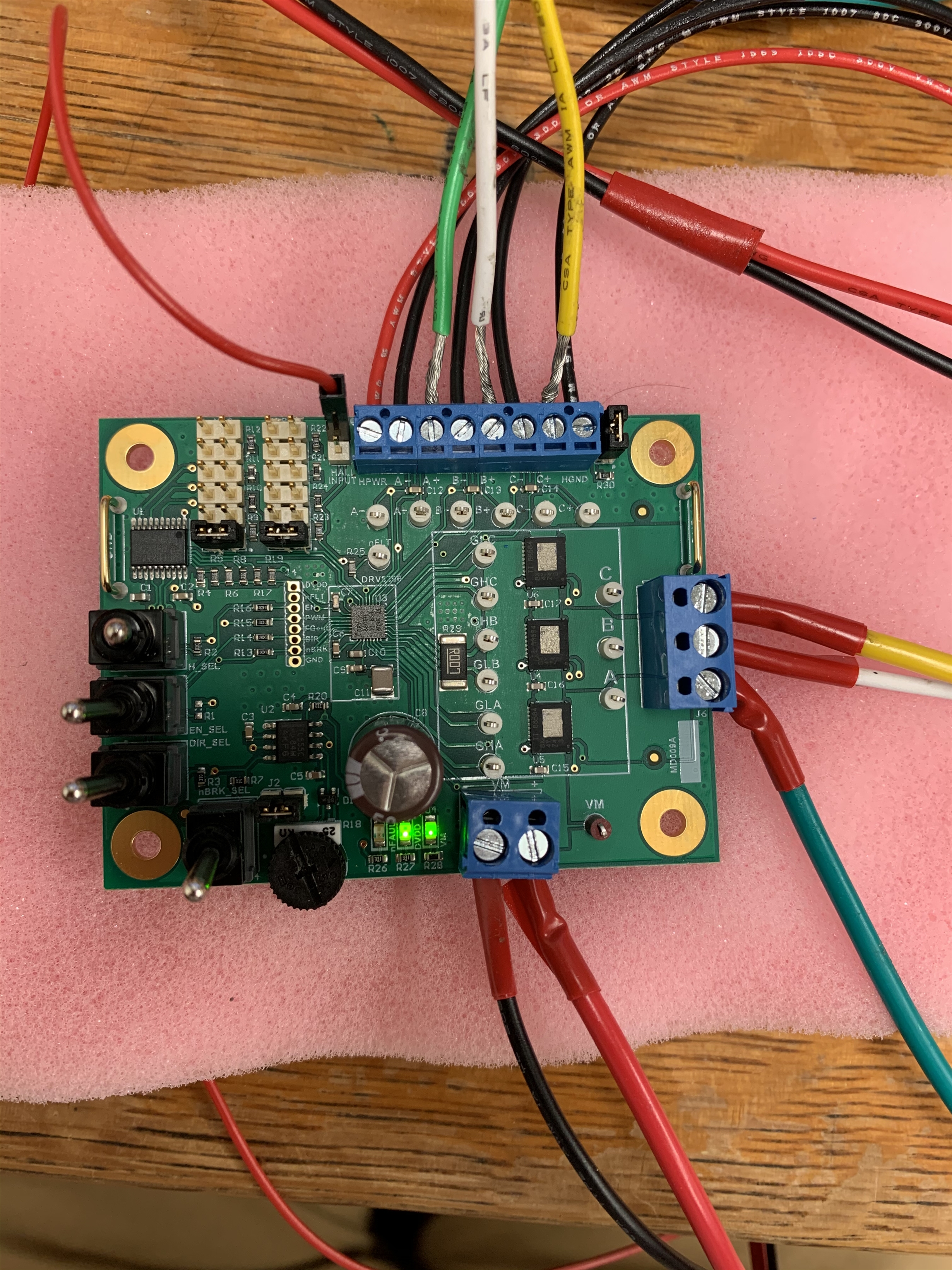

I'm trying to use a DRV8306EVM to drive a 3-phase BLDC motor equipped with Hall sensors. All wires are connected according to the user guide of the module but motor just doesn't move at all.
1-the voltage input at VM terminal is 12V (in the range of 6-38V as you mentioned), the current is not limited;
2-swith (S4) is set to run, switch (S3) is set to single-ended (there are 8 pinouts according to the user guide page 7, 2.3.3), swith (S2) is set to enable;
3-jumper JP1 is removed, pin 2 in JP1 is connected to an external power supply of 5V, all of the "-" terminals (low side) of Hall sensors are common grounded.;
4-There are 8 pinouts from the motor, 3 phase wires, 2 Hall power wires and 3 Hall signal wires, according to page 7, 2.3.3 of the user guide, I selected single ended at switch S3.

    Please show a picture of your setup in the "running" state.
    Do you have a scope that you can use?
    -Adam
  • Hi Adam,
    Thank you so much for your response. The setup of the running state is as shown above. Yes, I have a scope for inspection.

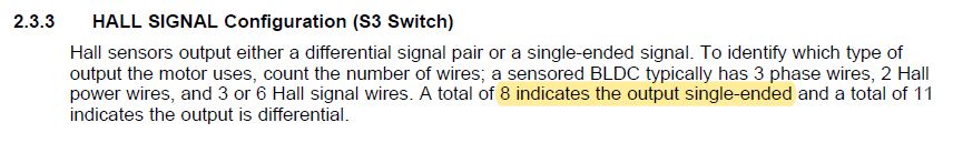

    1-I selected signle-ended according to the user guide page 7 (as shown below) since my motor has 8 pinouts in total

    It is okay to power the halls with 5V as long as the halls are open drain type. If they are Open Drain type then the pull up voltage present due to the selection of the S3 switch and U1 will control the voltage that the MCU sees when the halls are HIGH.
    I am still not sure why you have connections made to A-, B-, and C- if your hall sensors are single ended. These three connections are only to be used if the hall sensors are differential.

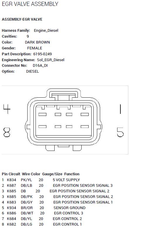

    Thank you for your response. I made these three connections by supposing that each channel of the phase generating a single-ended signal. Since there are 3 phase, there are three single-ended signals to the driver board, and the '-' sides are common grounded. I do have another non-TI EVM in hand and it works well in motion control but it cannot conduct a torque control when the motor stops at some certain position. That's the reason I search for another EVM. The motor is actually an OEM actuator in the exhaust recirculation loop onboard our tested engine platform so I don't have any available datasheet about the motor. The attached below is the pinout diagram of the motor. Please me know if you have any suggestion in this case. Thanks again.

    I'm not sure what to advise here as we don't know enough about this motor and you don't have a datasheet.
    -Adam
  • Kuo,
    I would check using a scope that the halls are active LOW and that they are separated by 120 degrees.
