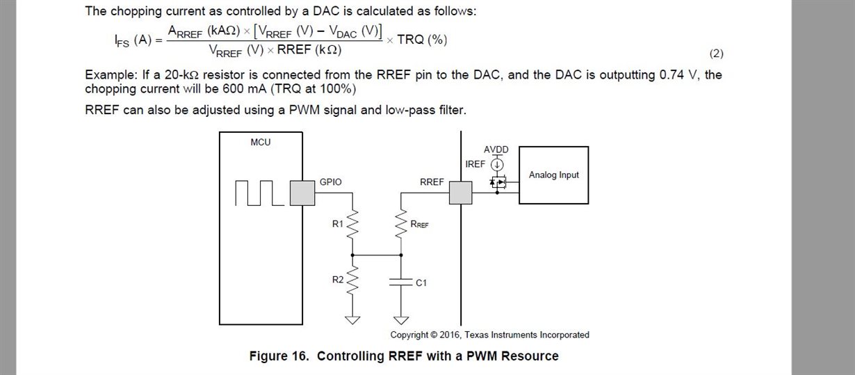

Could you please help to share how to use the PWM signal to control the chopping current in DRV8885?
Should we calculate the Voltage on the C1 and then use the equation 2?
Could you share the details calculation of Vc1?

Wang,
I under stand the calculation from VDAC to get Vc1 in DAC mode.
But I am wondering how to calculate the Vc voltage when using PWM source with the RC filter here.
