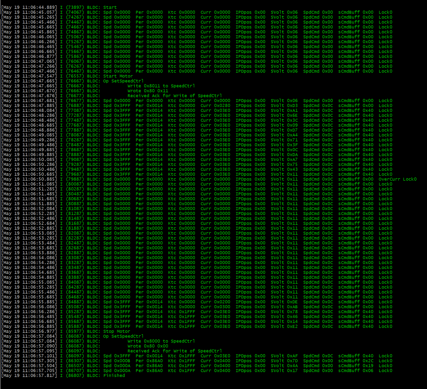

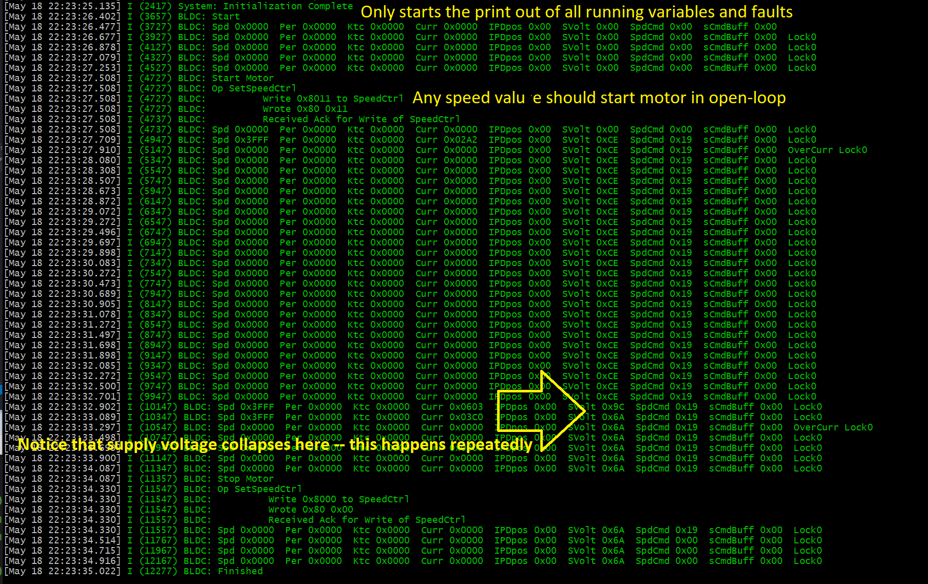

DRV10987: Can't get the driver to spin the motor -- OverCurr / Lock0
Part Number: DRV10987
Yes, the software curr limit is lower than the hardware limit.
Yes, OpenLCurr is set below my software current limit.
Yes, I have the unit restricted to open loop.

  • I'm also seeing a strange anomaly in the Supply Voltage readings.   When I start and stop the motor by I2C command and I continue to read all the values from the first 7 addresses -- the Supply Voltage starts out correctly at around 12.35V -- but when I start/stop by I2C command, I get higher voltage readings with can't be correct.   That voltage level reading returns to a correct output when I reset the entire board and the driver chip reinitializes.   Not sure why I'm seeing this strange behavior.

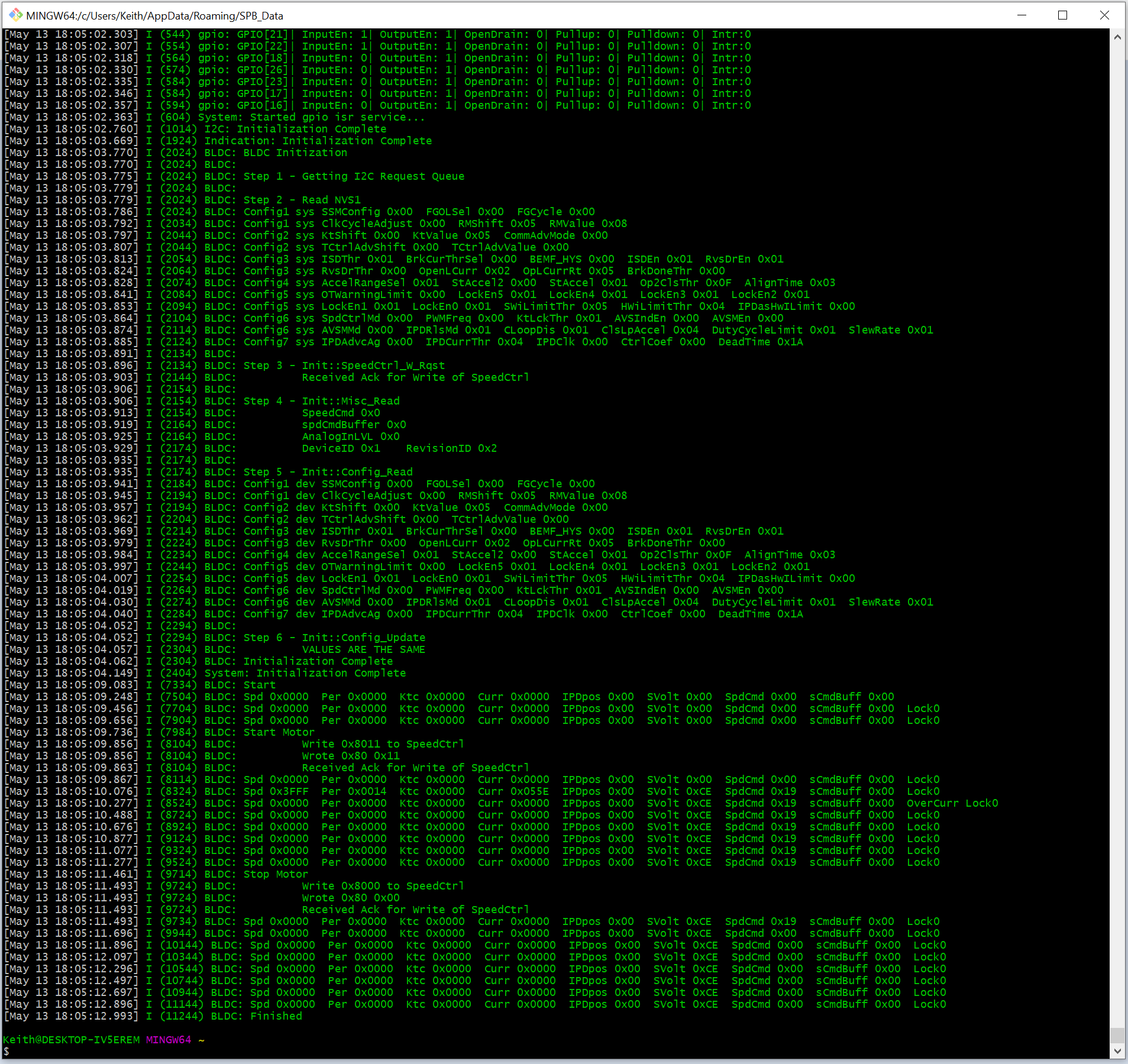

  • Every line output in green is a fresh read.   When I have an error - I clear the fault register.
    Yes, I read the supply voltage with I2C.    Some variation is seen right in that picture with the print statements.  0x69 is 12.35V.
    HOWEVER, I found a big problem today.   My motor is 24V.   So, that might be the whole problem.    I need a day to mod the board and try all this again.

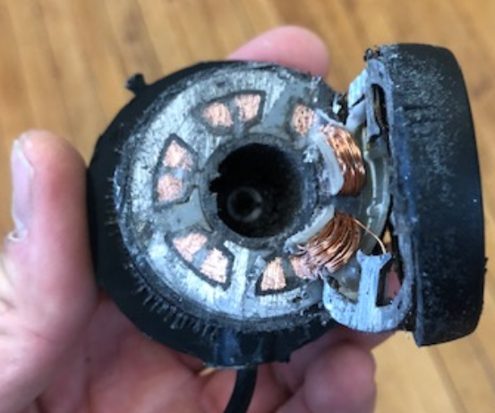

    My motor is not easy to turn by hand -- I used a drill on a moderately low speed and took measurements and did the math.
    Here is my motor spinning process
  • Here is a fresh set of readings.   All the motor variables can be seen here in the readout.     I have my fingers on the armature of the motor -- and there is just nothing there.

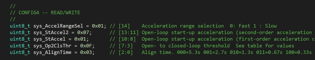

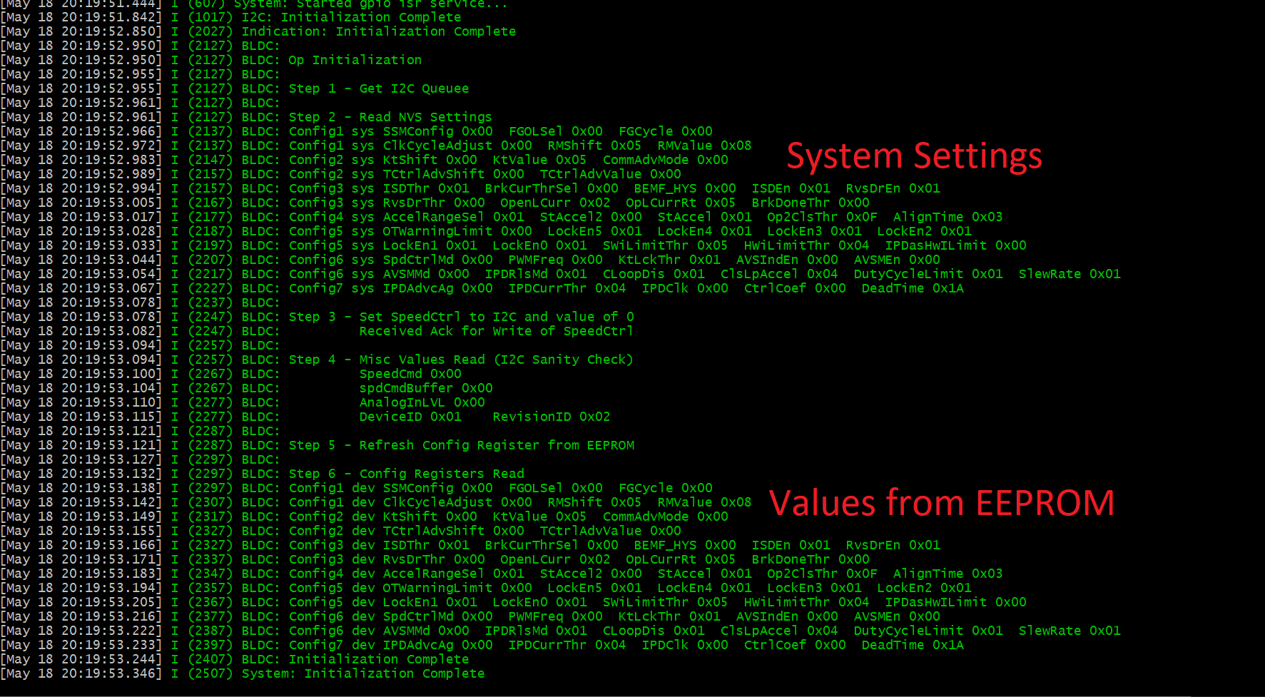

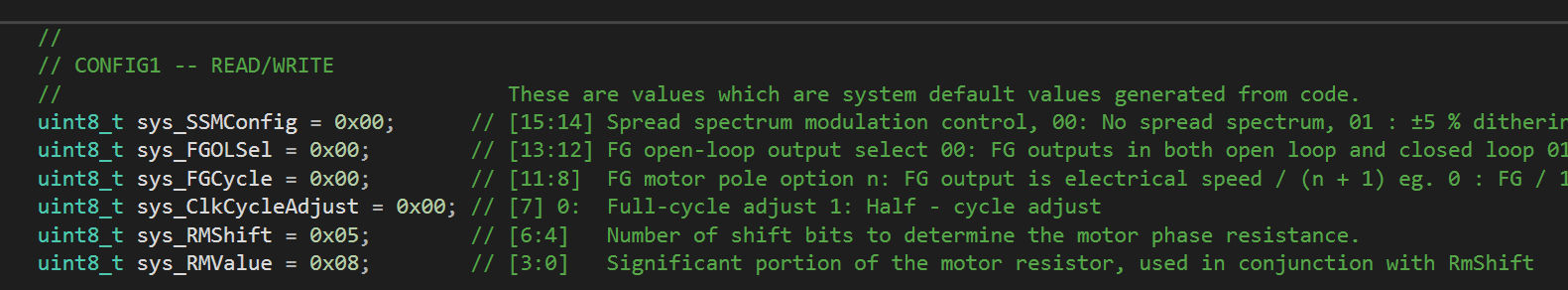

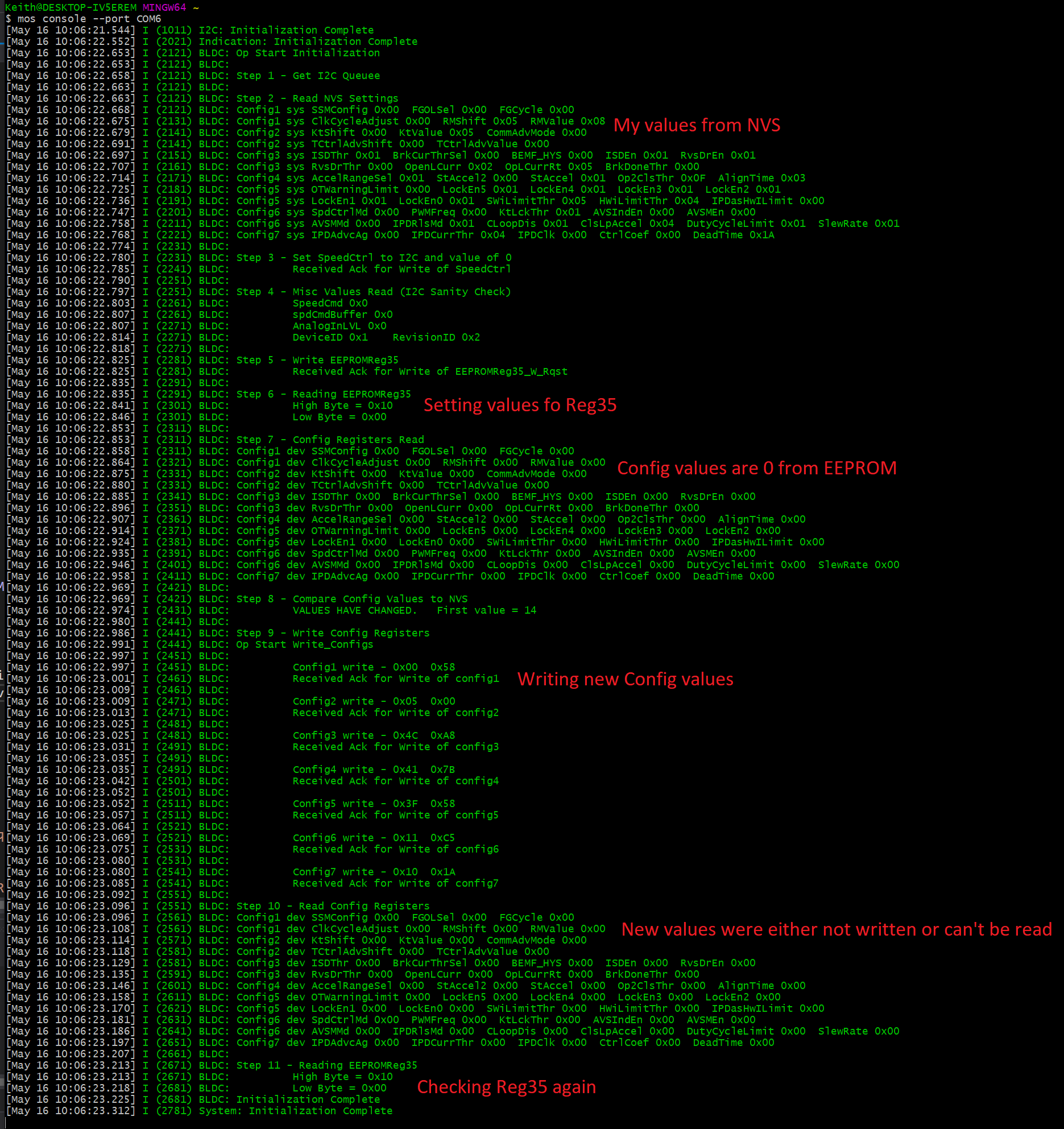

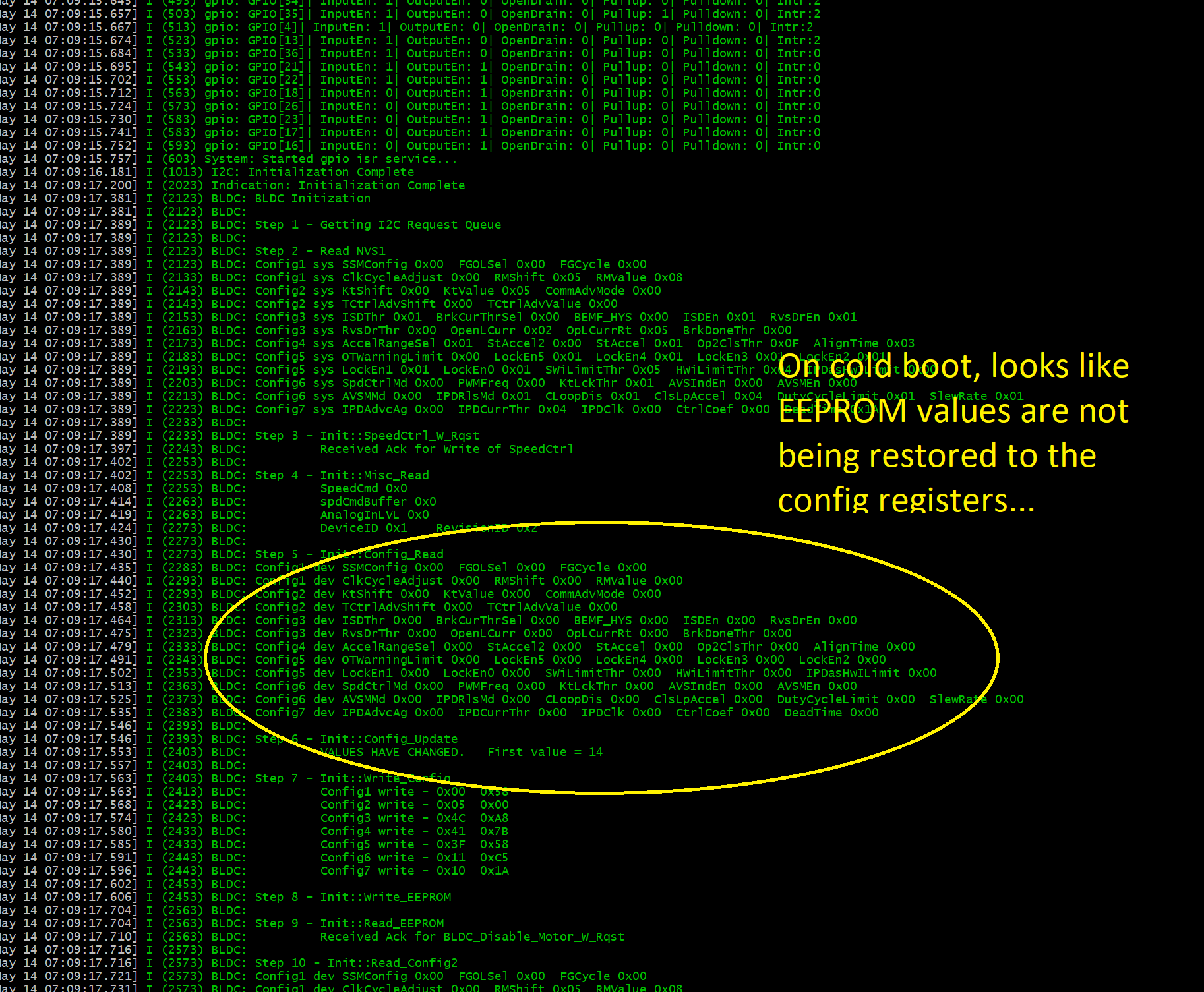

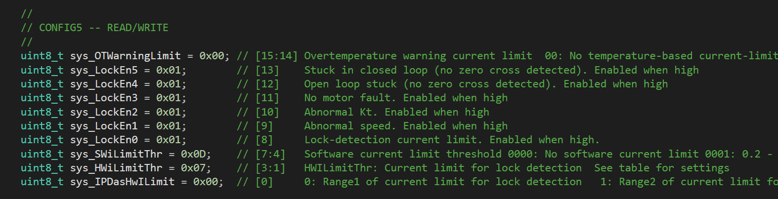

  • Looks like I may have another problem.... I don't see any of my values from EEPROM being restored to the shadow registers on cold boot.   The software sees the config registers in a default state.    Based on the docs -- I assume that EEPROM restores values upon startup.    So perhaps my problem is that I'm not getting the values stored property and in then they are not active in the system?    I am certain that I can read all the values from the Config registers.
    The documentation is very shallow on an explanation on the shadow registers -- and there may be confusion on what you mean by enabling them for use or not for use?   Perhaps I need to add a routine that prints out all those registers also -- and makes sure those bits are set correctly also.

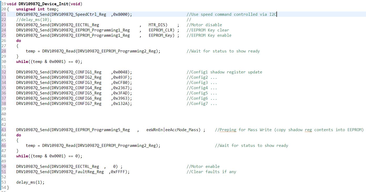

  • Here is my initialization process.   Is the EEPROM writing and reading done with the correct assumptions?    I'm not clear about how to work with the eeRefresh bit in Register 35.    Do I need to trigger the eeRefresh with that bit?   Or can an entirely new EEPROM read also update the config registers as well?
    // Initialization Path:
    // 1) Get a handle for I2C Request Queue (established ablity to send/receive through I2C)
    // 2) Restore system values from nvs (51 values for all config register values)
    // 3) Check the bounds on those values
    // 4) Set speed control to I2C and set speed to 0 (standby mode)
    // 5) Read and print Misc values (SpeedCmd, spdBuffCmd, AnalogLvl, Device ID, RevID)
    // 6) Read Config registers
    // If Config registers match restored system then exist init process.
    // Assuming values don't match
    // 7) Write Config registers with new system values
    // 8) Trigger an EEPROM write with mass access enabled
    // 9) Trigger an EEPROM read with mass access enabled
    // 10) Read Config registers again and compare to system values
  • Something is undisclosed about the process by which the EEPROM values populate the Config registers upon startup.
    I assumed that the Config registers are automatically refreshed when power is applied -- or did I miss something in the documents?
    Must we trigger a Config register update through the eeRefresh bit?  (1: Sync shadow registers with contents of EEPROM)
    If not -- under what specific conditions is the eeRefresh bit used?

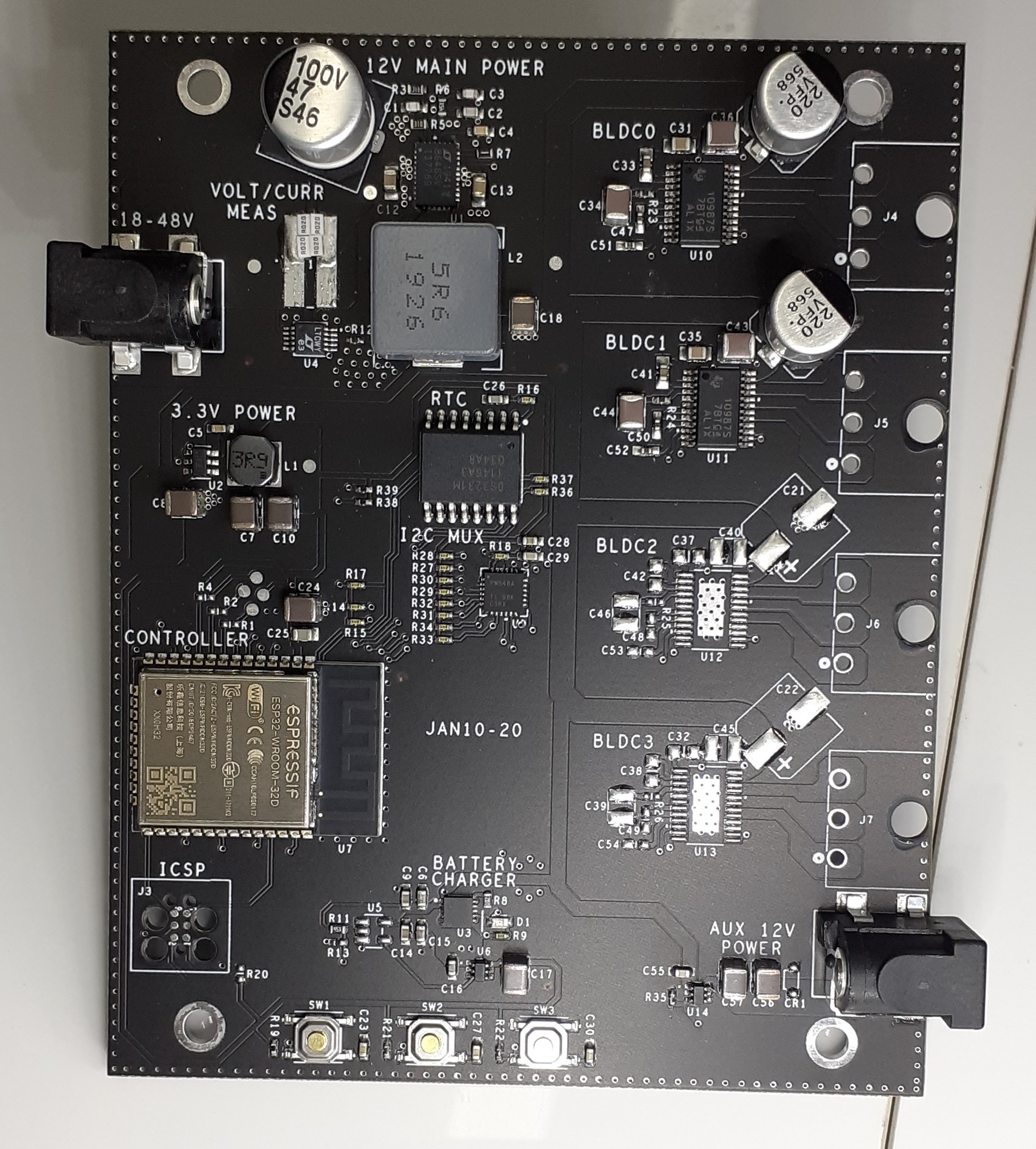

  • My external capacitor for 3.3V is kind of far from that pin.   I did not prioritize that distance from the pin.   The voltage there could be less than ideal.

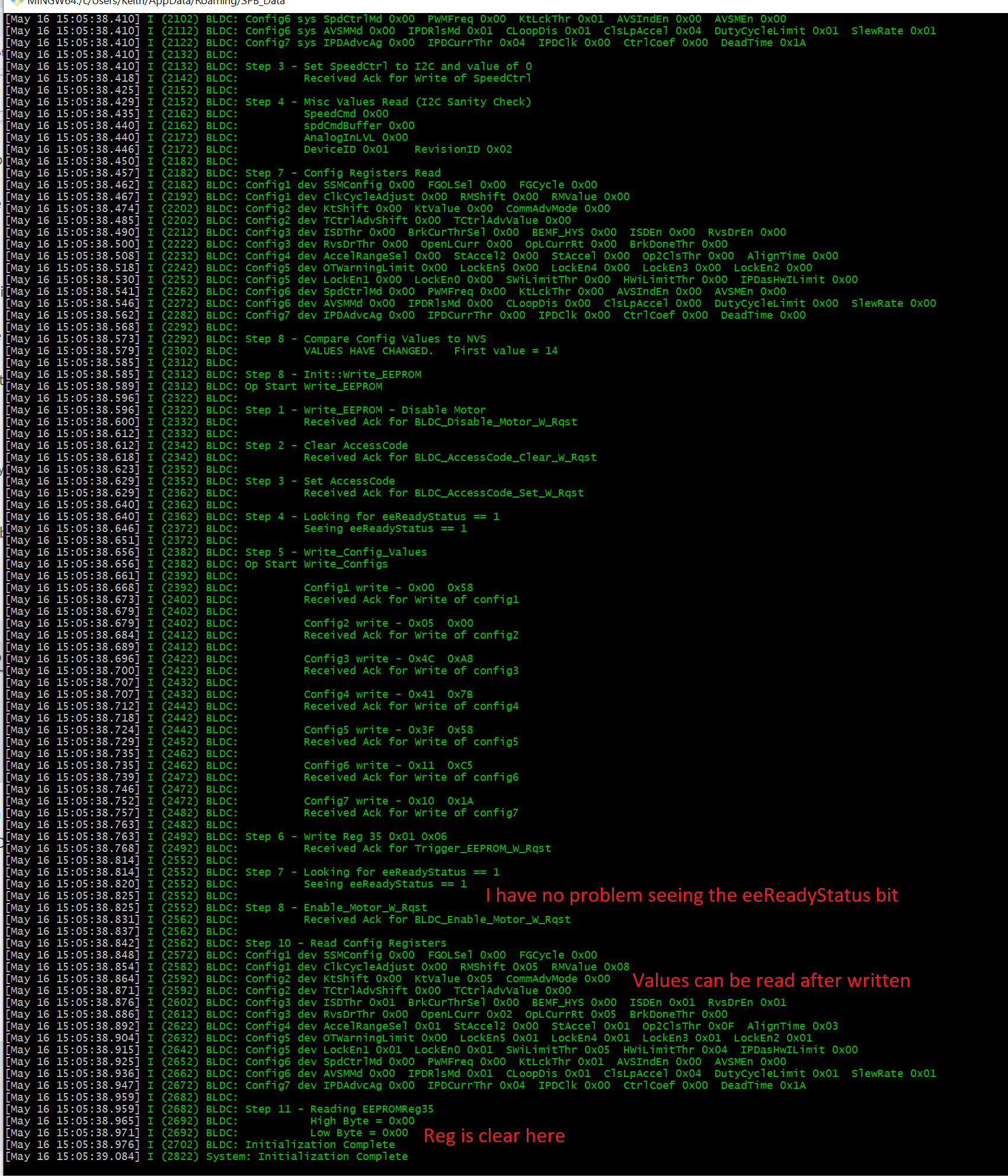

  • Of course...   I do look at the eeReadyStatus and it takes some time and it does read 1 before I continue... Sorry, I was thinking about the eeRefresh bit.

  • I will change the layout on and move the 1.8V and the 3.3V capacitor close to the pins.    That is an easy improvement.

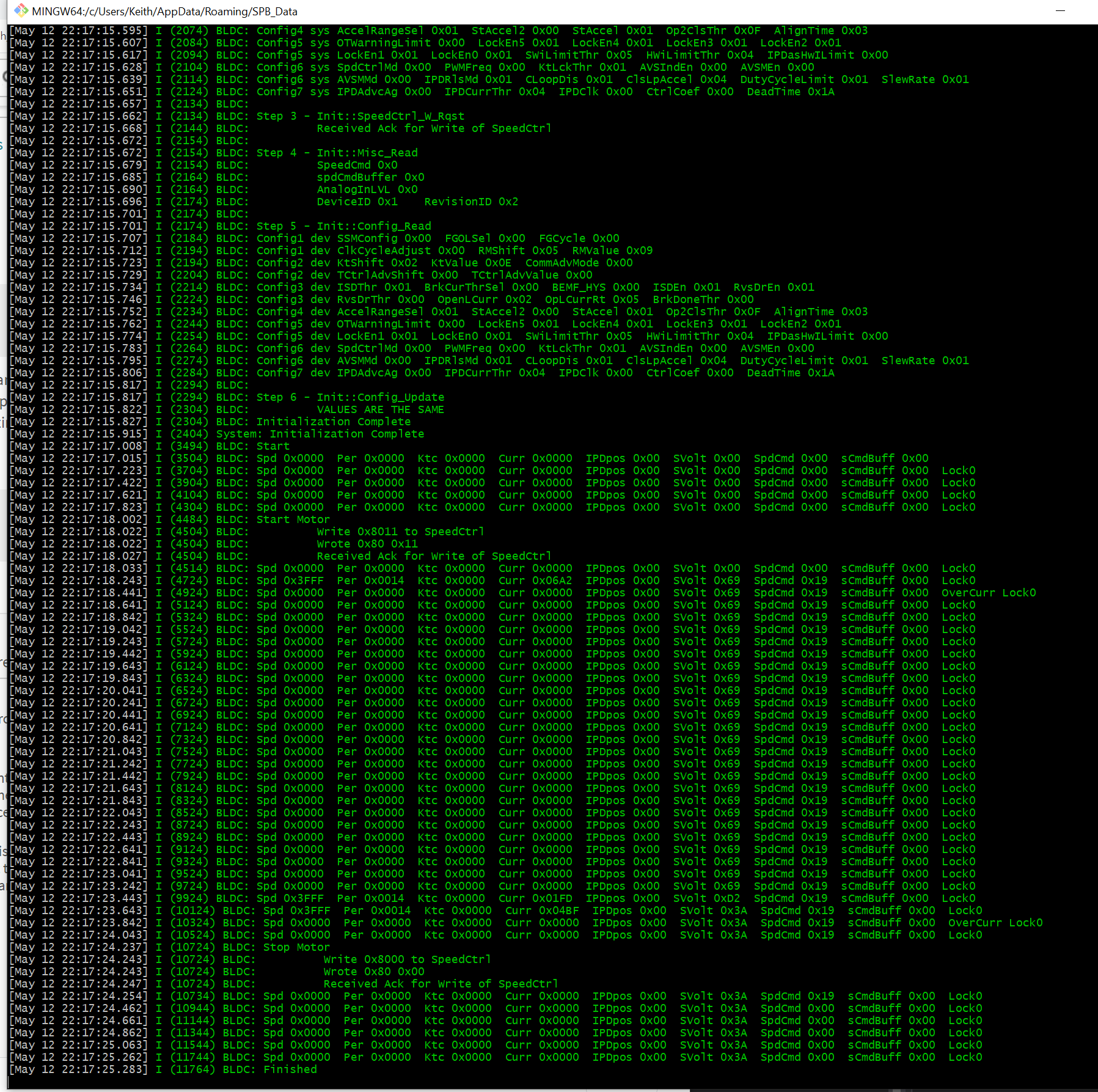

  • Writing the Config registers doesn't seem to work unless you go through an EEPROM write process.
    When I write directly to the Config registers and then immediately read them -- they all read zeros.
    But when I try to do a normal mass access EEPROM write process -- the Config registers are holding value -- and I can read those values.
    Even if I set or clear the ShadowRegEn at the beginning -- writing directly to the Config registers doesn't work.
    The EEPROM routine disables the motor and unlocks the EEPROM and everything else in that list.   Why would that process be successful for writing config register values but the direct write doesn't work?
    What am I missing here?

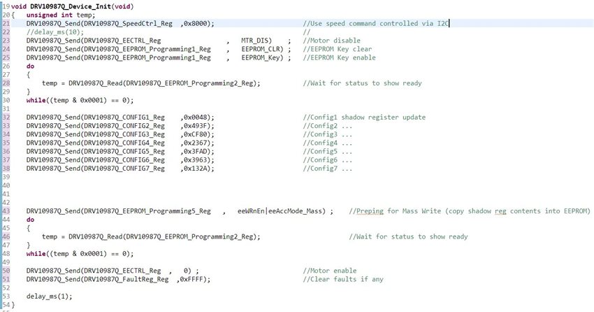

  • Have you personally written software for the DRV10987?    Have you personally been successful at writing values to the config registers directly?
    I strongly suspect that something has been omitted from the datasheet.    I believe your customers are leaning on the demo hardware units and the pre-packaged software tool that TI releases.

    Before we get into debug steps, I’m going to see if I can explain the intended experience little bit more clearly.
    Shadow Registers and EEPROM: Basic
    The DRV10987 motor drive algorithm uses the values in the CONFIG1 to CONFIG7 section of memory to modify the algorithm behavior. To expand, when a user sends an I2C command, the values are put into this space—which we call shadow registers labeled CONFIG1 to CONFIG7. From a “configure and tune the motor performance” stand point; this is all the customer needs to do: send I2C commands to the shadow register space.
    However, the shadow register space is volatile memory, so we lose the contents of the space when we power down. As a result, the user would have to send many I2C write commands every time the device powers up, which is not elegant.
    This is where EEPROM comes in. On power up, the device defaults to copying the EEPROM contents into this shadow register region. If we programmed EEPROM beforehand, there’s no initialization needed, the user can immediately start polling memory spaces outside of CONFIG1 to CONFIG7 to get some information on the status.
    Programming EEPROM should only be used when the user intends to change the default loaded values on power up. If we’re debugging or tuning, only programming into shadow registers should be sufficient.

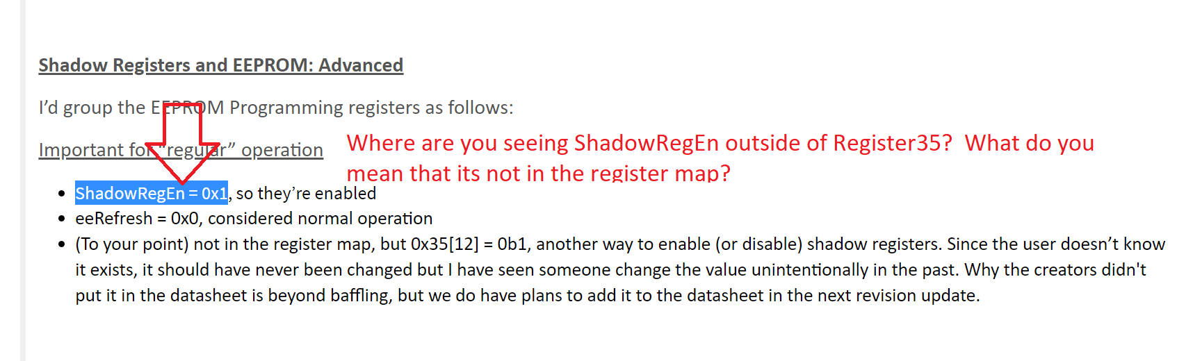

    I’d group the EEPROM Programming registers as follows:
    Important for “regular” operation
    • ShadowRegEn = 0x1, so they’re enabled
    • eeRefresh = 0x0, considered normal operation
    • (To your point) not in the register map, but 0x35[12] = 0b1, another way to enable (or disable) shadow registers. Since the user doesn’t know it exists, it should have never been changed but I have seen someone change the value unintentionally in the past. Why the creators didn't put it in the datasheet is beyond baffling, but we do have plans to add it to the datasheet in the next revision update.
    Important for programming EEPROM
    • ENPROGKEY = 0xCODE
    • ShadowRegEn = 0x0, so they’re disabled
    • eeReadyStatus = 0x1 for indications that no operations are occurring in relation to the EEPROM block
    • eeRefresh = Write 0b1 in this spot to simulate the process when EEPROM is copied to shadow register during power up. For whatever reason, this doesn’t reset to 0b0 once written to.
    • eeWRnEn = allows read or write of EEPROM
    • eeAccMode = 0b00 or 0b10. Pretty much only ever need mass access
    Not important for the basic use case or defined as advanced:
    • eeIndAddress
    • eeIndWData
    • eeIndRData
    • Other eeAccMode vaues
    I’m sure you’ll notice that the datasheet doesn’t explicitly teach any of this. It merely provides a list of steps to get the actions completed. Hopefully this explanation provides some more intuition for debugging the problem.

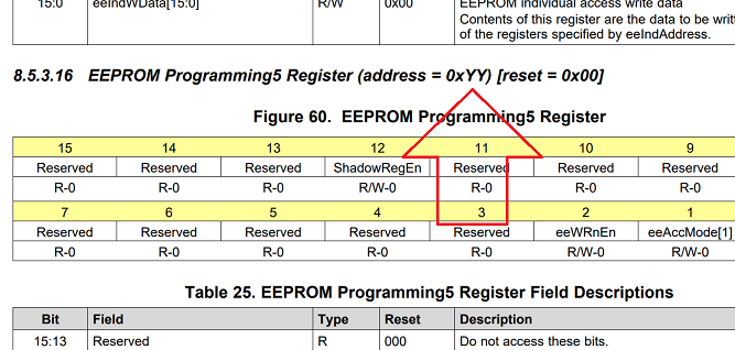

  • The datasheet can NOT have errors or vagueness in it if you are expecting customers to have success.
    You have expressed here some finer points about the ShadowRegEn and eeRefresh registers which were previously unclear to me.   I will add the changes to my routines here and see if this clears up my issues.
    I agree, no sense in talking about performance until we get past the basics.
    Please correct the doc -- The number 35 should be where YY is.    This is a typo that is disruptive when you're scanning through the tables looking for your target register number.

    2) Attempt a read and write of the Config registers...
  • Here is a full log of my attempt at writing/reading the config registers with ShadowRegEn = 0x1 and eeRefresh = 0x0.
    The write or the read failed.   I could have made a mistake but I don't see it....    Comments?
  • Previously -- I have seen the Config register hold values from an EEPROM write process which was flawed and never completely wrote to the EEPROM. (values were lost on cold boot)
    SO -- I suspect that writing to the Config registers is much more like an EEPROM process.
    It makes some sense that a motor possibly would not be able to update all its fundamental values without a very controlled shut down and restart...
    Here is what I suspect is going to work for writing to Config registers:
    1) Disable motor
    2) Write the EEPROM access code (may or may not be required)
    3) Wait for eeReadyStatus = Idle (may or may not be required)
    4) Write the Config registers
    5) Set Reg35    ShadowRegEn = 1 (allow remaining bits to stay 0)
    6) Wait for eeReadyStatus = Idle (may or may not be required -- but should work by default)
    7) Reset Reg35    ShadowRegEn = 0 (this is its default value on power-up)
    8) Enable motor
    Do you disagree with any of this?   Have you actually written the software yourself and can you give me the exact set of sequences that you know work?

  • I went back to my EEPROM write routine and added in the eeRefresh = Write 0b1 that you recommended.   I get the same results are before -- the values can be read in from the config registers -- but are lost when I cold boot the system again.
    Notice that the EEPROMReg35 is cleared after EEPROM write / Config Read processes.

  • Here is my update for today.
    My config registers were not getting updated automatically from EEPROM upon cold boot.  That is a fact.   I wrote a routine that stimulates the refresh that works consistently -- my Config values are updated upon every cold and warm boot.
    I also went through the trouble of testing out single config word writes/reads to/from EEPROM.   That works.   I can constantly write and read back values from each 16bit EEPROM word for configuration values.
    When I try to turn on the motor by giving it a speed command -- I still get nothing.
    So the next step here is the completely verify that I have all the normal open-loop variables set correctly.   I should be able to get this motor to spin in open-loop.

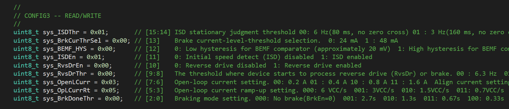

  • Here are all my system settings -- which are confirmed written into the device.
    Does anyone see anything obviously wrong here for just basic open-loop running?
  • This is how I invoke speed control on the motor and I monitor all the common values and faults.    I turn on the printing -- apply a simple speed value -- then turn off the speed value.  The motor does nothing -- no detectable movement.   No sound.... nothing.
    Where are experts?   We need the real engineers on this....

    ShadowRegEn = 0x1 and 0x35[12]:
    ShadowRegEn is 0x35[12], this was my mistake.

    Yes, I’ve programmed this before. To be fair, it’s been a year since I had to develop code, and it’s clear my recollections and guidance have not been effective.
    Here’s my code for initializing the device:
    Looks like I decided to program the EEPROM on every power up. Note, I only used EEPROM Programming 5 for EEPROM write access enable and mass access enable. I never had to write to ShadowRegEn. After this write, you would expect EEPROM Programming 5 to read 0x1006.
    For now, I suggest your sequence should ignore lines 43 through 48 (i.e. skip trying to copy shadow register contents into EEPROM) and do not include anything else, besides reading EEPROM Programming 5.

  • I have to stimulate the system with Reg5 for my Config registers to be populated with data from EEPROM.  There is no way around this with cold boot starts.  I just can't read any values in Config until I do something with Reg5.   So, I do an eeRefresh with a full process (disable motor, write the code, wait for ReadyStatus, write Reg5, wait for ReadyStatus, enable motor).
    Other singular actions in EEPROM with Reg5 also stimulate a full refresh of the Config registers.

    What are in the all secret register spaces?    Is it possible that I inadvertently wrote something in there which has impacted my system?   Or does all those spaces refresh to default states on a cold boot?

  • Please understand - I felt that I could not incrementally verify a mass EEPROM write and the shadow register update all in one operation.    So, I wrote one EEPROM memory location -- and read one EEPROM memory location for verification.   In the process of the write and read, I saw that the shadow registers were updating -- which would be expected action.
    When I do nothing to EEPROM directly upon cold boot --- the shadow registers are not updated.   This is why I do the eeRefresh process.
    Your project always writes EEPROM in every cold or warm boot -- so I suspect this condition of empty Config registers would not have been observed in your test project.

  • I went back to the code and applied all the default values which are specified in
    Table 9. Default EEPROM Values
    but allowed for variations that applied to my motor and system.
    Still no results -- and the ADC values on the SystemVoltage are still all over the place...

    NOTE:  When I unplugged the motor and got the exact same results....    This motor has been tested on another power system and I know it works (24V 1/2Amp of power while running)....So what are you thinking??   Poor PCB layout?
    Clearly -- when we have an ADC problem -- we're not going to get the expected outcome....
    I'm thinking that I need to layout the board one more time (for capacitor layout changes) -- and then order one of your hardware kits where I can spin my target motor apart from my design work.
  • One more possibility -- I have a resistor in the 5V circuit which creates a linear supply.   It calls for 39 ohms.  I only had a 50 ohm part here.   Is that enough variance to throw off the circuit?
    I just discovered another possible problem.. .you call for a resistor with a 1/4 watt rating.. .I'm short of that rating.   My part is smaller and is only 1/5 of a watt.
    Is the part sourcing current over that path?      That could be my problem there -- I need at least an 0603 and to be safe and an 0805 part in there...
    Between the higher resistance and the undersized part -- that is probably my ADC problem.
