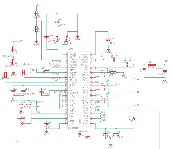

DRV8302: DRV8302 Fault goes low because of gate to source resistor of low side Mosfet
Part Number: DRV8302

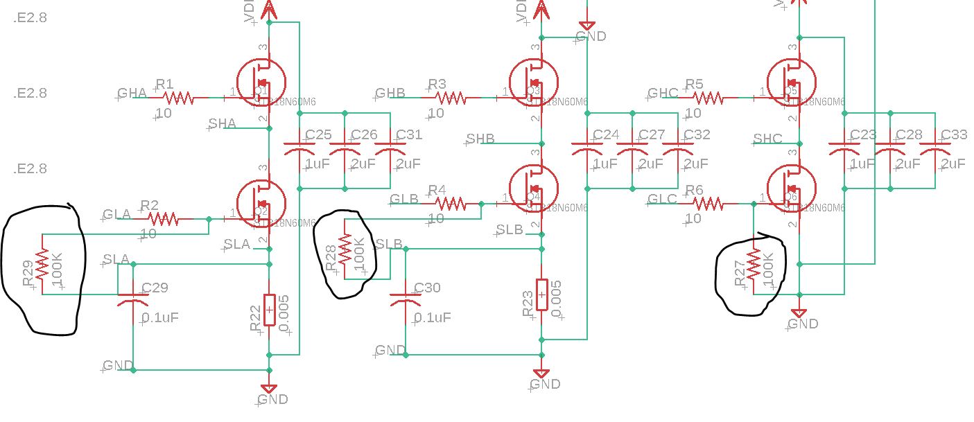

I am trying to build a board to drive a BLDC motor but i got issues when i connect resistor from gate to source of the low side mosfet ( for protection), the Fault pin goes low (without toggling) also the GVDD, AVDD and DVDD has the right voltage when i enable the DRV but the fault pin stays low.
when i remove those resistor the board works fine .
note: i got this issue only when i connect the motor
this is the schematic of the Half bridge
https://ibb.co/hgchMD2
What's the problem? do i need to change the Values of those resistors, because i want to protect my mosfets so the gate find a way to discharge when the DRV is off
