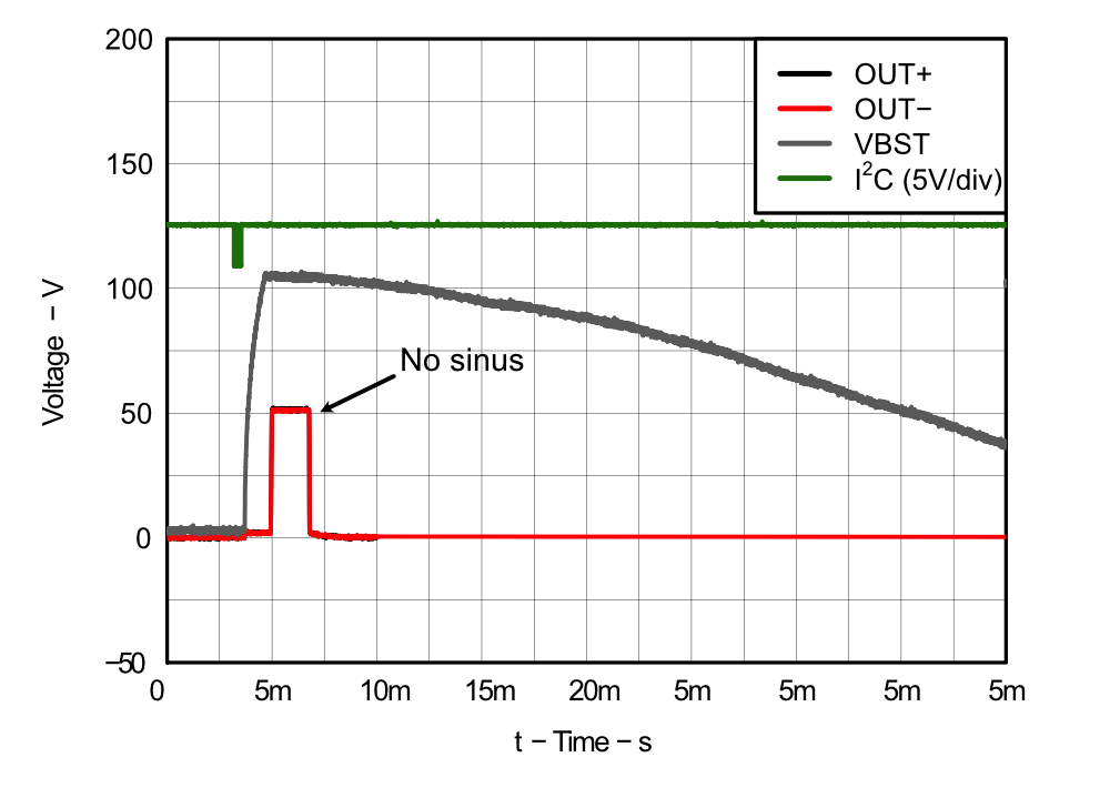

While making a board with this Piezo driver I encountered a weird issue.
After sending the first example (in the drv2667 documentation)
no difference on OUT+ and OUT- is measurable.
What's strange is, that the boost converter is generating 105V
and 50V is present on both OUT+ and OUT- for about 1ms. But no signal is generated
The measured output on OUT+, OUT- and BST/PVDD looks like this: (compare with Figure 51)

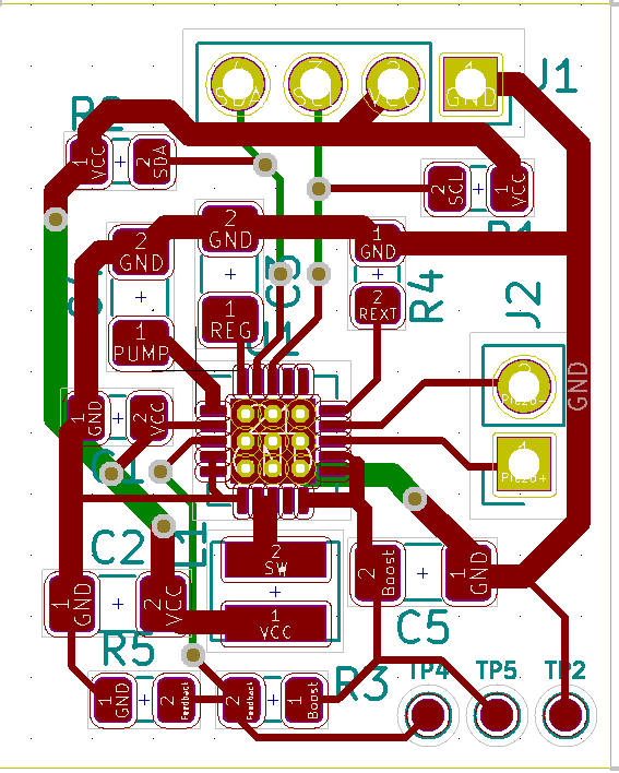

I have attached my Schematic, PCB and programm below.
