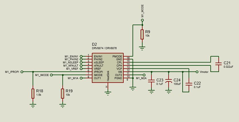

Hello i am using a DRV8876 to control a brushed DC motor. I am having problems wherein upon during resetting or the pins are not initialized of the micro- controller the motor will spin in the forward direction. I thought this should not be able to happen since on the datasheet it is specifically said that digitals pins of the DRV8876 are internally pulled down. In my pcb there two set of the schematic below.
All digital pins are connected to a microcontroller exept for Vref wherein it is connected to a digital potentiometer

    Logic level is 3.3volts, Motor voltage is 6.04volts. Judging from that table it does makes sense why its turning forward. Which shouldn't be the case
  • Hi Drake,
    Thank you for the DMM readings. These help.
    Why are nSLEEP, EN/IN1, and PH/IN2 in the 1.6V to 1.7V range when the device is in reset?
    At 1.7V, the device can be awake and in PH/EN mode. This could cause the motor to spin.
    When the mcu is reset, do the GPIOs have an internal pullup enabled?
    Adding a external 10k pulldown to GND on the nSLEEP pin should keep the device in sleep mode until the mcu is initialized.
    Please let us know the reason for the midrail voltage on the inputs when the mcu is reset.

  • Hi Drake,
    On page 9 of the datasheet, there is a description of the PIO reset:
    Schmitt Trigger(3)
    Reset State:
    - PIO Input
    - Internal pull-up enabled
    Also, on page 28 there is a statement: Typical pull-up value is 100 kΩ for all I/Os
    This is consistent with what you are seeing. The nSLEEP typical pulldown is 100k.
    It is expected that placing the external pulldown resistor will cause the DRV8876 to enter sleep.
    Good luck.
