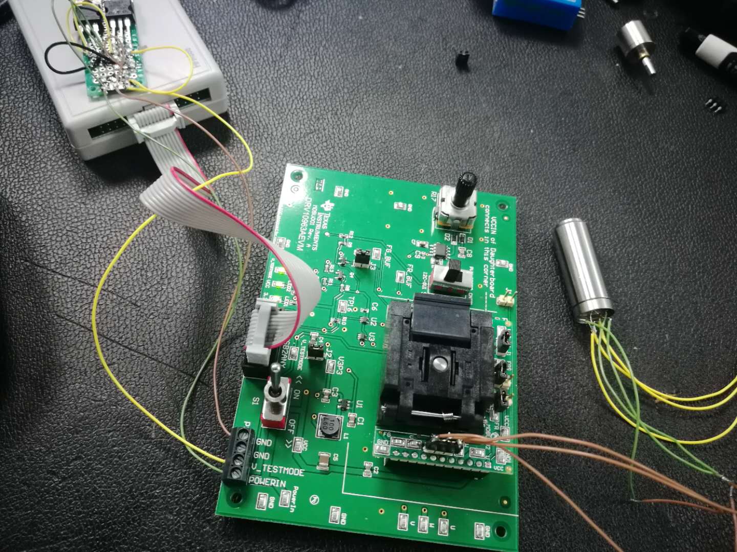

The customer is developing an integrated brushless motor. He used DRV10963AEVM to drive, and the motor started intermittently.
He measured with an LRC bridge:
  • Brushless motor phase resistance is 6.2 ohms
  • Phase-to-phase inductance is around 86
No matter how the software is adjusted, the brushless motor still cannot run normally. Would you kindly help to check the reason?

  • Hi Annie,
    Thanks for posting your question in MD forum.Its a little tough understand what the problem might exactly be without more info. Is the 60 uH phase to phase or phase to center tap? What is the BEMF constant Kt of the motor? Was the customer able to communicate to the EVM using the GUI? Can you share the OTP settings of the device?  Also can the customer provide a scope plot of the voltage and current of the 3 phases when they start the motor?
    Vishnu
  • Glad to receive your answer, the first coil is interphase inductor 82UH, the second coil is Y type connection center inductor 60uh. Gui-evm communication seems to often go wrong.EVM power is now 6.7V and 5.0V, and each time you press Configure Parameters, an error will appear.Please guide me where I went wrong?How do I do guI-EVM communication?
    Looks like there is an issue while writing values to the register. I would highly recommend checking the step by step process documented in the DRV10963EVM User Guide. The EVM should be in test mode (5V supply ON and Jumper J1 shorted on motherboard) when you write values to the shadow register. Please refer ti Chapter 5.5 in the User guide for more information.
    Vishnu.

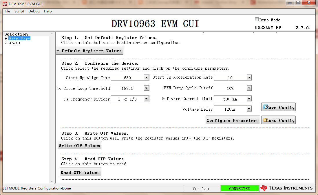

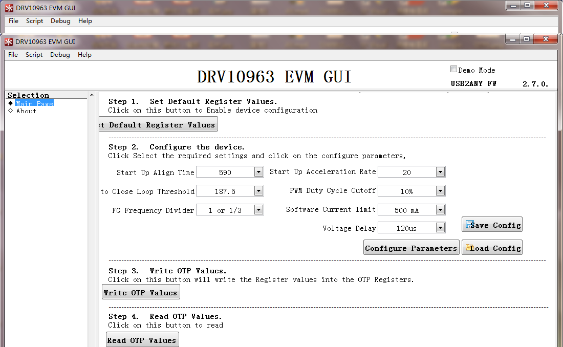

  • Hi Vishnu, I have made further tests through debugging.At present, the motor can work for 30 seconds before it stops. I have created a new motor coil to increase the inductance. I am trying to change the current to make DRV10963 reduce the heat.Please direct the motor to stop for 30 seconds. Is there still a problem with chip heating protection or OTP setting?
  • Was Mr. Vishnu's GUI configuration test run correctly with 15-30 seconds of downtime?Or is my setup still a problem?

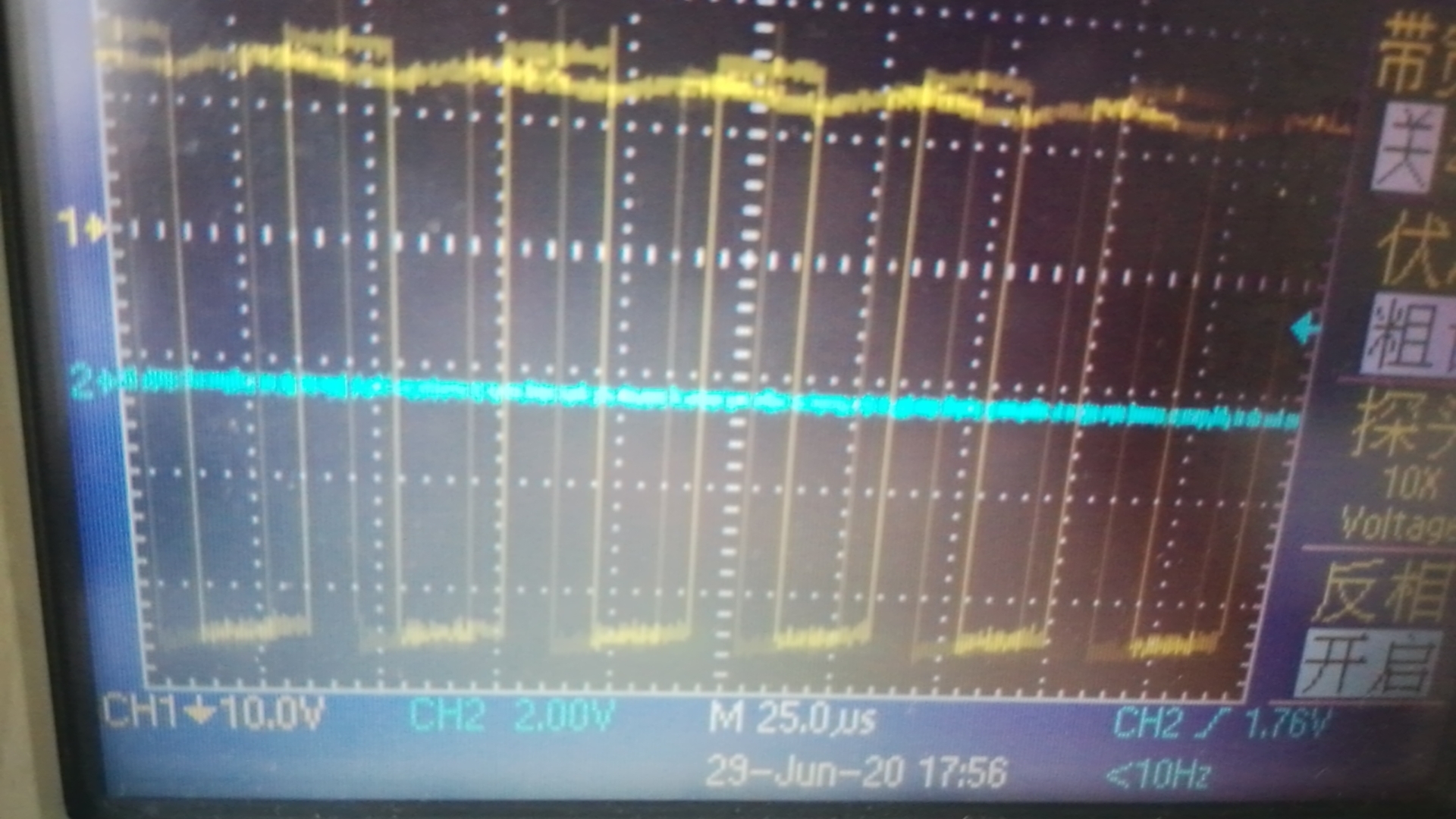

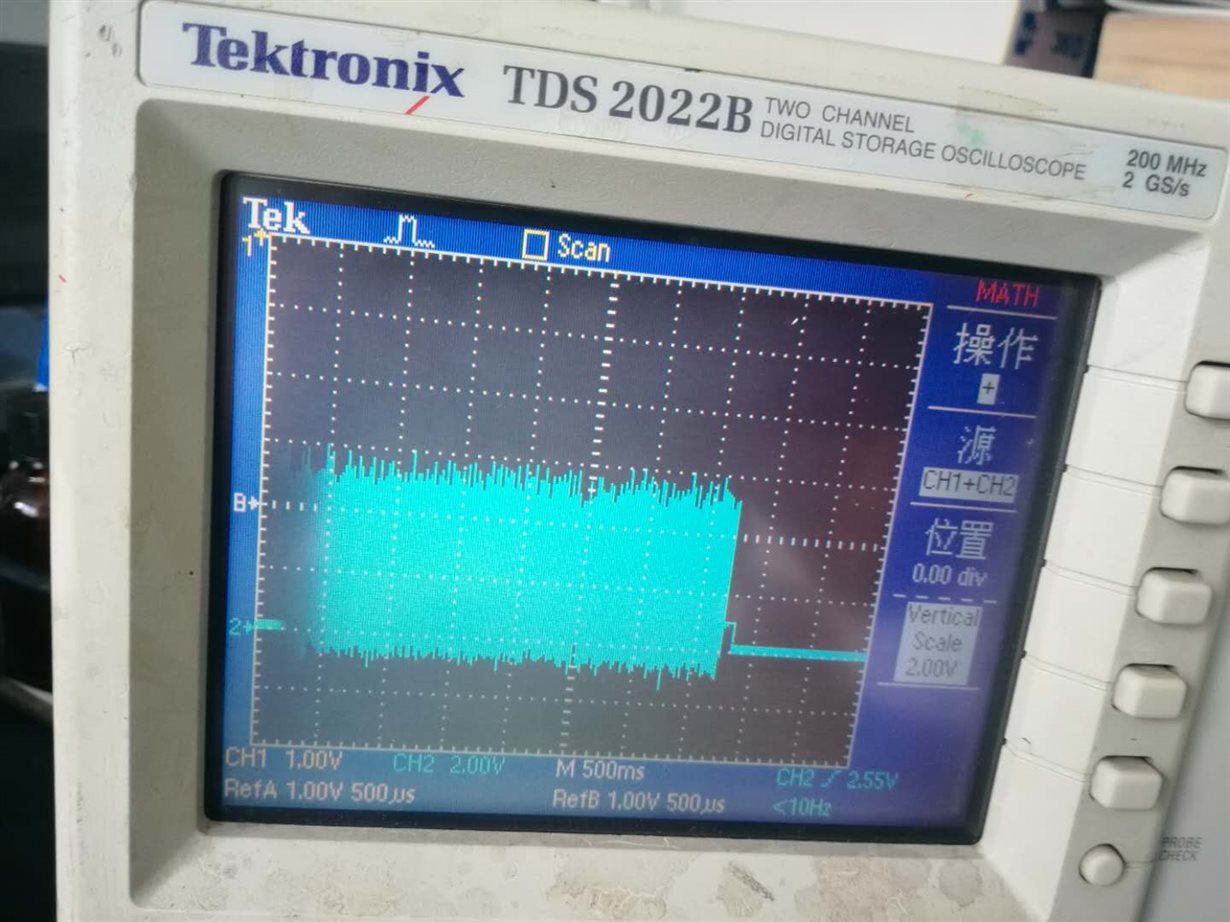

    • Unable to find the positive porch wave. What's the reason?
    I'm not sure what these waveform represent. Can you share the phase current waveform of the motor?

    The waveform that you shared looks like the Icc (supply current). Since your motor is restarting after 30 sec, this gives an indication that there is a startup issue. Can you share the OTP settings and the phase current waveform?
    Vishnu

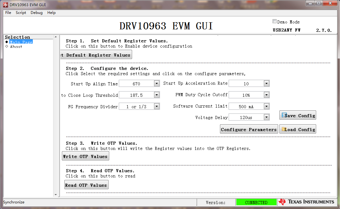

  • OTP1 set the motor to run for 30 seconds, stop and restart.OTP2 set the motor to run for 20 seconds, stop and restart.OTP3 Set motor restart for 10 seconds.Wish you good health and happy every day.
    Can you please try increasing the Software current limit and the Startup acceleration rate?
    Vishnu
    • How does the software increase current? How to increase the acceleration rate?  Have a good day at work.
  • . I have conducted a variety of experiments. The current working current of the motor is 100MA-110ma.I adjusted the software current to 875mA, but the motor still could not work normally.I remove the motor from the normal drive motor and it will work smoothly.The continuous operation of 12V was up to 19800RPM, but I could not find any problem with the motor. The best Japanese material of 0.1 thickness was used for the silicon steel sheet, and the magnet was also the best.Is it because of the high motor power that DRV10963EVM cannot bear the load?Or running a program incorrectly.I see that the DRV10963 data shows a supported frequency of 1300HZ.I calculate that the current speed of the motor is 8000RPM.So we're just working at 133HZ.No positive wave voltage to motor input is seen.Again, please help guide...I wish you good health and peace
  • You mentioned the maximum speed is 133 Hz but you have set the open to closed loop threshold frequency to 187.5 Hz. Can you decrease the open to closed loop threshold frequency to 25 Hz or 37.5 Hz?

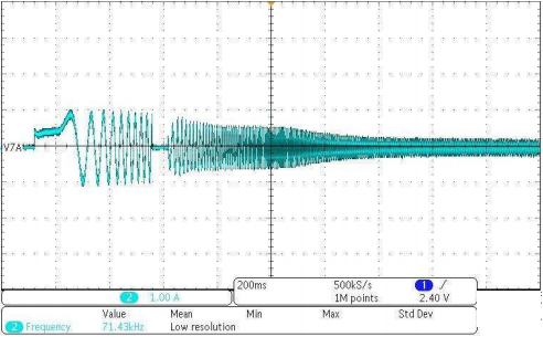

    I don't think this is a thermal issue. Can you share the motor phase current waveform along with the RMS current value? I'm looking for a plot that looks something like the one shown  below. As recommended in my previous posts, did you try decreasing the open to closed loop threshold frequency? When open to closed loop threshold is set above the max electrical frequency of the motor, then the device will stay in open loop and the motor will draw more current.
    Vishnu

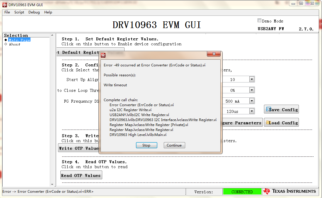

  • HI, I handed the DRV10963 project to my friend in Shanghai. What is the reason for his frequent errors in using GUI setting DRV10963 in installation?
  • I'm not sure what "frequent errors" you are mentioning here? Can you provide more details about the frequent error you are talking about?

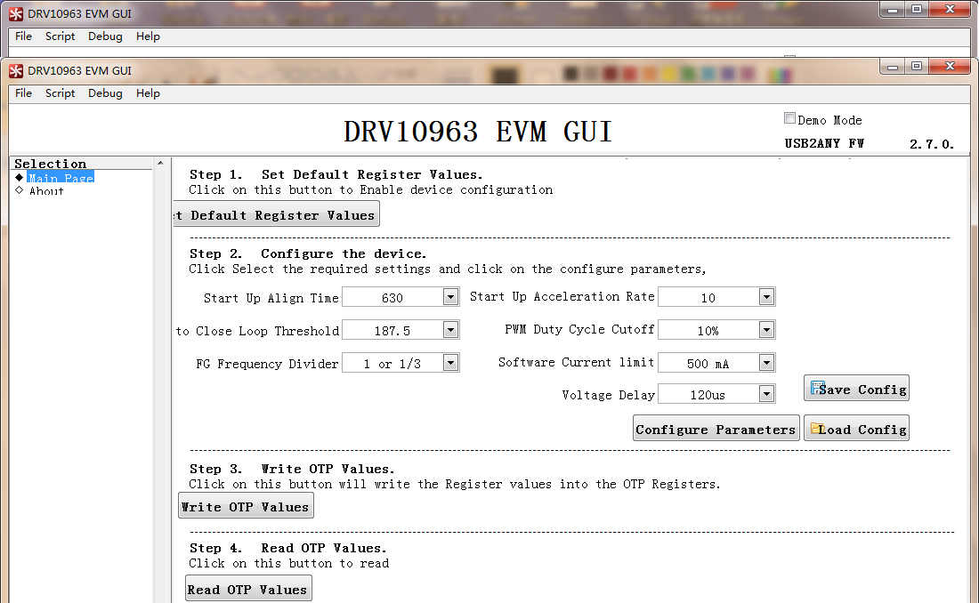

  • Hello, i did more test w/ the DRV10963 and I'd like to ask your help to share when the DRV10963 will stop driving motor and spin the motor again in few seconds
    Here is what i did
    1) Use GUI to load the default config and set the Open to close Loop Threshold to 50
    2) Open J1, then the motor will start working. DRV10963 did spin the motor.
    3) however, the motor will stop in couple of seconds (depending on the setting of the Start Up Align Time & Start Up Acceleration Rate).
    Could you pls help share some idea why the motor will stop then re-spin the motor? Thanks!
  • Hi!
    The device is triggering some fault and stopping the motor. After lock time, the device tries to restart the motor. This is a tuning issue. Can you share the current waveform of  one of the motor phases? I would highly recommend you to look into section 6 in the EVM Tuning guide for detailed information on tuning the device parameters.
    Vishnu.

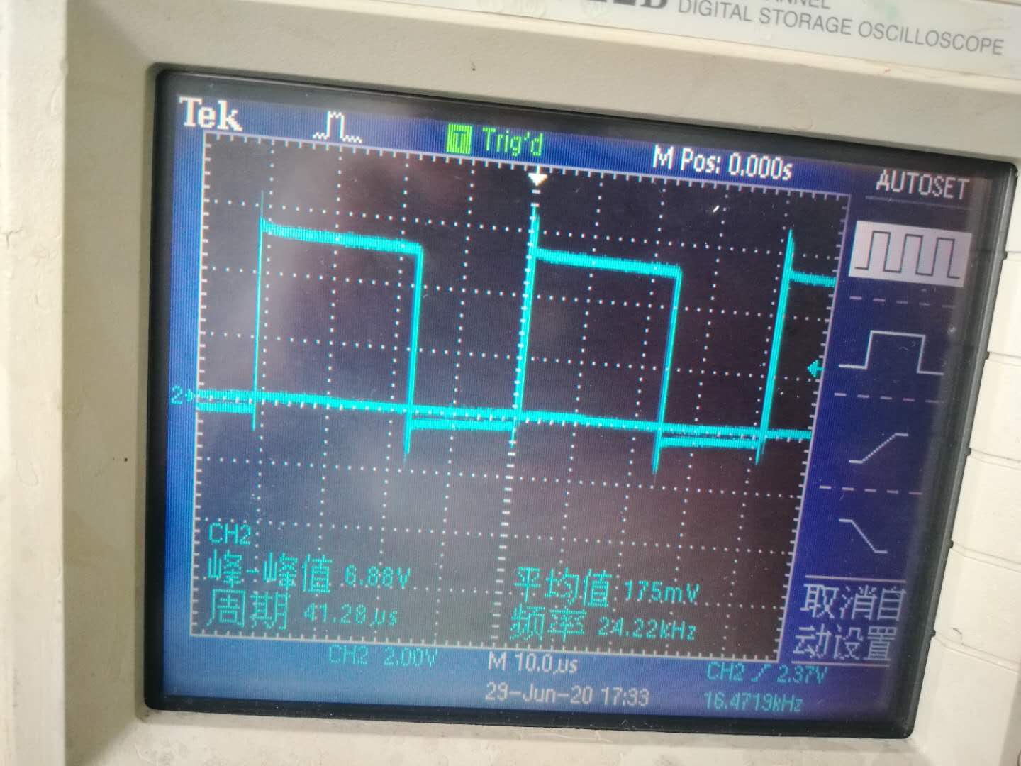

    I'm not sure which 50 kHz square wave signal you are referring to. DRV10963EVM has a 555 timer to generate PWM pulses by comparing the saw tooth wave signal with the analog (pot) signal. This is required to control the speed of the motor. DRV10963 operates at max 5.5V and can provide Continuous winding current of 500 mA so it cannot drive a 4W motor. Please check DRV10983 and DRV10987 to meet your motor specification.

  • 谢谢您的答复,我昨天做了一个实验,电机轴扭死案例DRV10963仍然驱动电机,能感觉到电机的振动,我按照6.16 PWM50KHZ的指导进行了实验,同时我们可以控制电动机的启动和关闭,但电动机仍然不可持续,并在调试模式下运行时,如果我认为感应电动势中没有问题,这是我第一次制造电动机。DRV10963是否要求电机绕组按180度分布?目前,电机是用空心杯缠绕的,或者由于DRV10963的高功率而根本无法驱动。不能在DRV10963上运行。我将使用DRV10987。983驱动22MM医用电机。我会尽快进行实验。DRV10963无法调试,原因未找到。请给予更多指导。
  • Hi!
    I don't understand what you mean by twisting the motor. 50 kHz PWM frequency is the driver switching frequency and not to be confused with 25 kHz PWM input frequency which is used to set the speed command in PWM mode. Sorry we cannot comment on motor design as we are not the experts. I still believe we cannot drive a 4W motor using DRV10963. What is the rated current of the motor?
