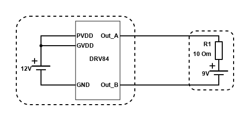

Hi
We plan to use DRV8412 in electronic kit for kids. Kids will have access to out pins of DRV8412. So we need to protect it against:
  1. ESD
  2. Short circuit. This will happen often.
  3. Connecting of an external power supply (9V battery). So even if all pins are pulled to ground where will be a constant current ~1A
PVDD is 12V. Common load is >3 Om. Will it be enough if we put such protection:

  • May be my question was unclear, sorry for that.
    Scheme looks like this:
    R1 is internal resistance of the battery.
    I guess there will be continuous current ~1A on reverse diodes in DRV8412 and nothing can stop it.
  • Ok, I thought your input was also that 9V battery. Since the 9V battery and 12V input share the same ground. And, the short current goes through same FETs as DRV8412's "the output short to power and ground protection".
    I would think DRV8412's output short to power and ground protection will work. We just need to add a series inductance. "For short protection, a ferrite bead or inductor is recommended to use the short-circuit protection feature. A ferrite bead designed for very high frequency is NOT recommended. A minimum impedance of 10 Ω or higher is recommended at 10MHz or lower frequency to effectively limit the current rising rate during short circuit condition."
