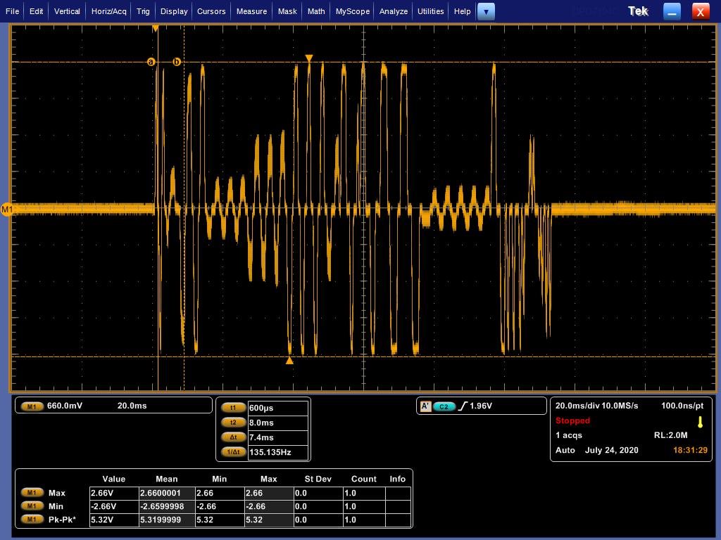

  • Hi Carson:
    After exchange to another PCB, the waveform become stable
    So I test three PCB, one waveform is stable, one is a little unstable, and one is huge unstable
    I attached huge unstable PCB measured waveforms as below (waveform is strong click 100%)
    We check the REG pin voltage is normal 1.8V
    Any other thing that we can check?
    Thank you~~

  • Hey Poki,
    I would suggest trying to change LRAs and see if the same results occur and then maybe change the board you are driving the LRA with if possible.
    Just try to test different combos of the driving DRV and the LRA themselves to see if these results persist.
    Otherwise maybe run the auto-calibration every time before testing to see if that makes a difference or run the diagnostics routine to see if it yields failed results
    Also try to run a waveform in open loop to see if the output result is more consistent, the resulting waveform will not look great but it will allow you to see if it can stay consistent and determine if the closed loop resonant tracking is the cause of these distortions.
    Carson

  • Hey Poki
    It is not normal for the really unstable waveforms to happen as long as the LRA set-up is consistent. Some instability could be expected base on the stability of the LRA environment
    Also to be clear, is it a new DRV chip for every new PCB? If it is a different chip every time then the really unstable graphs may be caused by a faulty chip
    Using our DRV-ACC16 EVM to measure an acceleration waveform of the LRA viibration might be useful for this situation of testing to get consistent results. It could help you see how much this waveform instability effects the LRA acceleration stability and help you guage what a consistent haptic effect looks like.
    Best, an
    Carson
