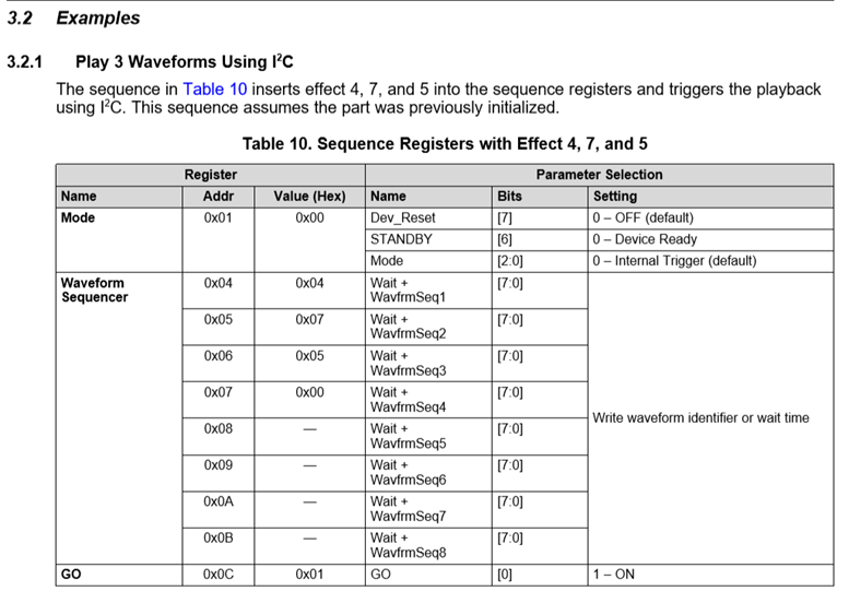

We follow the below examples, but we want to extend the waveform time duration 3s. May I know how to do that?
We had tried the ODT, SPT, SNT and LRA and extend the reg timing, but fail. Our reg setting in below.
write_data(0x01, 0x00);
write_data(0x04, 0x04);
write_data(0x05, 0x07);
write_data(0x06, 0x05);
write_data(0x07, 0x00);
write_data(0x0D, 0xFF);
write_data(0x0E, 0xFF);
write_data(0x0F, 0xFF);
write_data(0x22, 0xFF);
write_data(0x0C, 0x01);

  • Hey Gary,
    Each effect has a preprogrammed time in the ROM library, when you tried adjusting the ODT, SPT, SNT registers did the timing not change or could you just not get it to what you wanted?
    Those registers are the only straight forward option to accomplish what you are doing on this chip. Otherwise I would recommend using the DRV2604 which has user programmable RAM for completely customizable waveforms or use the new DRV2624/25 models that are similar to the DRV2605 but have effect looping options that could make your timing work.
