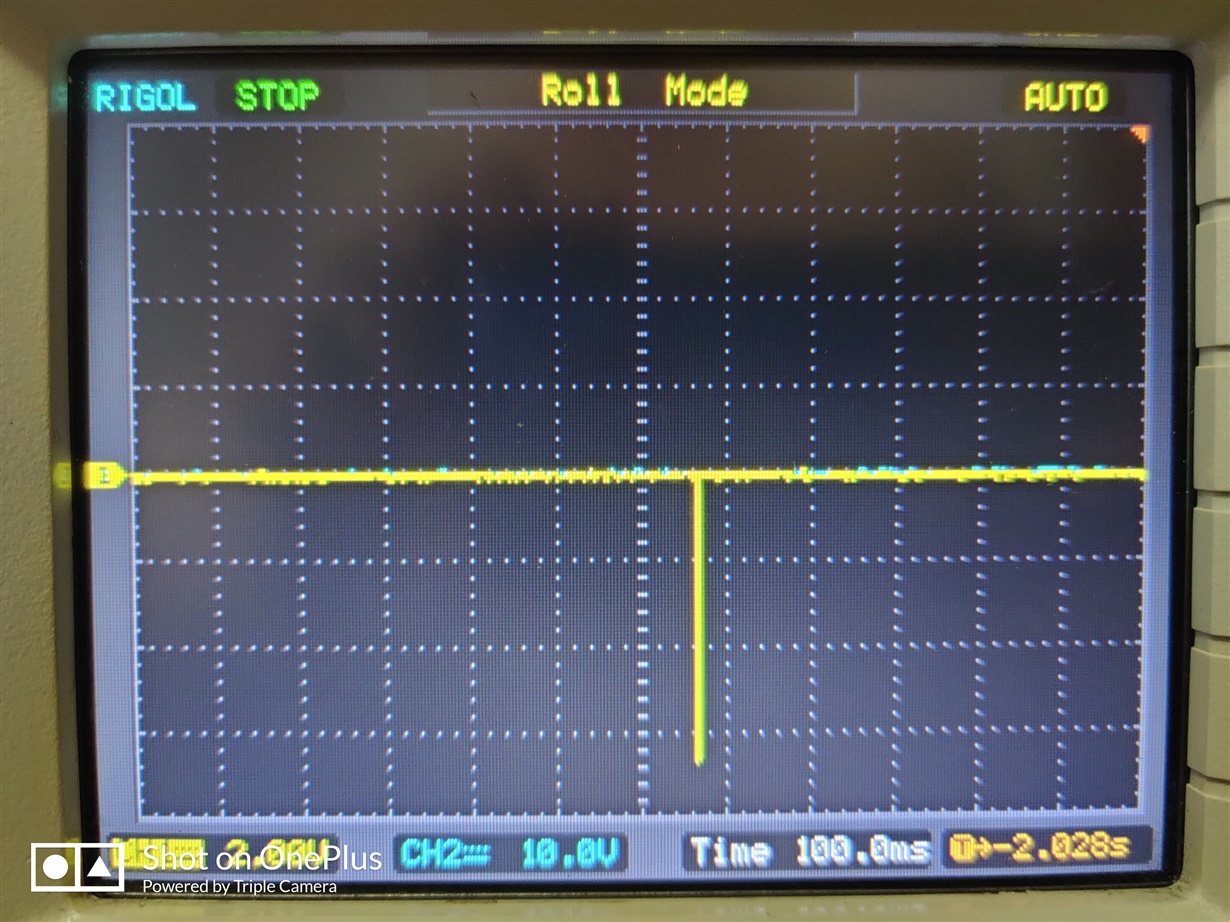

    Thank you very much for your patient reply. I did the test that you said( case 1, Idrive=25/50mA). I got a couple of waveforms As follows,
    Can you find any problems through these waveforms?  I thought it triggered the PDF through the waveform. The nFAULT trigger period is 3ms.
    Looking forward to your reply again.
    Kun Li
  • Hi Kun,
    Thank you for the information,
    Looking at the first scope shots, the outputs are re-enabled after every 3ms (t_retry) and quickly disabled since the OCP fault is still present which is normal behaviour.
    As for the second scope shot, the nFAULT signal is not correct. I think you mistook it for the SH signal. How did you measure VDS? did you use a differential probe or another technique?
    Your results show the OCP functioning properly at least for the this test case where Idrive=25mA/50mA and high side OCP monitoring is disabled. This might not be the case for when you set Idrive=150/300mA and enable high side OCP monitoring.

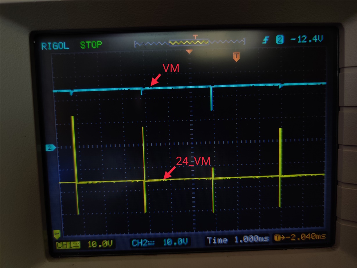

    If you look at your schematic, you have a diode (D7) between 24V and VM (pin 1) of the driver. This causes the voltage measured at the VM pin of the driver to be less than the voltage measured at the dain of the HS FET (24V_VM). The driver monitors for OCP fault by measuring the VDS of the external FETs. In the case of HS FET, the VDS measured by the driver is the voltage between VM (voltage of pin1 of the device) and SH (OUTx). However, that is not the true VDS value of the HS FET. The true value will be the difference between 24V_VM and SH. This means that the driver is measuring a VDS value which is lower than the actual VDS value of the HS FET. In a case where the difference between VM and 24V_VM is large, this can cause the OCP to not trigger despite the actual current through the FET being larger than the threshold specified in the datasheet. We can confirm if this by measuring the voltage at VM (pin 1) of the driver and the voltage at the drain of the High-side FET (24V_VM). Can you provide these measurements?

    I didn't use a differential probe to measure VDS. I used an oscilloscope to connect MOSFET drain and source poles respectively.  This test method is problematic. However I don't have differential probe.
    But I found some problems testing VM(pin 1) and 24V_VM. Here is the waveform I measured. I don't know what caused the 24V_VM waveform badly. And you can see a spike voltage signal of 3ms cycles, and I think that's why the OCP is triggered. And what is the best way to eliminate these undesired signal? Besides, I wonder if you will trigger OCP during short circuit test.

    The spikes shown in the 24V_VM are most likely produced by the rapid enabling and disabling of the FETs every time T_retry and T_deglitch expires. Since VM(pin 1) and 24V_VM are not tightly coupled together (there is diode D7 and Fuse F3 in between), the two signals are not the same. It is possible in a case where the 24V_VM signal drops far below the VM (pin 1) value, that OCP is not triggered since the driver measures a VDS value that is "lower" than the trip threshold despite the actual current being above the I_OCP threshold. If the actual current is high enough and persist for long enough, it can cause damage to the IC.
    Looking at your board, you could increase the copper area around the driver ICs to improve thermal performance but this will only help in lowering the temperature of the IC. If the OCP issue you are seeing still persists, the IC will continue to be damaged.
    What we ideally want is a direct connection between VM (pin 1) and 24V_Vm to maximize the coupling between the two nodes. This will ensure that the two voltage are close in value and that no incorrect OCP trigger occurs. Try to retake VM and 24V_Vm, as you previously did, but remove diode D7 and Fuse F3. Connect a wire (make sure it is a low impedance wire) between the empty pads to have a more direct connection. I suspect you will see that VM and 24V_VM will be very similar after making the direct connection.

    I tested it the way you said. I removed diode D7 and Fuse F3, connect a wire between the VM (pin 1) and 24V_VM pads. As you said, I saw that VM and 24V_VM are very similar after making the direct connection. Then I set the IDRIVE=100/200mA(OCP open) , and did a short circuit test. The IC didn't damage.  When I set the IDRIVE=150/300mA(OCP open), the IC will damage. When I look at the waveform, I think it's because the gate of the MOSFET does n' t have a gate resistance, which causes the MOSFET to turn on faster and the SH waveform to oscillate more seriously, which can trigger OCP by mistake, and the higher peak voltage of the SH will also damage the IC.
    But there's still a problem. At first, I'm using the diode D7 for reverse protection. But now if I add a diode D7, it still trigger OCP by mistake.
    Lastly, I'd like to confirm the status of the SNSOUT and nFAULT of the chip when you do the short circuit test.
    Anyway, thank you very much for helping me find out the root cause of the problem.
