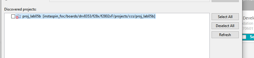

We have been driving our motor with the DR8353RS-EVM evaluation kit, and it is time for us to bolt on our own hardware.  I do not see where, exactly, the source code is for the TMS320F28027 part for CCSxx.  I am using CCS10, and I have downloaded Motorware, C2000Ware, 8353 EVM Firmware.zip, and cannot locate a CCS10 project to get me started with the exact code that is in the EVM.

  • I think that this is the correct one, but CCS10 will not allow this to be imported...
  • Picture did not show up, here it is again...
  • You might refer to the link below to get the examples and add then to motorWare for DRV8353.
    https://e2e.ti.com/support/microcontrollers/c2000/f/171/p/921751/3430457#3430457
    And then refer to InstaSPIN lab guide at (\ti\motorware\motorware_1_01_00_18\docs\labs) in motorWare to import the lab project to CCS.

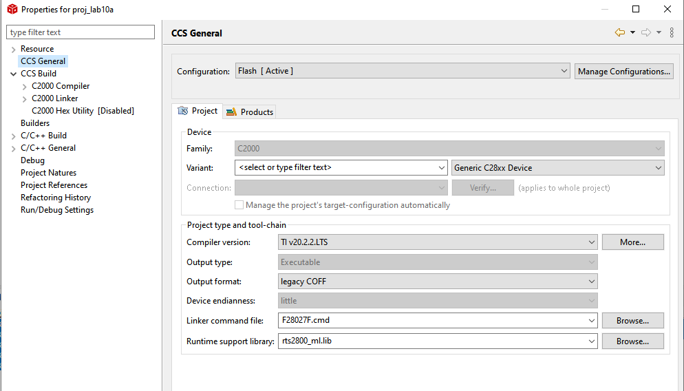

  • Sorry to send another post, but I only get you to answer once a day, and I need to move faster than this if we can.  I simply imported lab10a, built it without touching anything, and it built.  The device is not selected in the build settings, a Generic C28xx Device is selectted...but then I cannot program the C2000 Launchpad with this code...  If I select the proper CPU, then it also does not build.
    Here is the error set when I try to download to the LaunchPad...
    I am not a new user to CCS, just the Piccolo and the motor controller stuff.  I do know how to get around, obviously however not on this project!
  • The .cmd file you used is not right, and the project should have had the target configuration file already, you don't need to change anything to run the lab02b/02c, lab05b and lab10a with CCS for DRV8353_EVM.
    Please get the updated file for DRV8353_EVM that also includes the correct .cmd file.
    Extract the compressed file and copy the folders instead of the original folders in "sw" in motorWare.

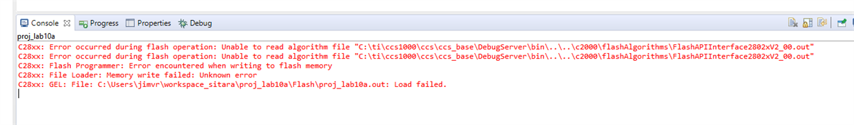

  • Thank you for the reply on getting, for example, Lab10a.  I have done that, and did it again just now, and I did not change the processor target, and I compiled no problem.
    I connect the LauchPad, it enumerates correctly, I try to run a debug session, here is what I get:
    C28xx: Error occurred during flash operation: Unable to read algorithm file "C:\ti\ccs1000\ccs\ccs_base\DebugServer\bin\..\..\c2000\flashAlgorithms\FlashAPIInterface2802xV2_00.out"
    C28xx: Flash Programmer: Error encountered when writing to flash memory
    C28xx: File Loader: Memory write failed: Unknown error
    C28xx: GEL: File: C:\Users\jimvr\workspace_sitara\proj_lab10a\Flash\proj_lab10a.out: Load failed.

  • I guess you should re-install or update the CCS for supporting C2000 device.
    CCS: https://www.ti.com/tool/CCSTUDIO
    And you could find the InstaSPIN lab guide at the folder below in motorWare, please follow the guide to run the lab02b and lab05b or lab10 for identifying and spinning the motor.
    Sorry, the GUI for DRV8353 is not designed for InstaSPIN-FOC, we recommended you use CCS directly if you want to implement InstaSPIN-FOC on this kit or your own board.
